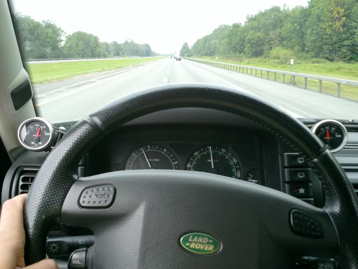

I have attached a picture of my dash driving between Syracuse and Utica, someone took it for me. Notice the good oil pressure and temp after driving 70 on an 85 degree day, for 45 minutes.

Good oil pressure. Here is pix of one owner with the 180F stat swap. Be sure to get real Rover, not Motorad stat.
