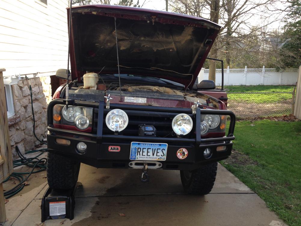

I have had an on and off waterfall sound for a wee bit now. After 20 years as a LR tech then I have ALWAYSD followed the LR of bleeding the system.
A fellow tech suggested I bleed it a different way.
Raise the passenger side up high, I used a ramp
take the expansion tank and raise it up, i used the batter cover and supported it on there
with the motor cold fill the expansion tank until colant comes from the bleeder, keep puring it into the expansion tank and let the collant come from the bleeder for 60 seconds. close the bleeder
HERE IS WHERE IT GOT INTERESTING.....
Turn the truck on and turn the heat onto max heat and max speed
now rev the truck to 3500 rpm for 10 minutes. YES I KNOW IT SOUNDS WRONG BUT DO IT.
NO CAP ON THE RESIVOUR... ALSO SOUNDS WRONG AND AGAINST EVERYTHING I HAVE BEEN TAUGHT
after 10 minutes let the truck idle and then switch off.
place the cap on and return the expansion tank to it normal position, carefull as you will get over flow.
After i did this I have NO waterfall noises and lower temps.
I HASTEN to add that this goes against every thing i have been taught and goes against what LR says you should but I have seen this done to a 2002 and it worked the same as my 2003!
