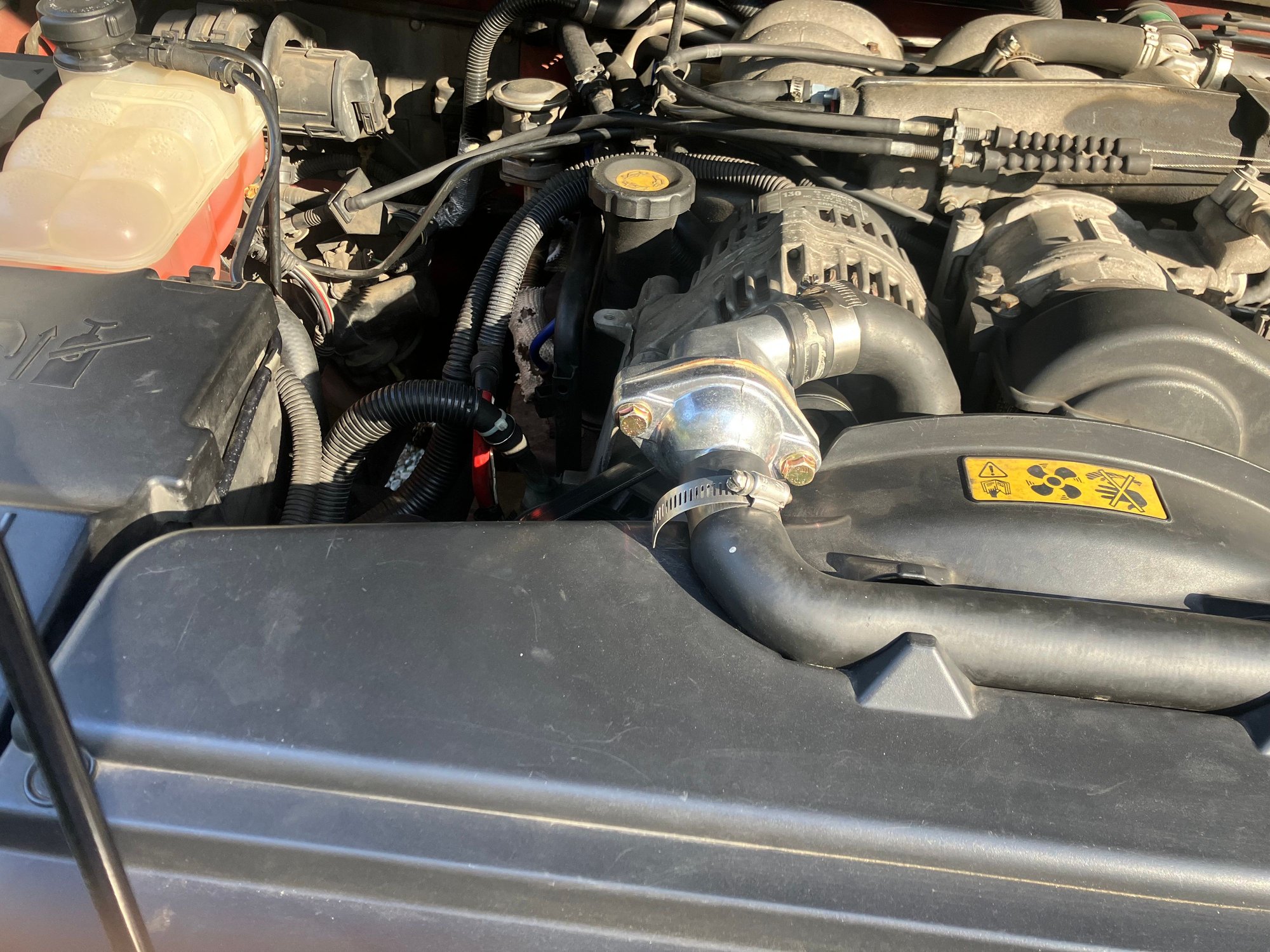

Old Apr 4, 2024 | 07:58 PM
SouthByWest's Avatar
Joined: Jun 2019
Posts: 73
Likes: 7
Finally got this done. New radiator, new inline thermostat, new coolant reservoir, new bottom hose, new clamps. So far, the thermostat reading has been solid at 180 Fahrenheit. The test will be this summer, running the A/C when the heat index is over 100 almost every day.
Old Apr 5, 2024 | 11:27 AM
gecko951's Avatar
Joined: Mar 2016
Posts: 335
Likes: 192
From: US West
Good job, your D2 will be alot more reliable after overhauling the cooling system! One follow-up item...see that hard plastic line coming off the coolant bottle and going to the radiator? They last ~2yrs before becoming brittle/leaking so I would suggest buying ~6ft of 5/16 transmission cooler hose and replace the hard line at your next service interval.
Yup. Its predecessor’s life ended a few months ago, so that one is relatively new.
