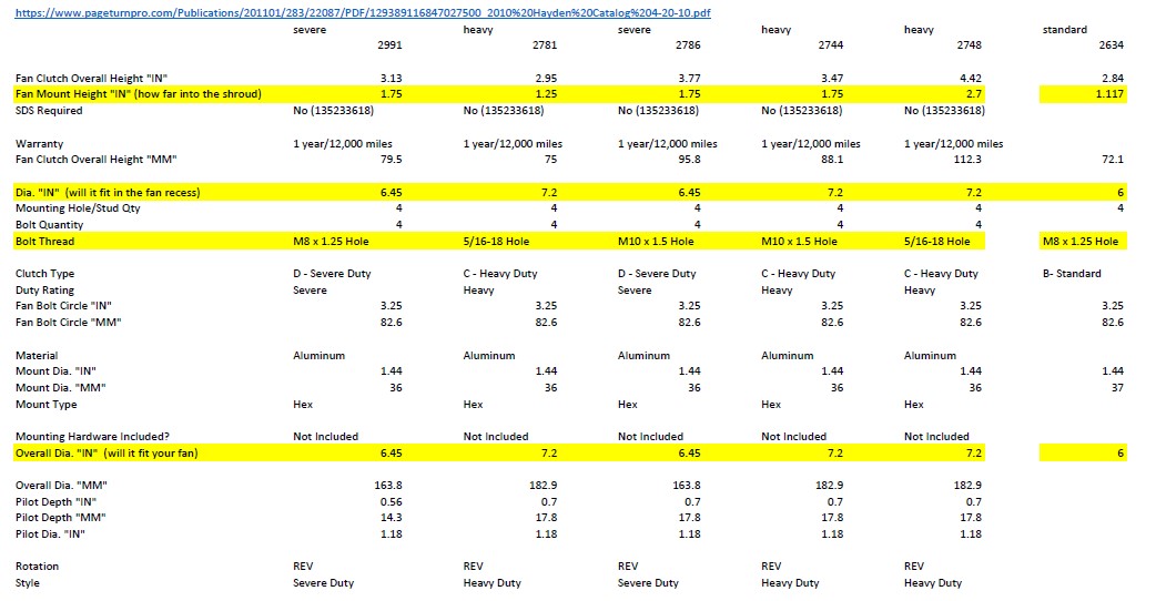

I also read that there is a heavy duty Hayden clutch that isn't as intense as the Severe Duty. I don't do a lot of offroading and I've never rock climbed. Maybe I should consider going with a Heavy Duty or a Severe. But then I would need to know if it will bolt up to my OEM fan or not.

check it out
Attached Thumbnails Coolant temps behaving differently-hayden-fan-clutch-cmoparison.jpg

https://www.haydenauto.com/en/produc...-types/thermal
This page shows the speed % specifications for hayden fan clutches during Engaged (hot) and Disengaged (cool) operation. Includes some info about fan pitch. I found it educational.

I think I would more than okay settling for a heavy or standard duty clutch. What I would like to know is are there known replacement fans that mate to those that are compatible with the fan shroud and clutches?

My original land rover fan had 1 1/2 inch pitch, so pairs well with standard duty clutch. Hayden says the heavy and severe duty clutches pair well with 2 1/2 inch pitch fans. Pitch is the horizontal dimension from front edge of the fan to the trailing edge. 1 1/2 inch pitch will be quieter than 2 1/2, but move less air. Note the LR fans have blades that are not spaced evenly, that also helps reduce fan noise. I am not sure of aftermarket fan options to fit.

The Ford Explorer fan fits, I have a couple with it. Do a search and you will find the pn. Also loud as hell because it uses uniform spacing instead of the staggered oem spacing.
