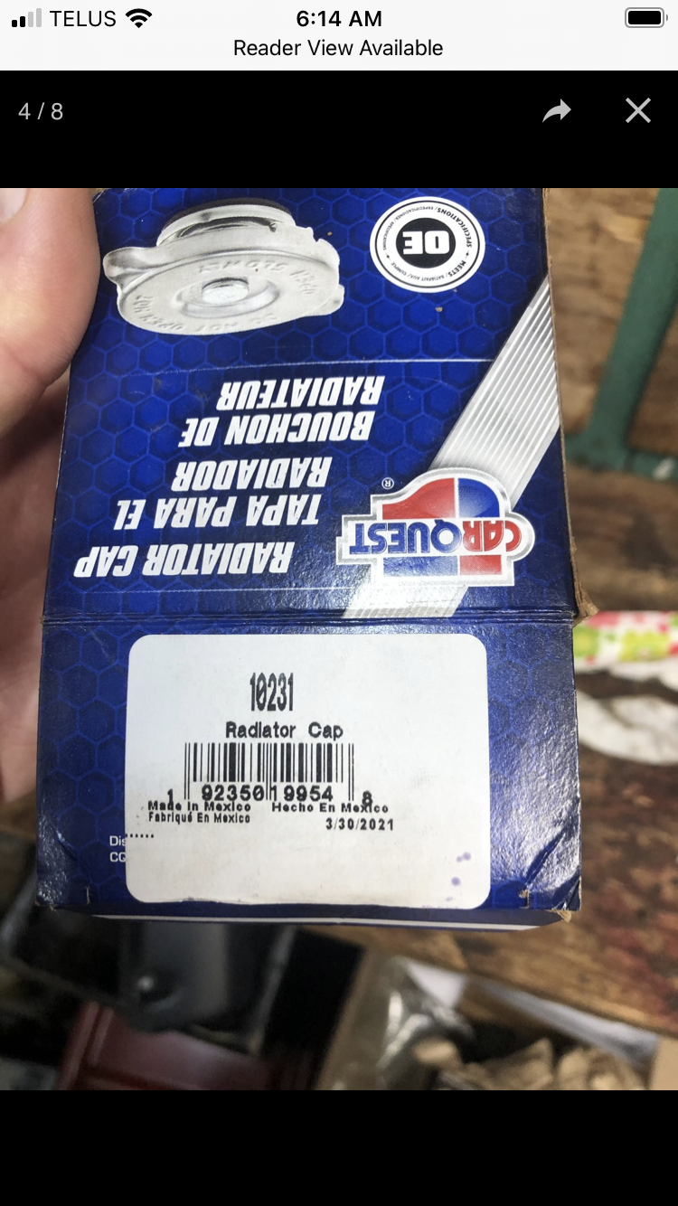

I just did the same thing. I have the same tank. That 20 psi imo is to high. My tank would stay full I switched to the motor rad 16 psi and now the tank runs about half way. Less pressure the better for me
