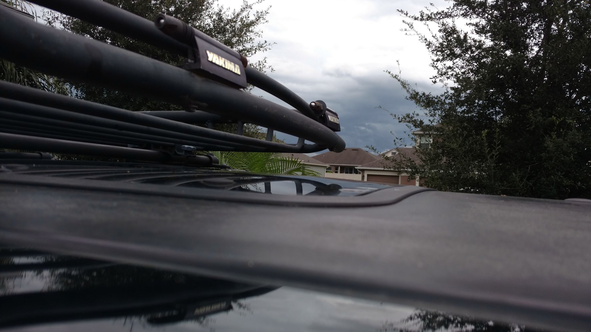

Is this the correct fully closed position for rear sunroof?

It looks OK from that angle but take a photo horizontally.

Looks correct to me. Certainly better than mine (which leaks).

That looks OK to me as the glass is flush with the outer plastic frame. There are various leak issues, the upper plastic frame to the roof, the plastic drain cups or their spigots and blocked drain tubes.
