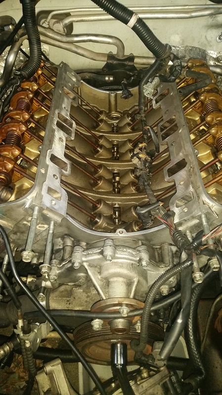

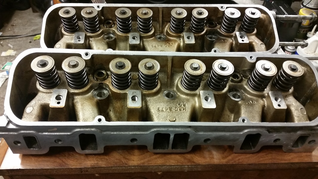

PS I added photos to show you how I worked on the engine. You can see the clean heads with clear holes and ports and the top of the engine with heads in place.
The components were very clean, the car had done very few miles since the work was done and two days before I put it in for repair it had an oil and filter change.
So peering down the oil filler would show clean parts with very clean oil. If he expected black crud he would not have seen that but I was very surprised to be told it was bone dry.
