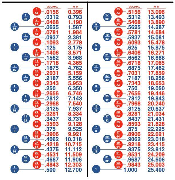

24mm is a bit loose, 15/16 fits better. Remember it's British and they used the imperial system before switching to metric.

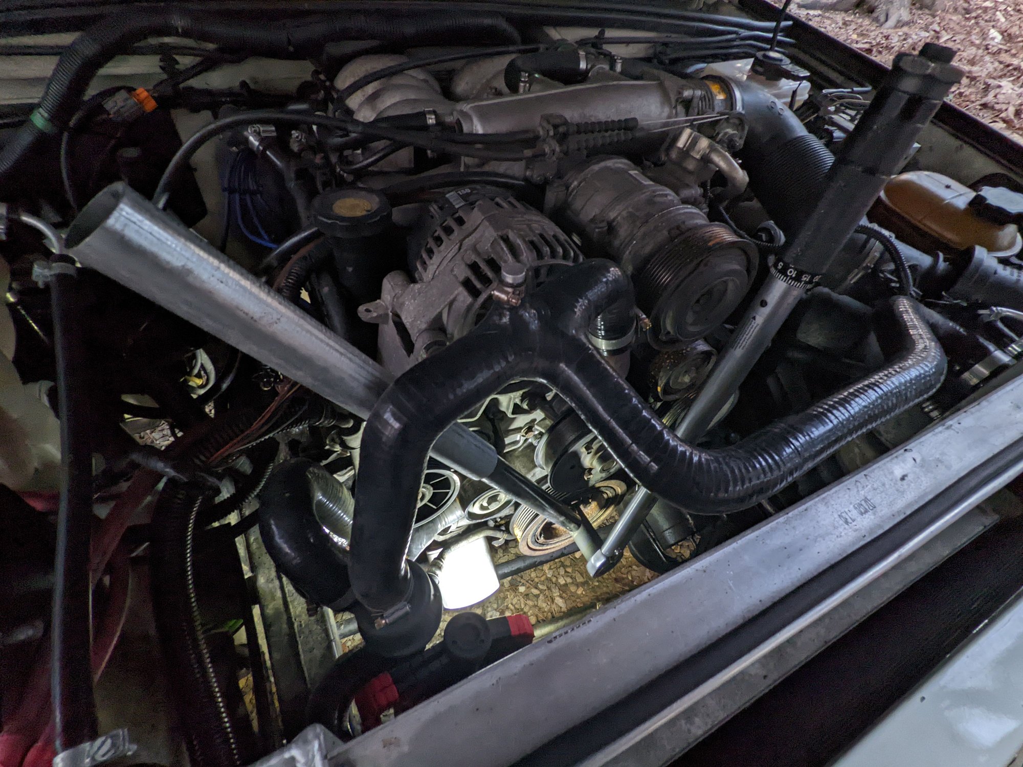

Resting a breaker bar against the frame and bumping the starter works to loosen it. Make yourself a tool to hold the crank for tightening. The small bolts are M8x1.25

I keep this chart around for checking if a metric size is better for things. You can see if 15/16 fits that 24mm is too big.

Breaker bar on frame, something in the flexplate to keep it from moving, or block of wood up inside the block to hold the crank = all work

Sandman 614, I like your home made tool, do you by any chance have a drawing of it with measurement, you can post
