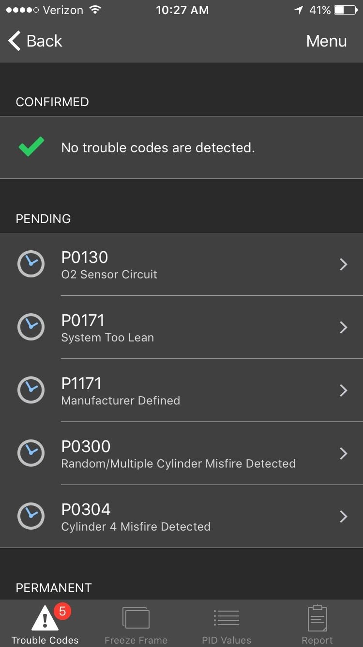

Oh bother...so this past weekend I noticed that after about 10 minutes of driving the truck would idle really low and start to get rough. Like at park, it would have around 620rpm. If I kicked it into Neutral, the idle would go up and the shimmy would stop. I refreshed my scanner, and got these pending:
I'm nervous now that I screwed myself by waiting to fix the misfire (which would eventually fire about 15 seconds after start, I never drove with it misfiring), and now wondering if it's messed up my cats.
What's step 1 here, oh more experienced ones?
