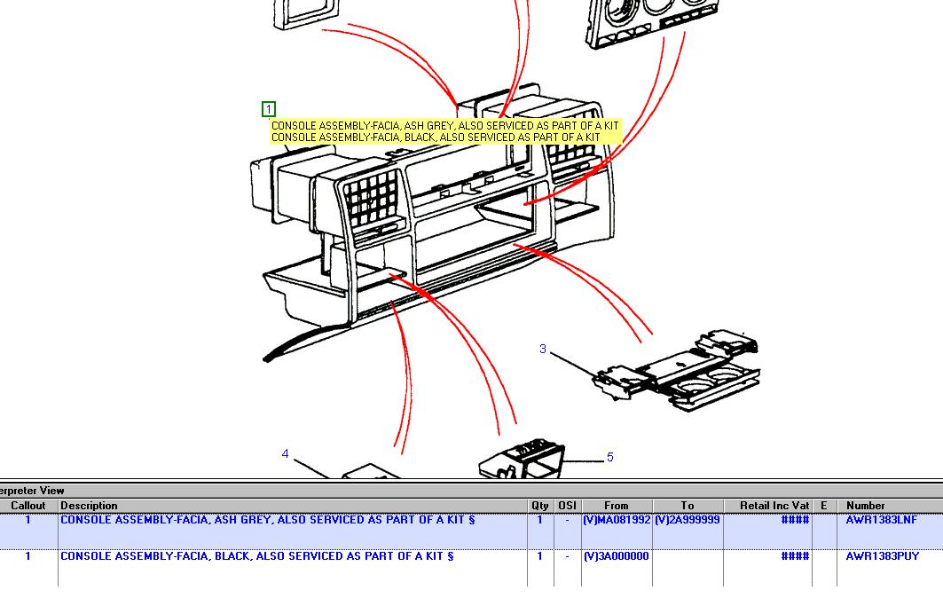

Nope its the SAME!!!!!!!
@ Spike, The instrument cluster would fit, how ever the plugs would most likely be different as the D2 uses a lot of BMW plugs where as the D1 is all rover stuff.
The dash suround / trim that goes around the heater , clock etc is identical, I have D1 bits in mine, its all the same just laid out different and contains diff "modules" ie the ashtray, coin holder etc, clock, 6 switch pack, but you can use either.
The D1, D2 and "late" softdash RRC use all the same dash surround.
They are even the same part number for both models AWR1383PUY or LNF depending on colour. Heres the "proof"
As you can see, same part from MA (soft dash) to 2A....., Disco 1 to Disco 2 "pre-facelift".
From 3A on, SAME part just diff colour, IE black...
