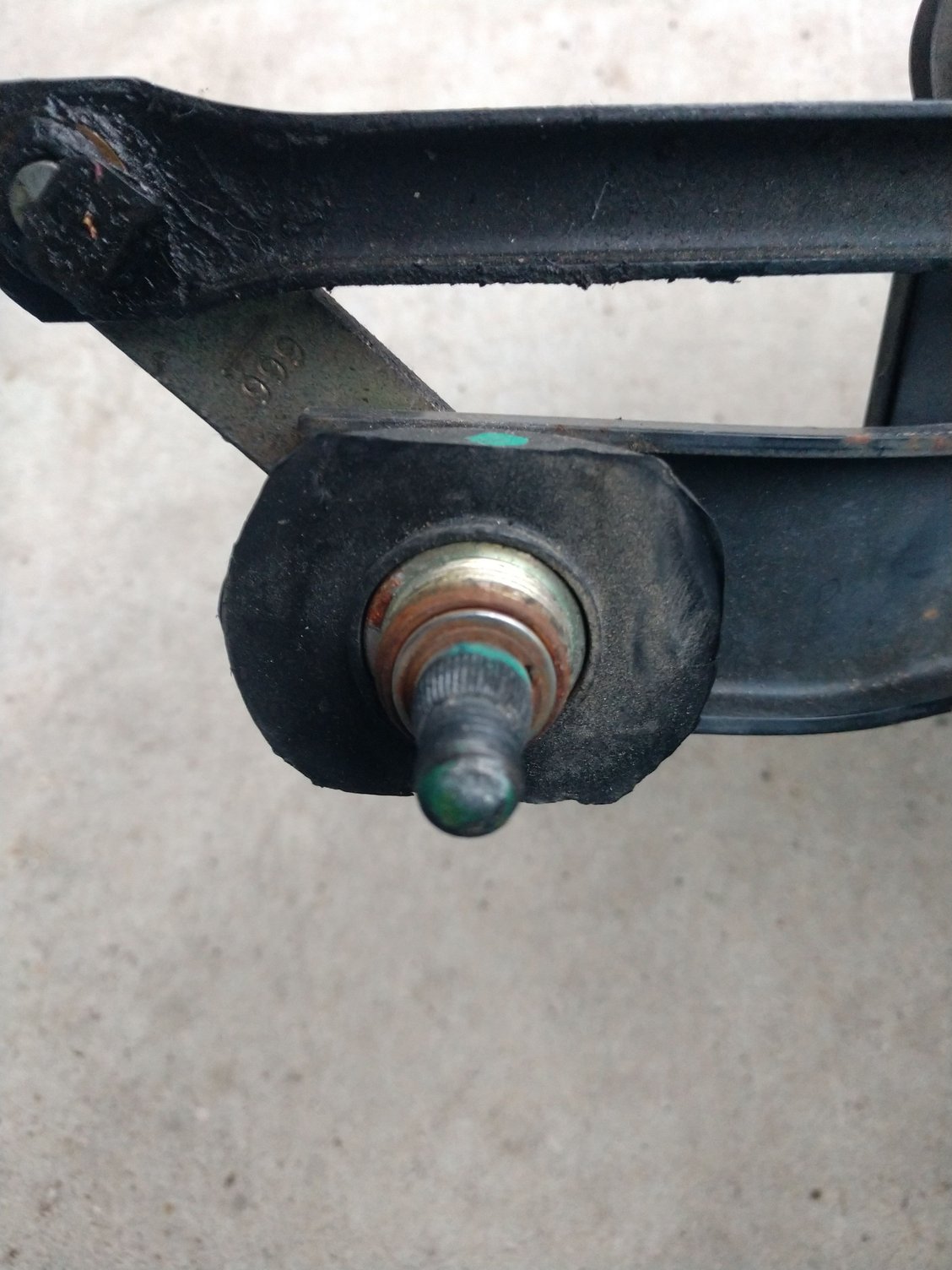

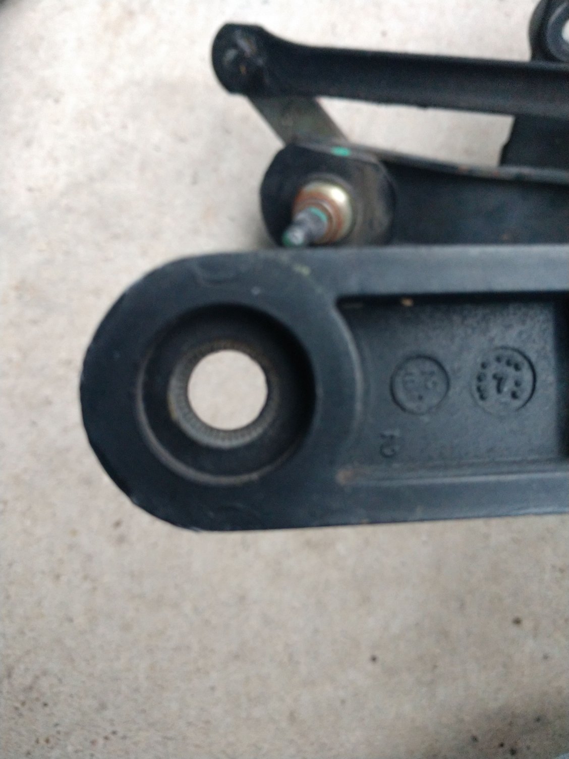

The arms/linkages have small splines which interlock. You just sit it where you want, and then lock down the nut. None of my vehicles have any pegs/notches for a certain position.
Images are of a D2 99-04 Wiper Assembly & D1 Wiper Arm. Small splines 360 on both no keyways or pegs for 1 position only mounting.

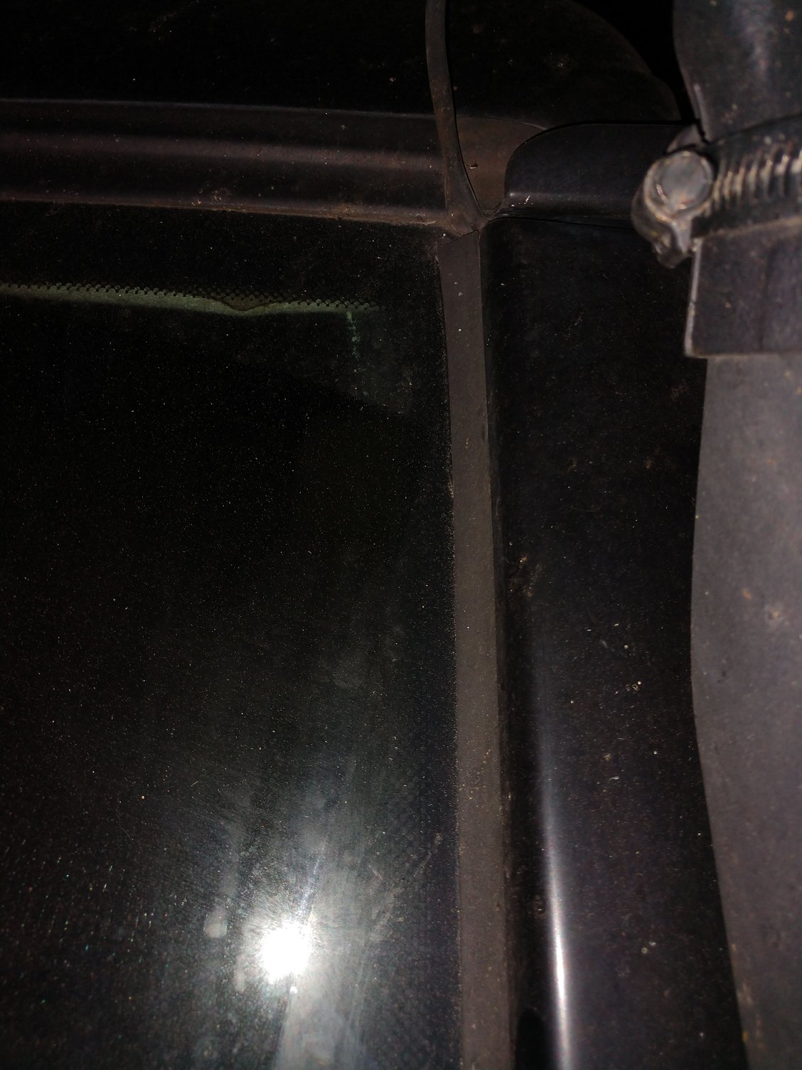

Hard to see, but if you look close you'll see the line where it stops. It doesn't contact the A pilar with how I have them adjusted. If they hit I'd adjust them to sit down lower on the windshield by like a 1/4 of an inch. That should prevent them from hitting after that.

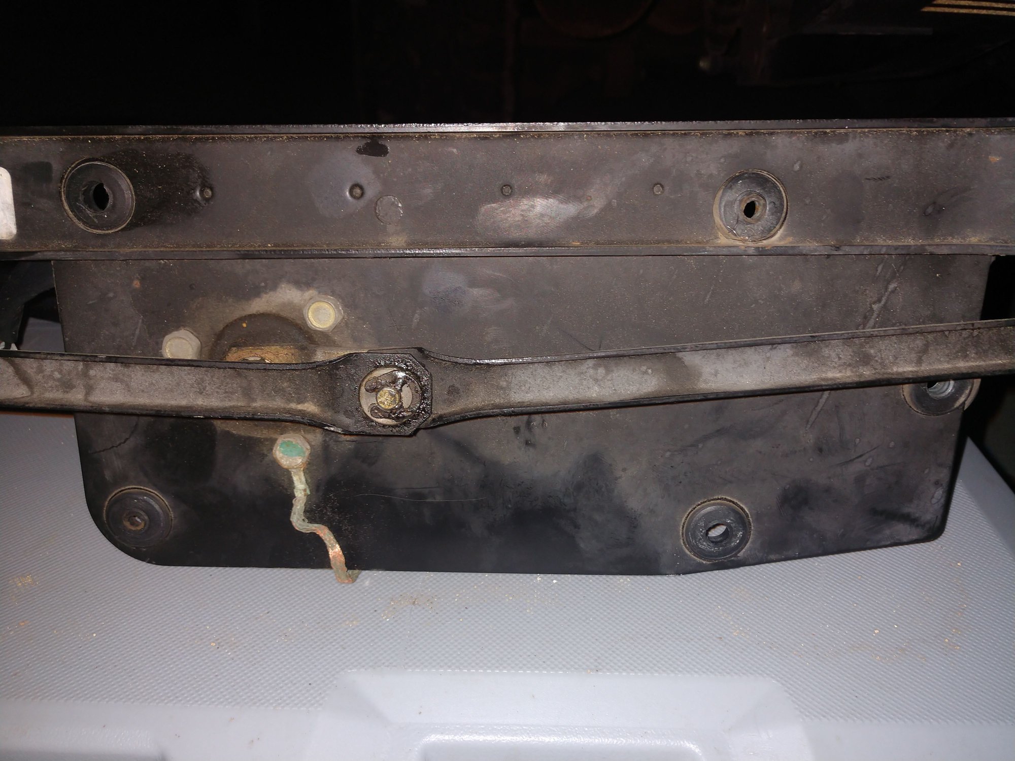

This is how it should sit in the D1/D2. The wiper motor arm will come to a stop pointing towards the 3oclock position. That is the correct adjusted stop point for the D1/D2 wiper motor to linkage adjustment. If it's off = wipers will never stop/start in correct position/spot.
