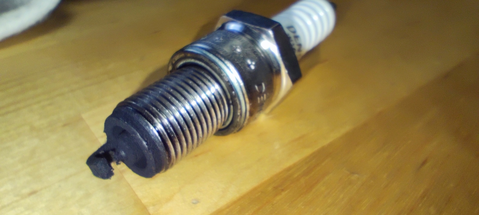

I should mention that this type of failure is pretty rare and should be accompanied with lots of other codes. If one injector is leaking very badly, that side 02 will show rich and the ECM will compensate by pulling fuel to the whole bank. The plugs in the other cylinders will be white, and if it is still super rich you should get a LTFT code. Any unusual looking scratches in taht cylinder? You sure its not oily? A pic of the plug would help.

Here's the #6 plug
I already cleaned it a bit as I tested the gap.

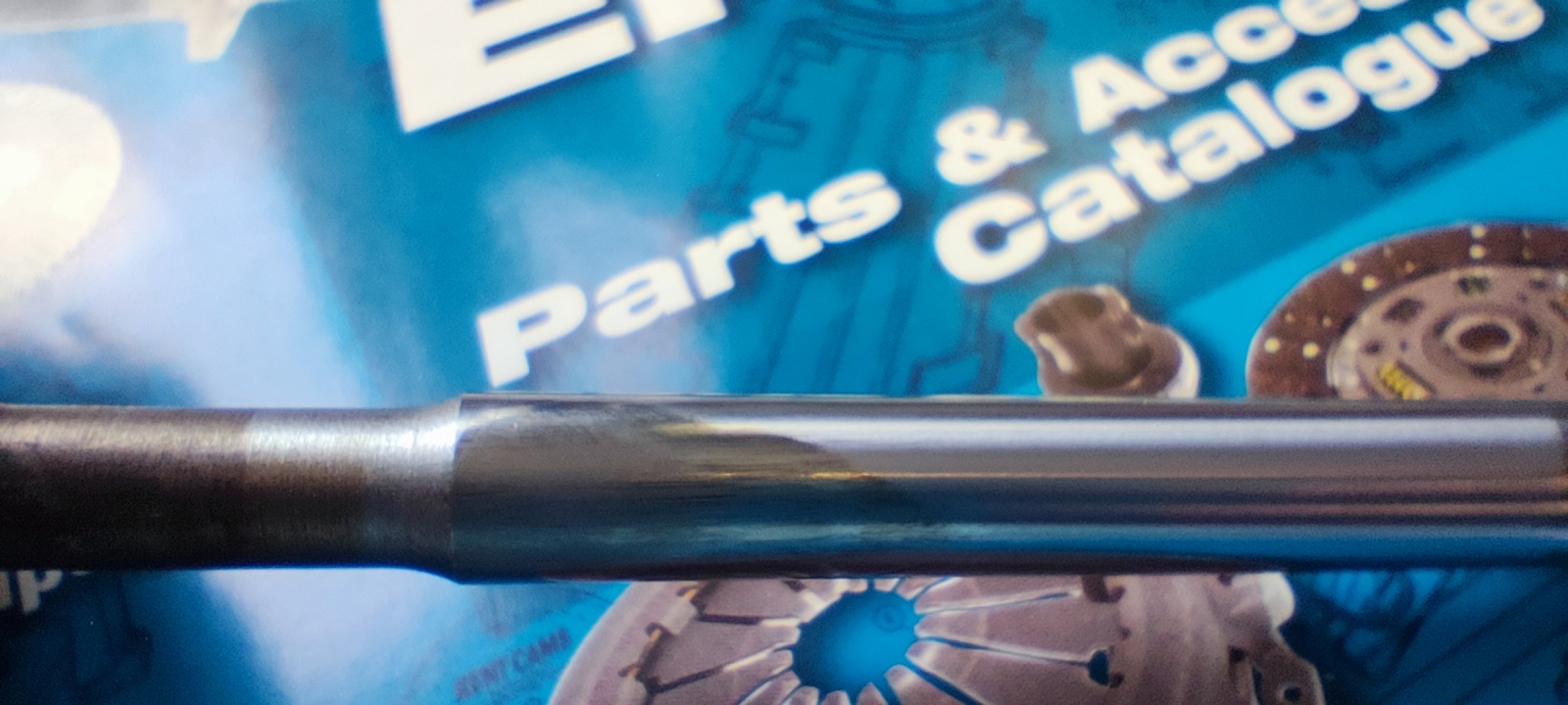

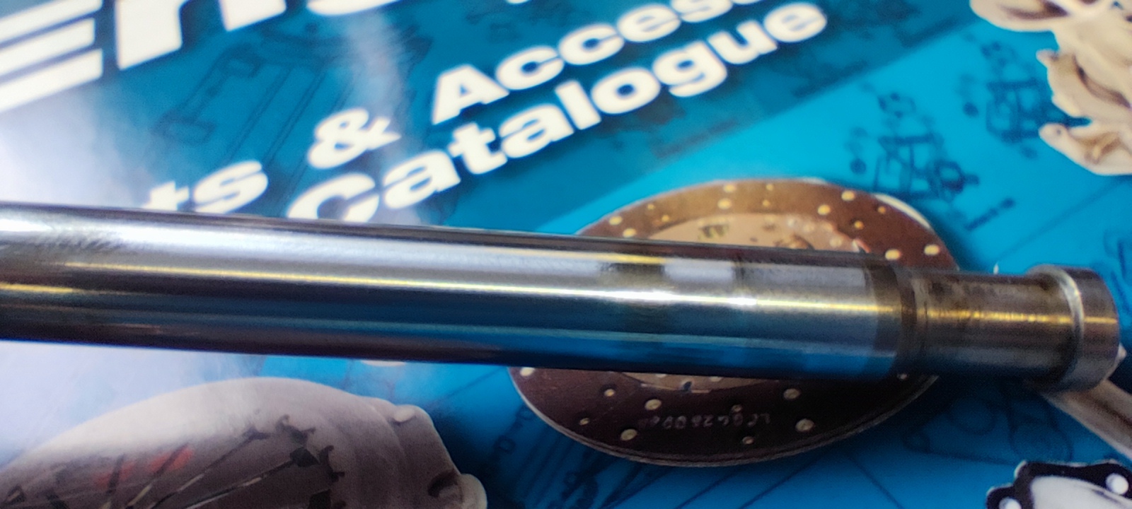

So, this is what all the intake valve stems looked like.
Guides they said are good.
They had the heads pressure tested and they were good.
Apparently had not checked the level yet.
So, intake valves and stem seals to be ordered.
I checked rimmerbros for them, it's a ~150 GBP shipped with taxes etc.
But they do have a complete rebuild kit that will be ~200 GBP all in.
https://rimmerbros.com/Item--i-RB8190RBK
So, I think I'll shoot for the complete kit.

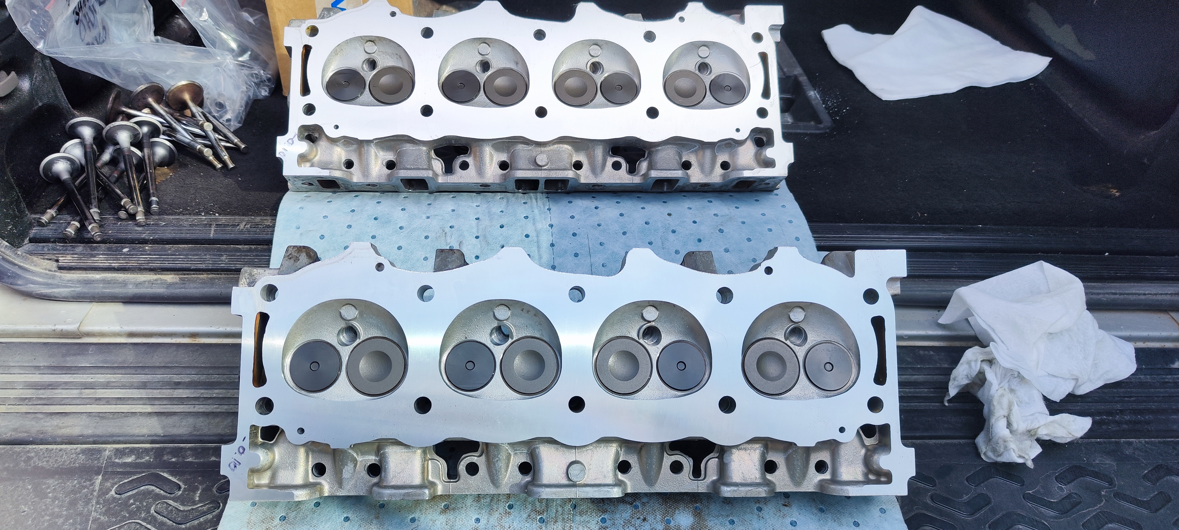

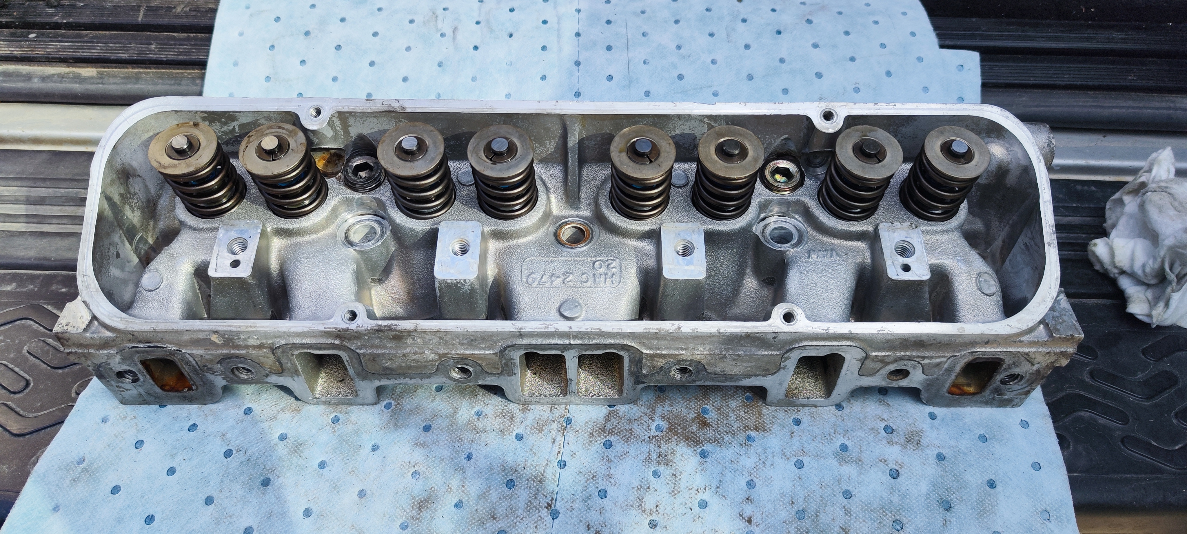

Got the heads back from machining.
-0.1mm milled to straighten them.
All new valves, stem seals, springs.
One valve guide new and one valve seat ot something machined.

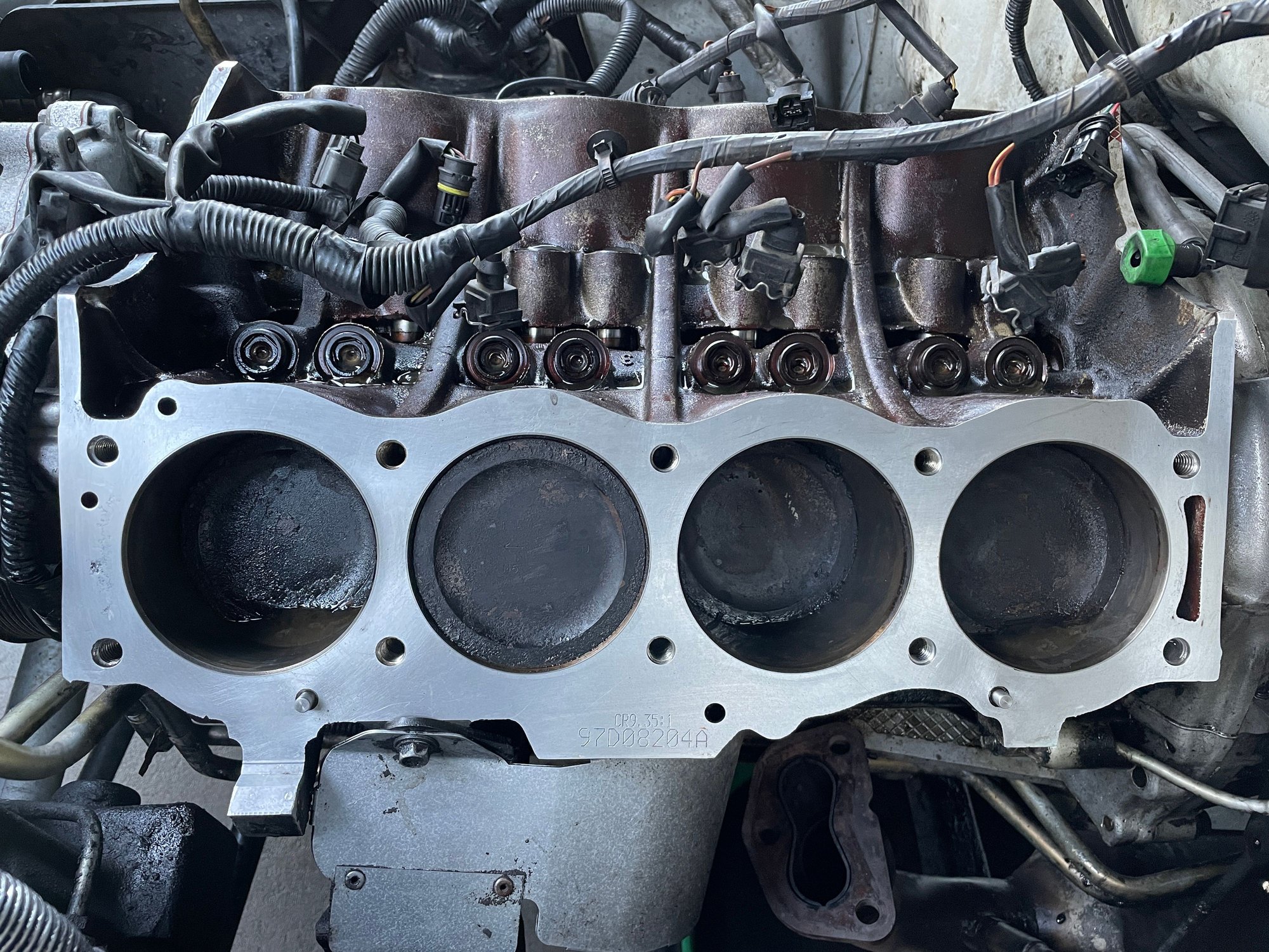

Was prepping to start putting all back together but thought it'd be good to check the timing chain.
... good thing I did, this is what I found
And after that, I thought I'd check the cam...
So.. yeah... no wonder the engine ran like crap with misfires etc.
I've been told that the amongs other things, that the cam and chain has been replaced upon import registration of this D2 ~1000km ago.. mmm...

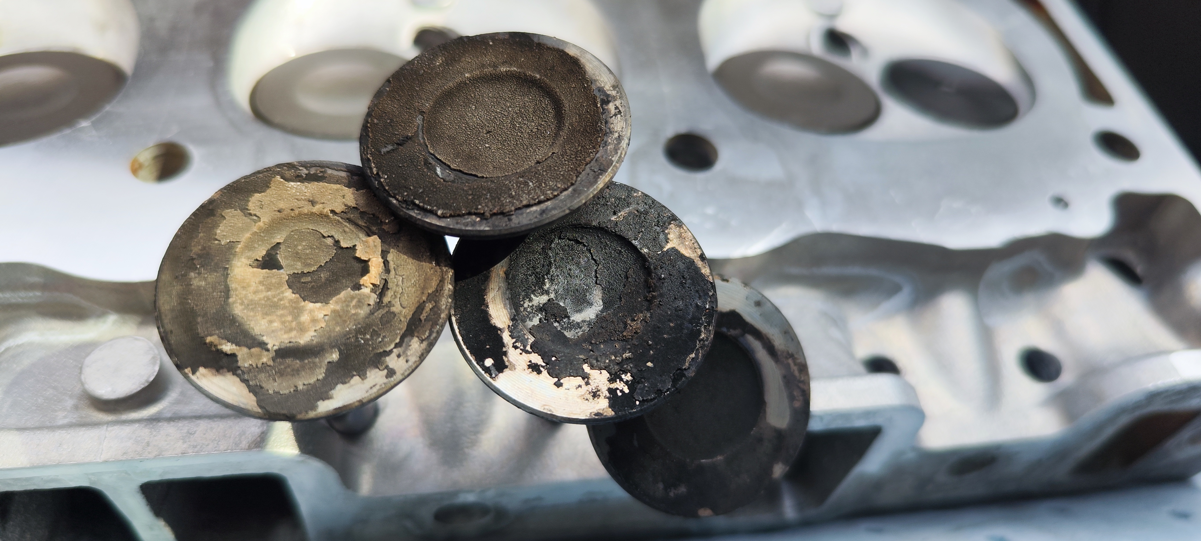

Some of the old valves looked like this, might have gotten a small cleanup already at the shop. No idea what cylinders these are from.
Oh well, now to wait for the cam, timing chain, sprockets, oilpan gasket etc to arrive from Rimmerbros.
Did I do a massive fail getting an aftermarket cam?
Lifters I'll take apart and clean and order new if necessary.

Cam should be fine, most after.market cams are super mild anyway.
