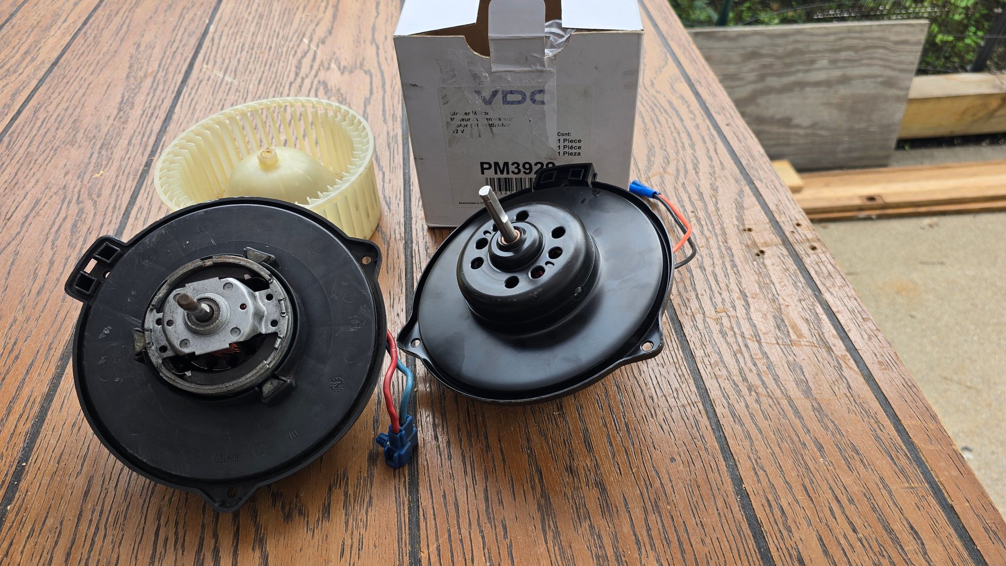

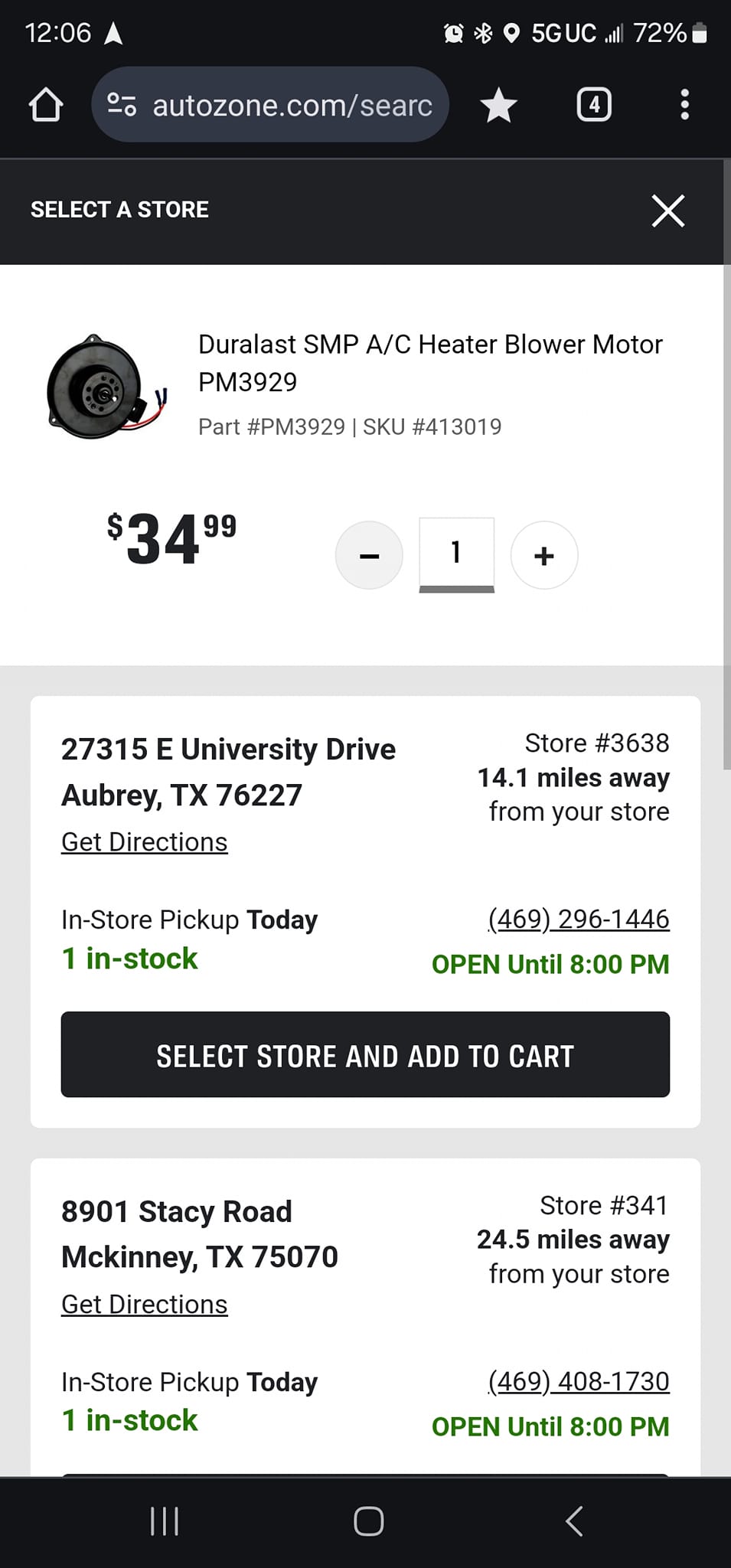

If your d2 blower goes out, you can use a 2002 4runner blower. I removed the fan blade and swapped it, direct fit for mine. Air blows way harder than before and no whining from the worn bearings.

Remove the cover, remove the three bolts that hold the blower in place.
Remove the band, remove the fan blade.
Put fan blade and band back on the new unit.
install the three bolts that hold it in place.
The new blower has crimp leads, the old wire harness has a plug. cut the plug closest to the blower if you want to keep the plug, then test the fan out.
Follow this thread for better instructions
https://www.aulro.com/afvb/discovery...motor-fix.html
If the blower is on and there is no air, flip the cables and you should have air.
Finish re-assembly and done deal.
This will only work if your blower is out, if its an issue with the fuse block or resistor this wont fix it.
If your fan has all the speeds but feels weak/bearings are loud this will resolve the issue.

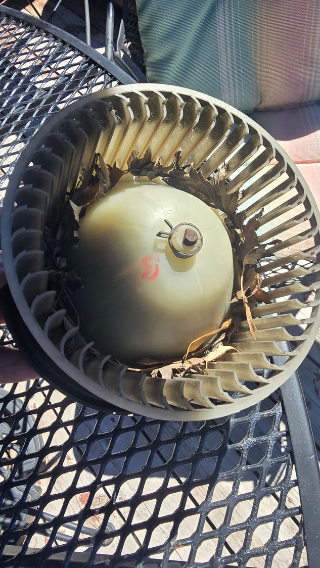

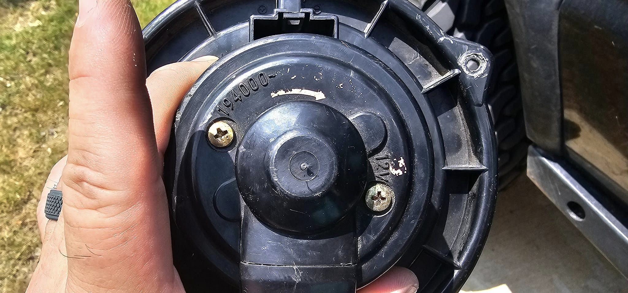

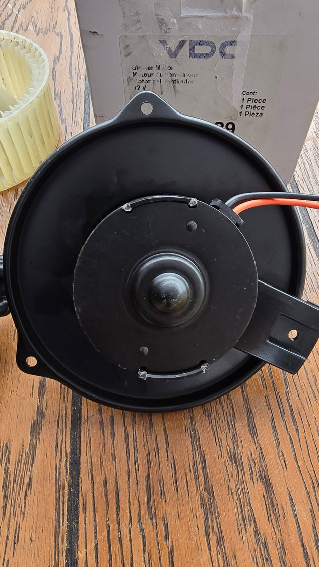

Thanks for this info! My fan was sounding awful AFTER a cleaning out of leaves then dry lubed and cleaning of the cage. Picked one up for 37 bucks out the door. It has more push than the old Bosch. As you can see it's a sealed unit. Getting the old cage off is probably the worst part. As for the wiring I cut the connector off the Bosch and hooked up Red to Red and Blue to Black. That spins the fan in the same direction as the Bosch. If you hook up the wires opposite the fan spun the other way. The only modification is splicing the connector. Cage fits perfect.
Sealed VDO Unit
Bosch/VDO
Bosch Fan pulled last month
