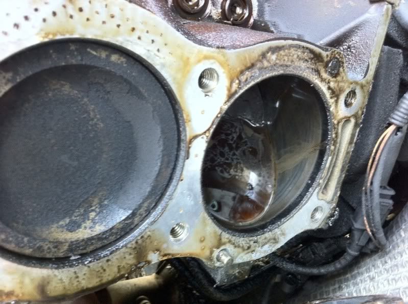

OMG! It really never ends!!! lol I was still wondering about my cylinder. When I removed the drivers side head, #5 cylinder(second from the front of engine) was completely clean. Hardly any carbon build up, it almost looked like it was steam cleaned. Any ideas?

Are you seriously asking about this? Or are just just shopping for a possible alternate answer?
If it's clean, it's been steam cleaned. You had coolant in that cylinder. Look on the head gasket for how it got there and hope you find it. Otherwise hope for a cracked head.
Unfortunately, the #5 cylinder is one of the prime candidates for a leak from a cracked block (crack behind the liner at the bottom of the head bolts).

If you can't see where it leaked through/past the head gasket, and your machinist hasn't called to say the heads are cracked, you have a cracked block and a loose cylinder sleeve. It's really that simple. (assuming you know how to read a head gasket and your machinist isn't a moron)

OK, good news and crappy news...
I found where the head gasket failed, so the chances of a cracked block just decreased! Yay!!! Crappy news is that 2 head bolts now have rounded heads! the 16mm socket(craftsman) failed and thus rounded the bolts. Any suggestions to this travesty? I was thinking about only doing one side of the gasket. I know its a horrible idea but I'm running out of options...

Here's the pics...
As you can see, #5 cylinder is clean. I also noticed that the corresponding combustion chamber was clean. I figured that maybe a wire was either bad, not getting spark or something else all together.

Here's a closer look at the failed gasket. The pool of coolant is what poured out of the head when I initially removed it.
It seems to me that the gasket failed on the outside. Would this account for near complete loss of coolant within 15 minutes of driving and overheating? I'm still worried that I might have a loose sleeve or cracked block.
