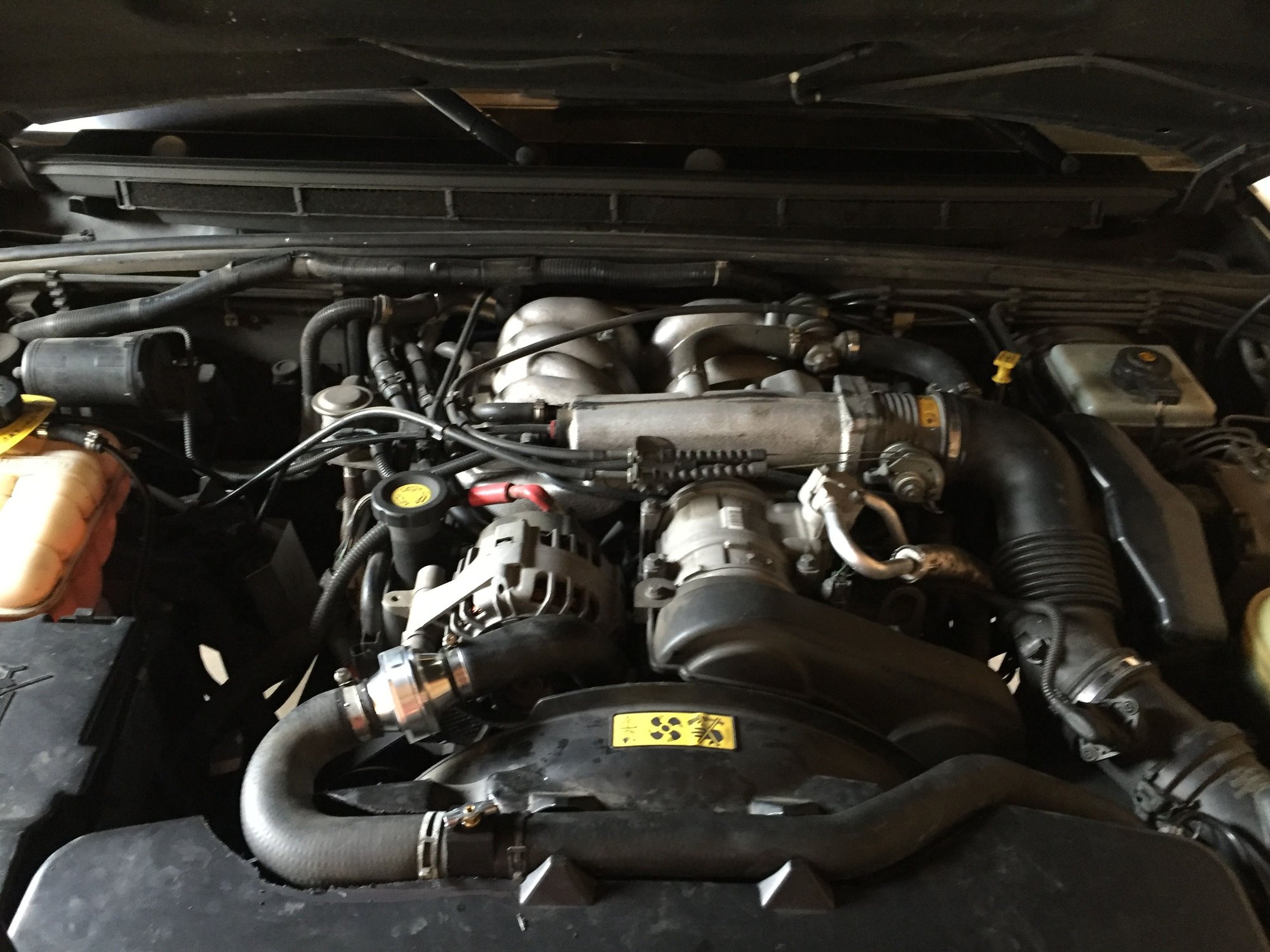

Old Mar 13, 2016 | 08:51 PM
  #103
TheGoneAway's Avatar
Joined: Mar 2016
Just finished up, running really well.
did it slightly different
