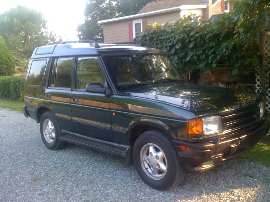

before

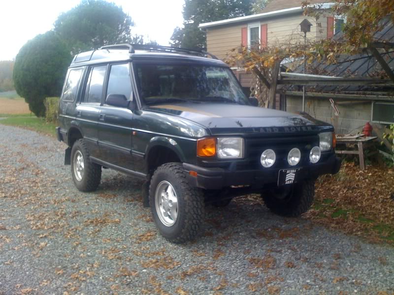

After
Old Nov 20, 2009 | 08:28 AM
XCELLER8's Avatar
Joined: Oct 2008
Posts: 1,647
Likes: 91
From: sackets harbor, ny
Looks good ! longhaul... what size tires are you using ?
Old Nov 20, 2009 | 08:33 AM
Long Haul's Avatar
Joined: Sep 2009
Posts: 916
From: Quarryville, Pa
Im running 245/75/16 M/T's I want to get something a little wider but not in the budget right now.
Old Nov 20, 2009 | 08:44 AM
hilltoppersx's Avatar
Joined: May 2009
Posts: 5,763
Likes: 14
From: Westchester, NY
when you put in the 3" toddco springs what shocks did you use? and you had to redo the brake lines and drive shaft correct?
Old Nov 20, 2009 | 10:47 AM
Long Haul's Avatar
Joined: Sep 2009
Posts: 916
Im using ProComp ES9000 shocks that I got from Toddco im not sure the part #s. There a little stiff than what I like but not to bad. As far as brake lines I was using atlantic british extended ones but there not as long as they need to be. Im going to order some custom ones from rovertym as soon as I get home. The drive shafts are made from a local driveshaft builder (Bud Springs in Lancaster Pa). The driveshafts hve the double cardan on each end in the front and just a longer shaft in the rear. My angles werent bad in the back so I went with just single joints.
