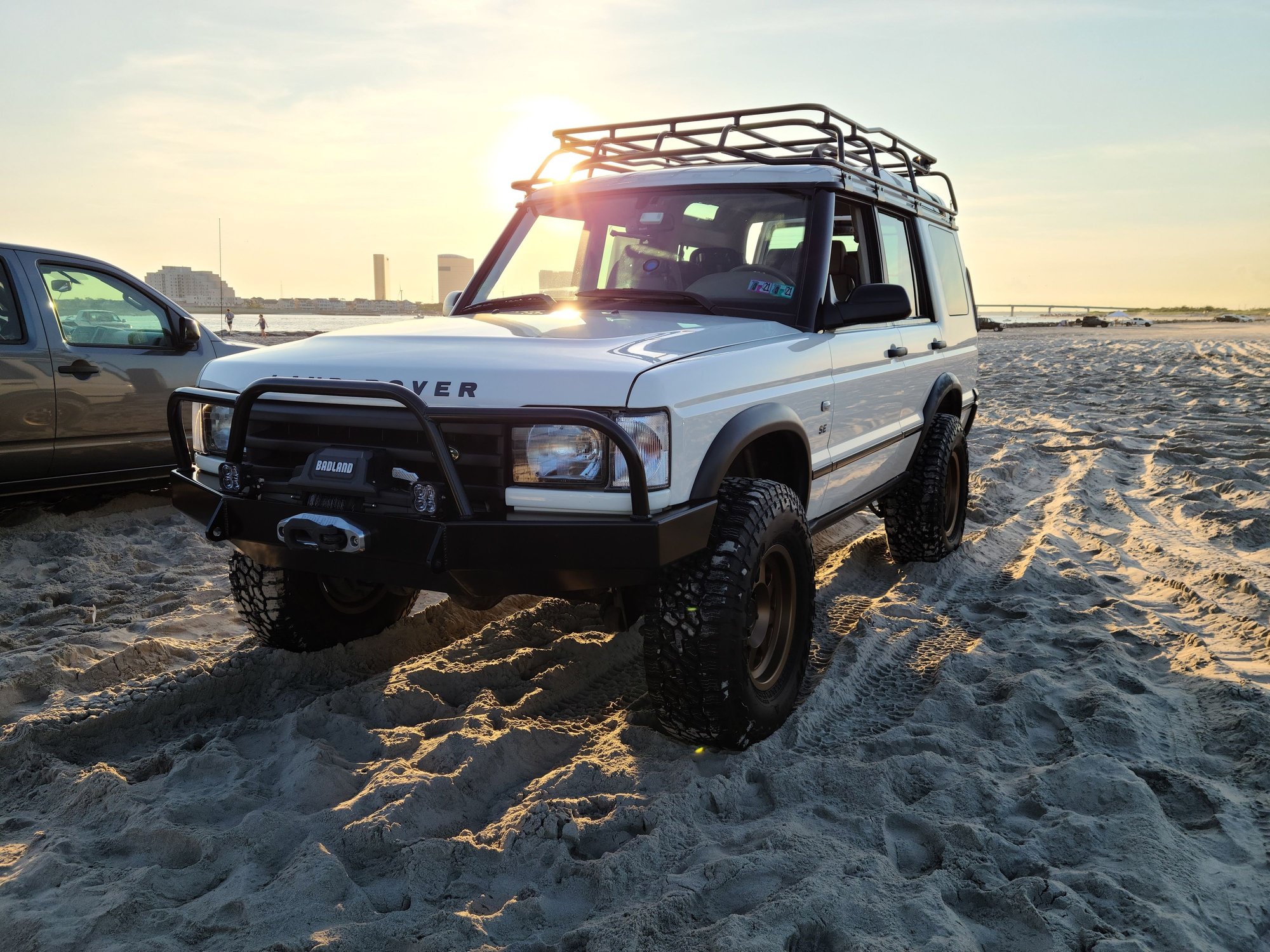

OME HD Springs, 1" spacers, FOX shocks all around. Love the way it drives. It was stiff at first but once I added a little weight it felt just right.
285/75/16 Falken AT3's

Yep lift spacers front and back. I'm not sure how much lift I got but I was happy that the 33s don't rub at all.
Wheels are 16x8 00mm offset.
