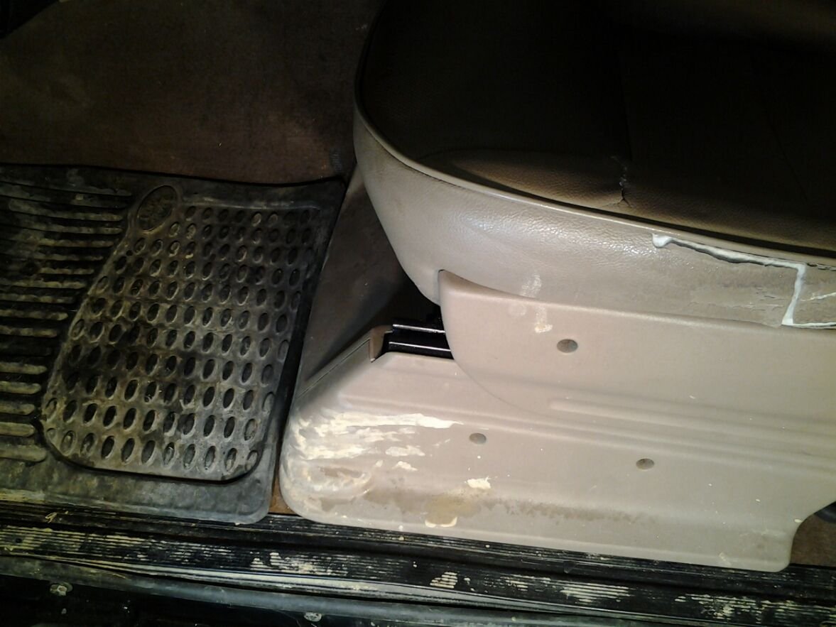

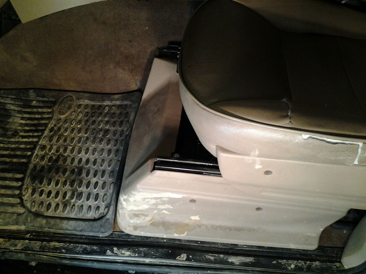

Old Dec 30, 2017 | 01:26 PM
The Deputy's Avatar
Joined: Oct 2016
Posts: 4,867
Likes: 1,411
From: Michigan
Original rearward position.
After modifications rearward position.
Had a long explanation on how to do it, but hit the back button and lost it...sorry, not typing it all out again. If you have questions, just ask.
Brian.
