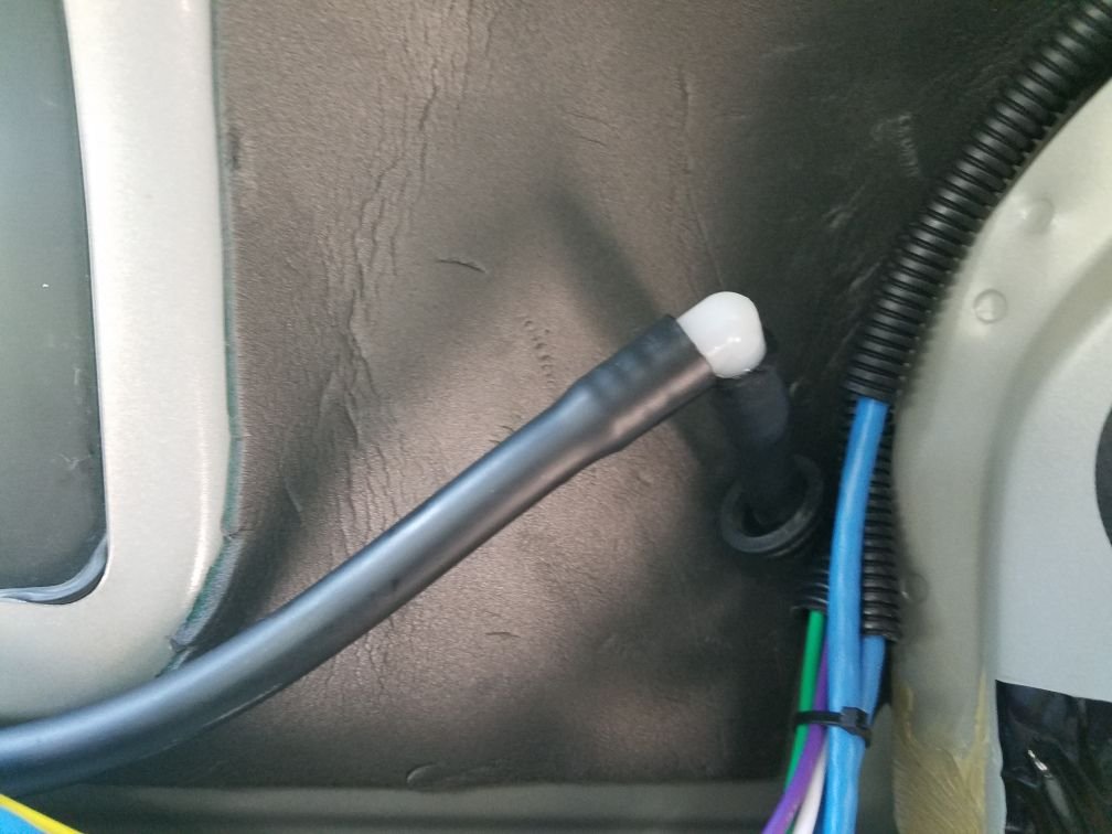

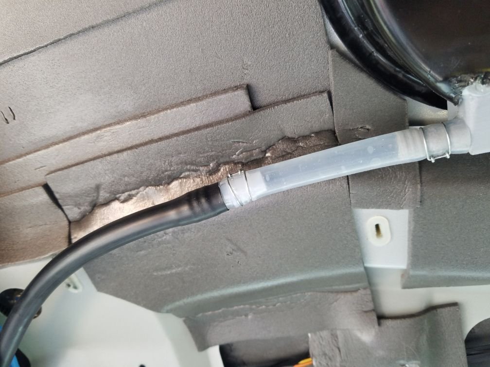

After replacing/refreshing seals adjust the sunroof glass to make it seat tightly on the seal. Also check the drain pipes for flow. The rear drain pipe design is bad from factory. The hose makes a bend upwards which traps water. Water can flow back into the pan and overflow it. Cut the hose at the bend and install 90 degrees elbows, then it drains like it should.
Before
Inserting elbow fitting
After
I also installed a short piece of silicon hose, since the drain tubing is very hard and causes mechanical stress on those plastic corners that might crack them or break them lose. Those corners are 3D printed btw.
