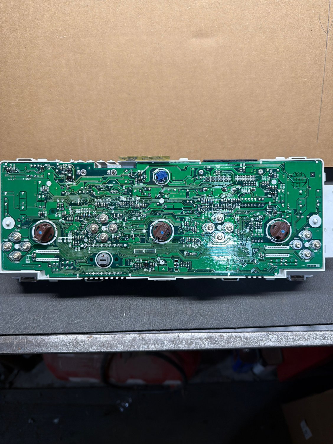

Hi,
My son has had a 2001 discovery 2 for a few years, and every year when temperatures drop into the lower teens Fahrenheit, the dash (binnacle?) electrics go out until the car is warmed up by driving a few miles with the heat on. Just the thing in front of the driver with the speedo, tach, gas gauge, etc. Everything else continues to work as expected.
No amount of wiggling wires on the harnesses that plug into it, or unplugging/replugging, makes any difference.
However, I have a spare dash from another 2001 disco that I plugged in and everything works fine (except the mileage is a 50k miles higher and the mileage flashes). But all the gauges work even dead cold.
I've been told it might be a cold solder joint. I gently removed the white plastic cover and then get flabbergasted since I don't know anything about electronics beyond basic 12v lighting/accessory circuits.
Any tips on what I could look for?
Is there any way to recode the other highr mileage gauges to match our disco? I have a Nanocom if that would do anything.
Thanks!

I did some reading here and it sounds like I can synch the other instrument cluster with the vehicle using Nanocom, but it would synch to the higher mileage of the cluster, making it appear that the vehicle has a lot more mileage than it does.
Does anyone have ideas about where I could look on the original instrument circuit board for something that could cause this? I do have a multimeter and a soldering iron if it is something pretty straightforward.
Or does anyone have a working used cluster for sale that fits a 2001 Disco 2 with lower mileage that I could pair to this vehicle to reflect the actual or at least closer to the actual miles (139,600)? If a replacement cluster is lower mileage, I think the Nanocom will let me synch to the actual miles on the BCU.

In my case the issue is 100% something inside the electronics of the instrument cluster. Putting a good spare in confirms this diagnosis.
