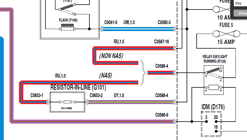

I have a 2001 Discovery 2 and I have just turned on the DRL option, but the headlights are flickering at a very high speed (and so is the relay in the fusebox).
I looked around and there is no resistor, just a jumper wire.
Based on what I read I would think the DRL would work but just be at 100% and not dimmed... but then I saw someone having a similar flickering issue resolved by replacing the jumper with a resistor. Does this sound right? Or is it a bad ground somewhere? (ièm not sure where the BCU is grounded, but i'd like to check that one out just for kicks...)
About that resistor - can someone put an ohm meter and confirm that this is in fact an "0.75 Ohm in-line resistor" like the book says? Because the Electrical diagram shows the Resistor-In-Line (G101) to be 1E3 Ohms, which in my book is 1K Ohm, and not 0.75 Ohm.
or even better maybe someone can just sell me their spare Resistor?
I can't seem to find the darn thing online.
Thanks

Ok, well I slapped together a bunch of spare resistors to make something in the vicinity of 0.75 Ohms and what do you know - it actually worked and stopped the flickering.
As it is - it looks like it taps into the high-beams instead of the low, but i don't care enough to start rewiring the thing.
...But the more important part is that my make-shift testing apparatus is overheating and will surely burst into flames after more than 20 seconds... at least i know i'm on the right path.
I guess i'll call the dealer... Let me know if anyone has one handy. thanks
