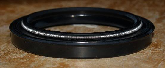

Ok, I guess I was overly broad.
It's not that they don't work, they are designed to keep the lube in, but are pretty worthless at keeping contaminants out. I would only ever use them if the vehicle was never used off-road or in water over the hubs.
The RTC3511 is from the Defender (same hubs as a D1) and are double lipped and do an excellent job of sealing in both directions.

Some installation tips here:
http://www.d-90.com/forum/showpost.p...9&postcount=11

Glad you mentioned it too, I ordered those seals about 2 hours ago. Im sure this will make this customer happy to know WE upgraded his seals...
