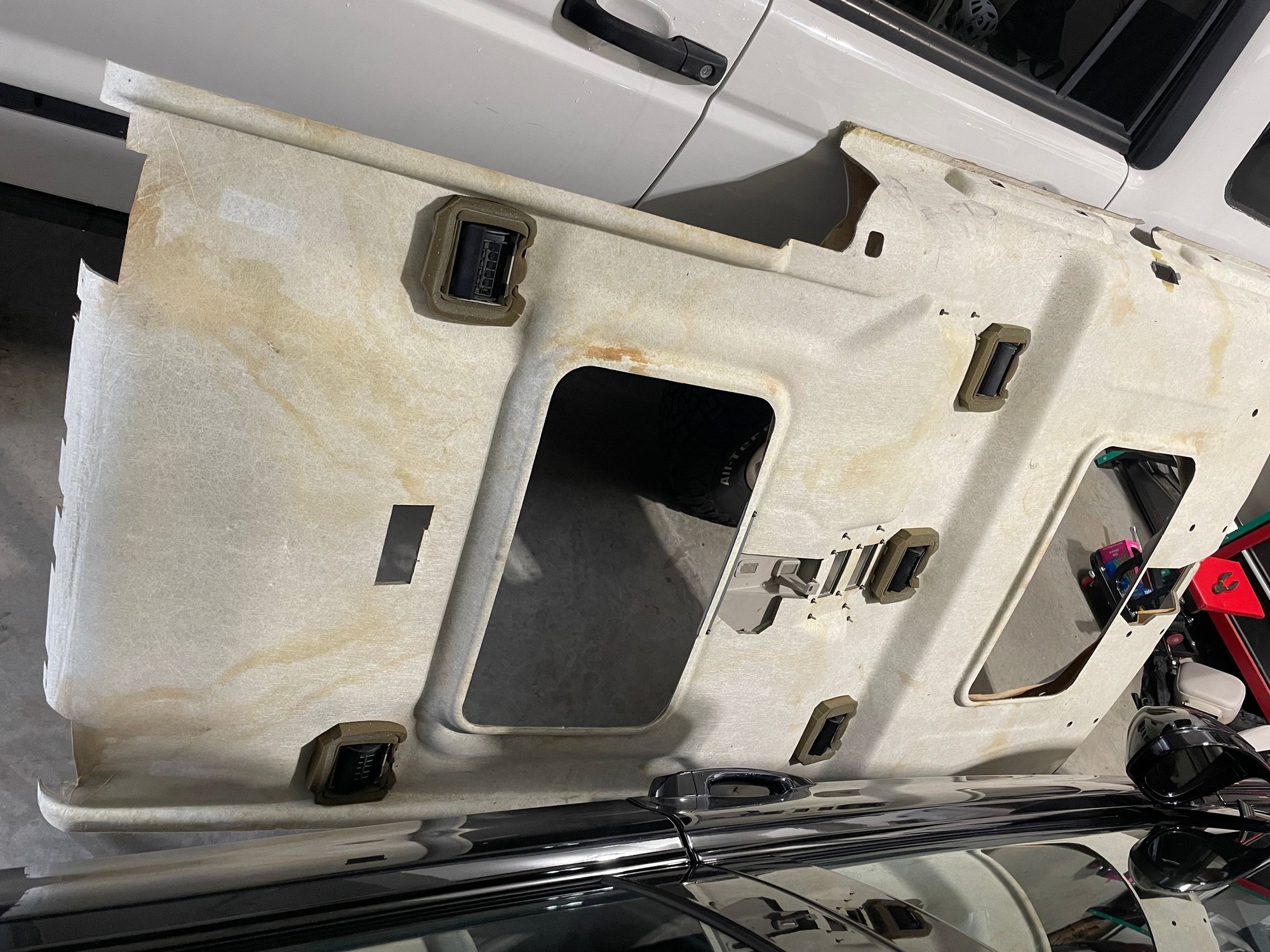

Hello fellow Land Rover detectives. Just took down my headliner in order to reseal my sunroofs since I’ve had water pooling at the base of one of the rear AC vents whenever it rains.
It looks like all of my sunroof drains and the hoses are intact but I have yet to take apart the entire sunroof enclosure so could it be leaking from between the glass and the plastic trim?
Heres the back of the headliner. What do y’all think?
You can see the water stains go from the back center of the rear sunroof and out to the sides and out the back of the headliner. I don’t think the water is coming in from the back and leaking forward right?

Wow, looks like every other Disco headliner that has a sun roof.

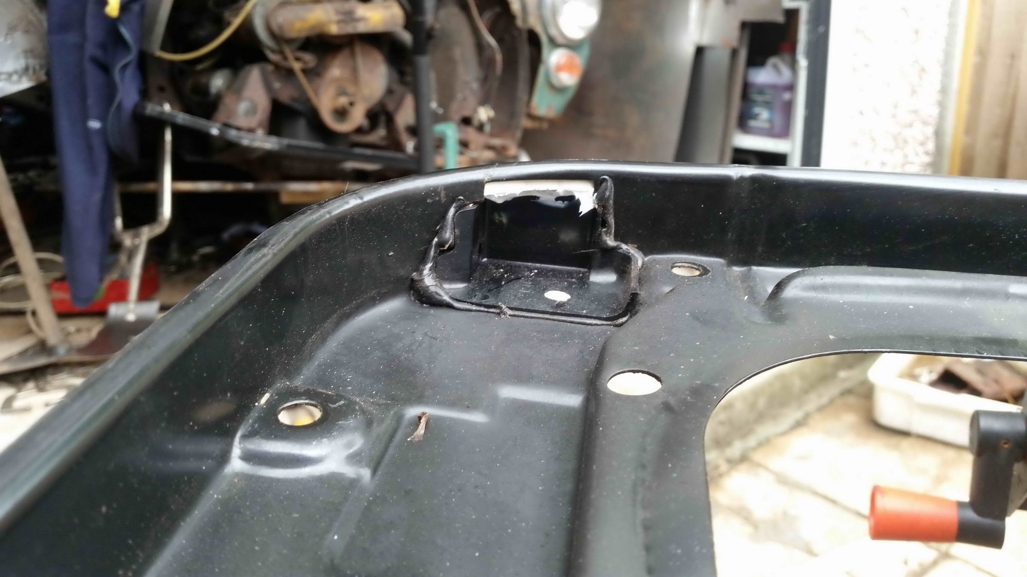

Having done mine it the sunroof seal on the outside mine were so far gone you could move the sunroof side to side and front to back, and now it the perfect time to take them out and reseal them, when you take the out flip theover and i used a small wood chisel to remove the remaines of the old seal the a good bead of sealer
I also, once before I replace the inside bit seall the holes on the corners were the drain holes are using a bit of plastic to cover the hole and the sealer, before doing the outside, when I was happy it was all dry, I sealler the inside, as well, to help prevent any water build up in the drip tray spilling out
I used this, but Im sure you can get similar, now that was 2yearsish ago and Im still dry,
