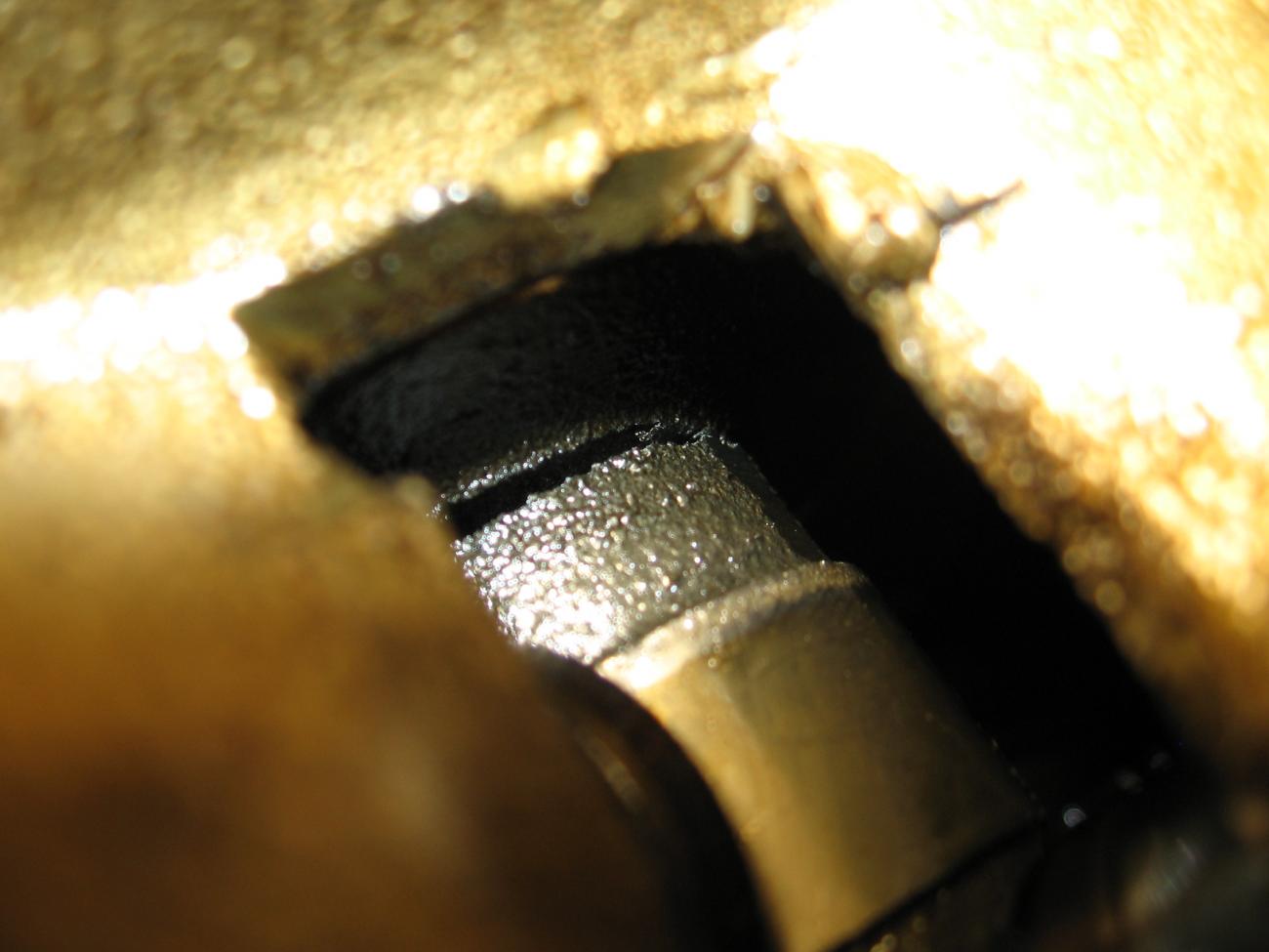

Got the driver's side valve cover off today, turned the crankshaft 4 full revolutions and watched the rockers move on the front 2 cylinders but the back 2 sets of rockers were quiet and motionless.
Now I'm 99.99% convinced that I have a broken camshaft. Are there any other possibilities?

Man oh man, I do not know what could have happened.
Other than broken lifters but man, I dont know how a cam could just break.

Default You're not going to believe this...
I finally got down to the camshaft, and lo and behold, it's busted.
Unbelievable!
