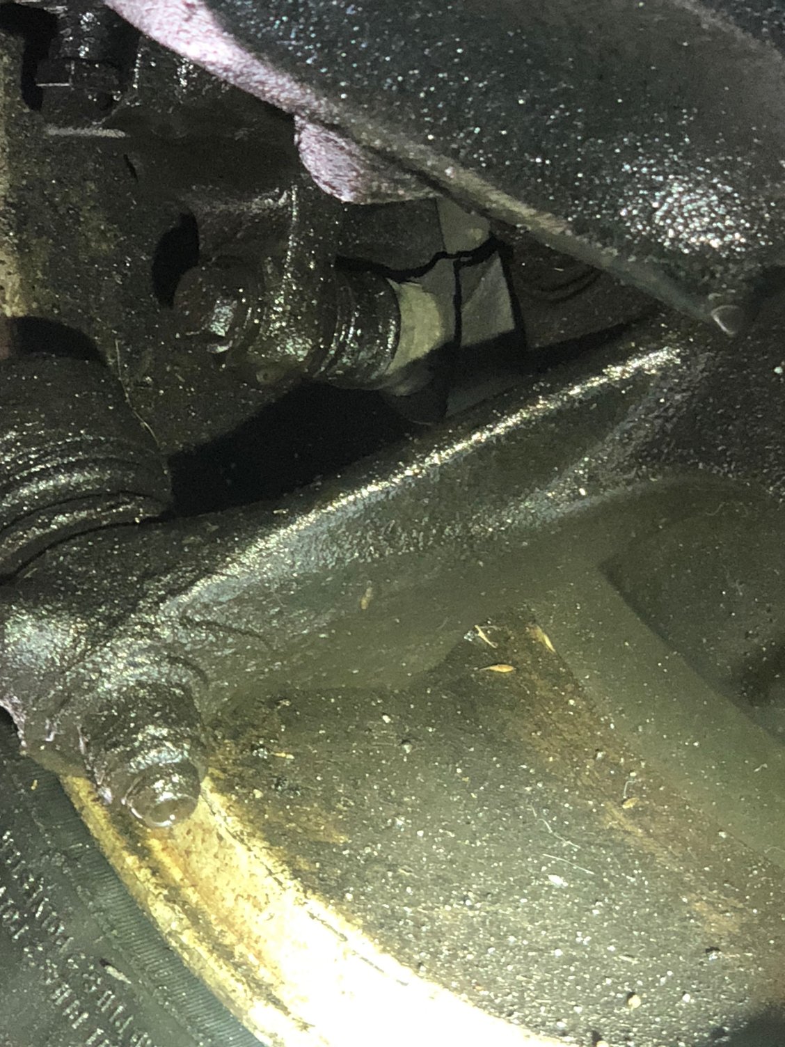

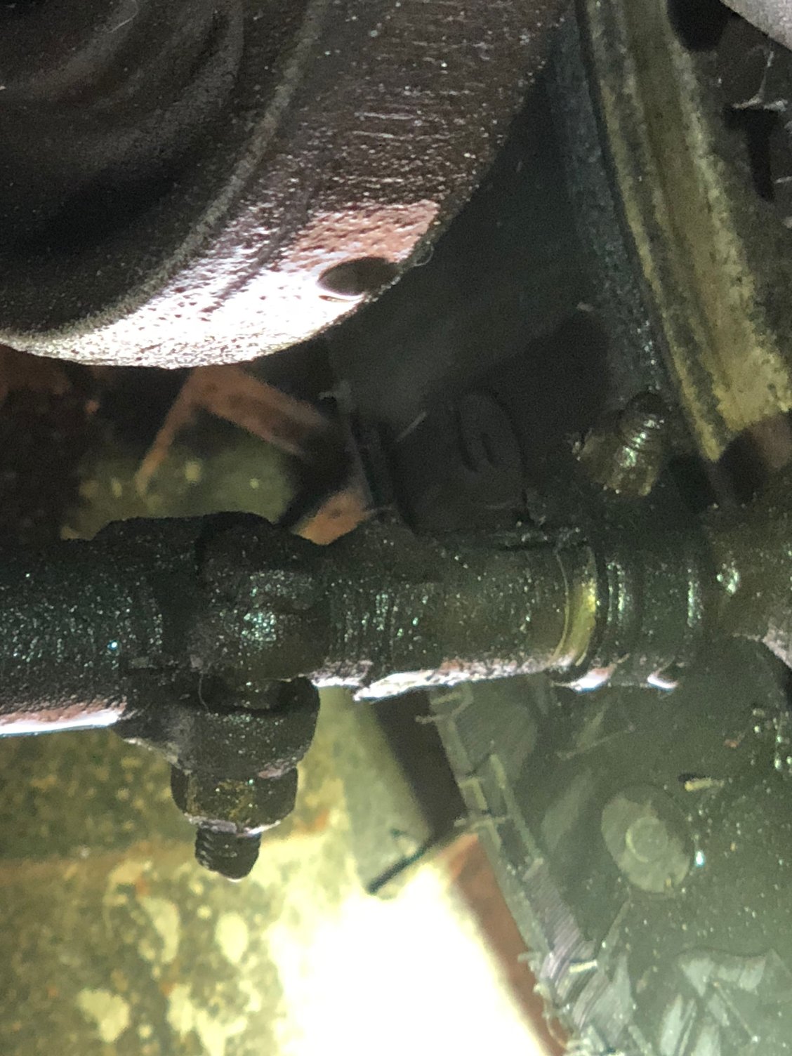

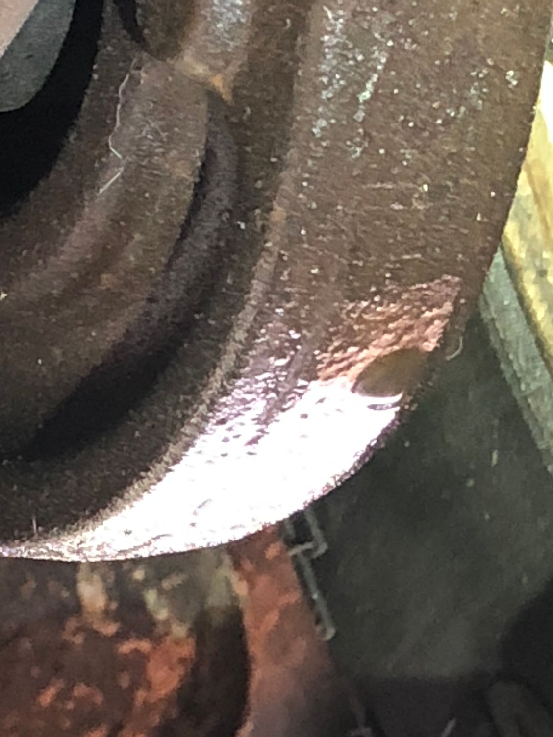

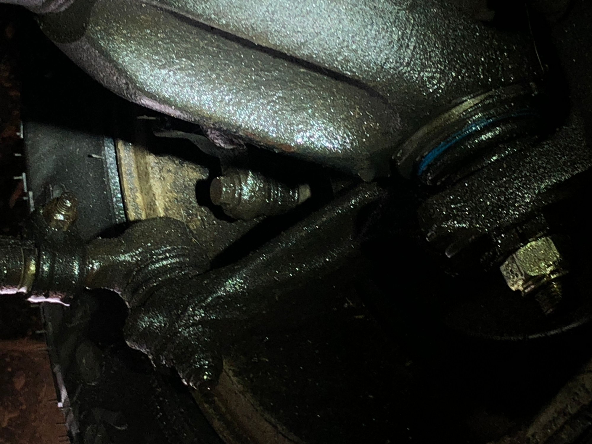

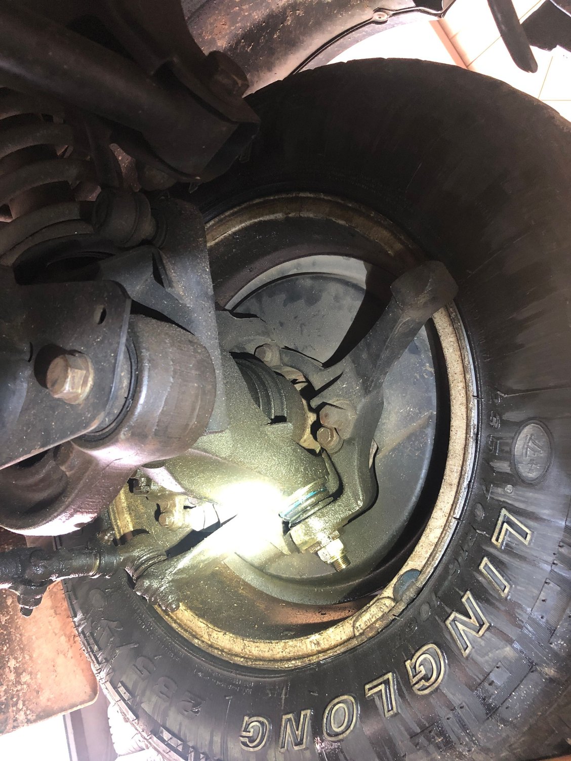

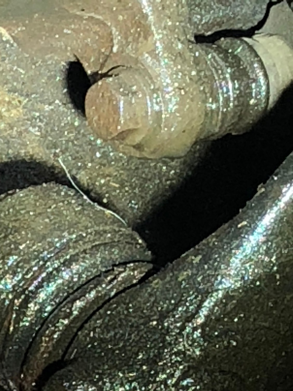

I have a 2000 Disco 2. I noticed spots on the grounds and wanted to figure out what was going on.
I got under it and found what smells like differential fluid all around the driver side wheel.
There is no leak near the pumpkin or the passenger side at all.
Is it a pinion seal that's blown or something else?

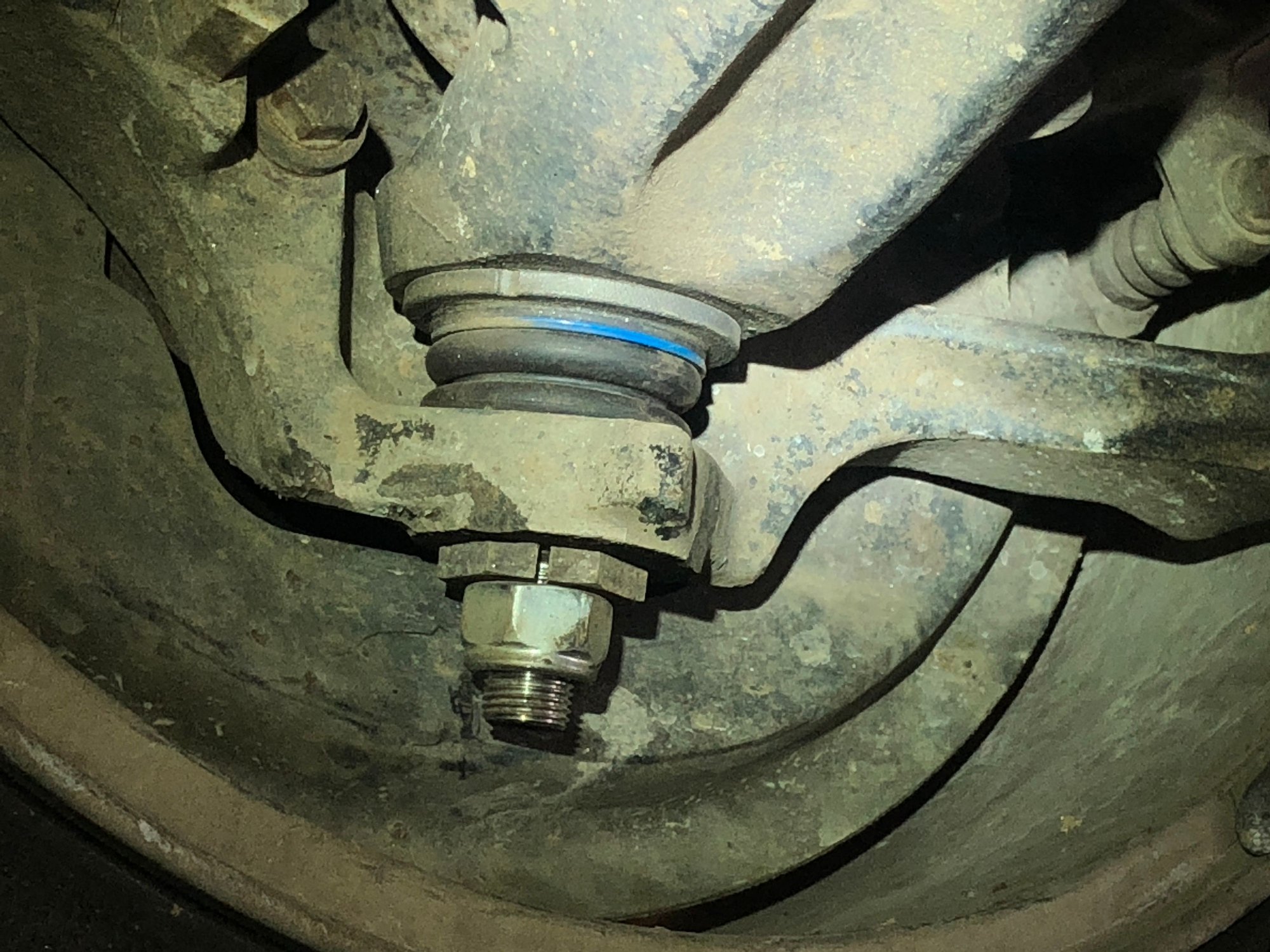

The first 2 photos are of the passenger side for comparison to the remaining photos from the drivers side, where you can see the moisture of the fluid.
All inside the wheel you can see the dust and dirt that has caked up after adhering to the fluid

there is a seal on the axle housing where the CV axles goes into the housing. here's a video:
here's a photo:
here's the part:
https://www.roversnorth.com/parts/ft...8a_range_rover
confirm with rovers north or whichever supplier that it is indeed for the front axle. it's a little unclear on the item listing, unless they're all the same.
Old Jul 22, 2021 | 02:32 AM
The Deputy's Avatar
Joined: Oct 2016
Posts: 4,867
Likes: 1,411
From: Michigan
Me, before l tore into it (replacing seal)...l'd remove vent tube from axle housing and blow through it with compressed air. 9 times out of 10 a plugged vent tube causes leakage of axle seals. Clean area afterwards, completely, and observe after a few days of driving. If leakage happens again...then...follow through with previous posters video, picture and part recommendation.

are you certain you're not leaking fluid from the power steering lines and creating all that mess?
Old Jul 22, 2021 | 09:47 AM
MrMiscreant's Avatar
Joined: Jul 2021
100%
I replaced the power steering pressure house a few months ago, steering is fine and the fluid levels are good. Also it smells like differential fluid.
