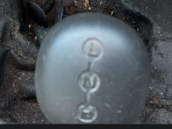

Hi, Im looking to buy my first discovery 2 mainly as an offroader/camper.
I'm looking at a car but trying to figure out if it has a diff lock on it.
The car is a good couple of hours drive so I would rather not make the journey to find it doesn't have one.
Is there any way I can tell from the reg plate or pics of the interrior?
the High Low shifter looks like this:

The shifter is only half the story.
This is just a Hi-Low shifter with no diff-lock capability. At the most basic level the response is that this Disco does not have a diff lock.
But wait, there is more!
While the Discovery 2 replaced the ability to lock the differential with better traction control, the reality is that there were lots of transfer cases in the supply line that still had the diff lock. As a result early Disco 2's had a locking differential, but not a shifter to engage the lock. My 2001 has a locking differential, but has the same shifter as you show in your picture. If you search my posts you can see some pictures of the bright yellow lever I installed so I can lock my diff (although I have to crawl under the truck to do so). This picture will also give you a clue what to feel for on this vehicle to determine if you t-case has the feature. The general expectation, and there are exceptions, is that a 1999-2000 will have a lockable t-case and only needs an updated shift mechanism; 2001 probably does. By 2002 and definitely by 2003 the transfer cases no longer had the locking guts. And in 2004 the locking diff came back along with a shifter in the cabin.

Thanks for the reply Bullet. I'll get under the car tonight and have a look. its a 2002 model so it looks like the odds are against me having a CDL.
