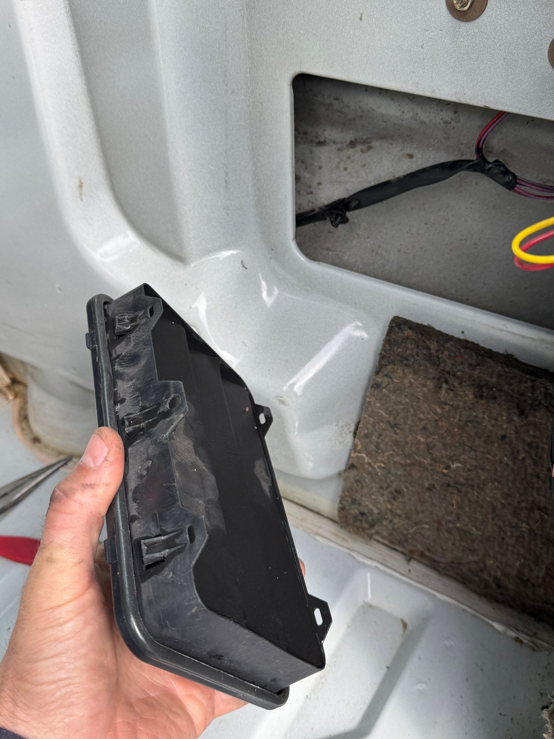

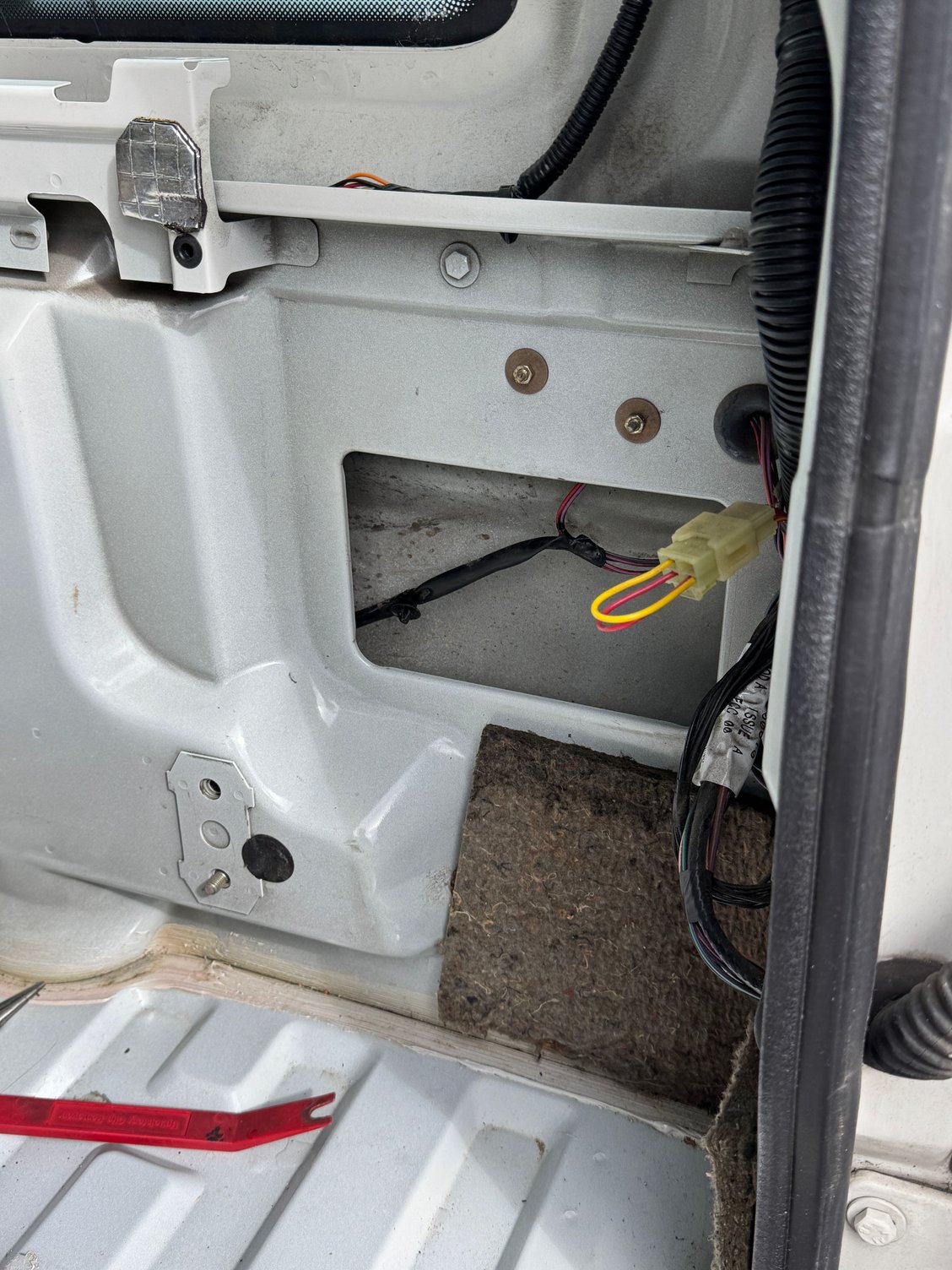

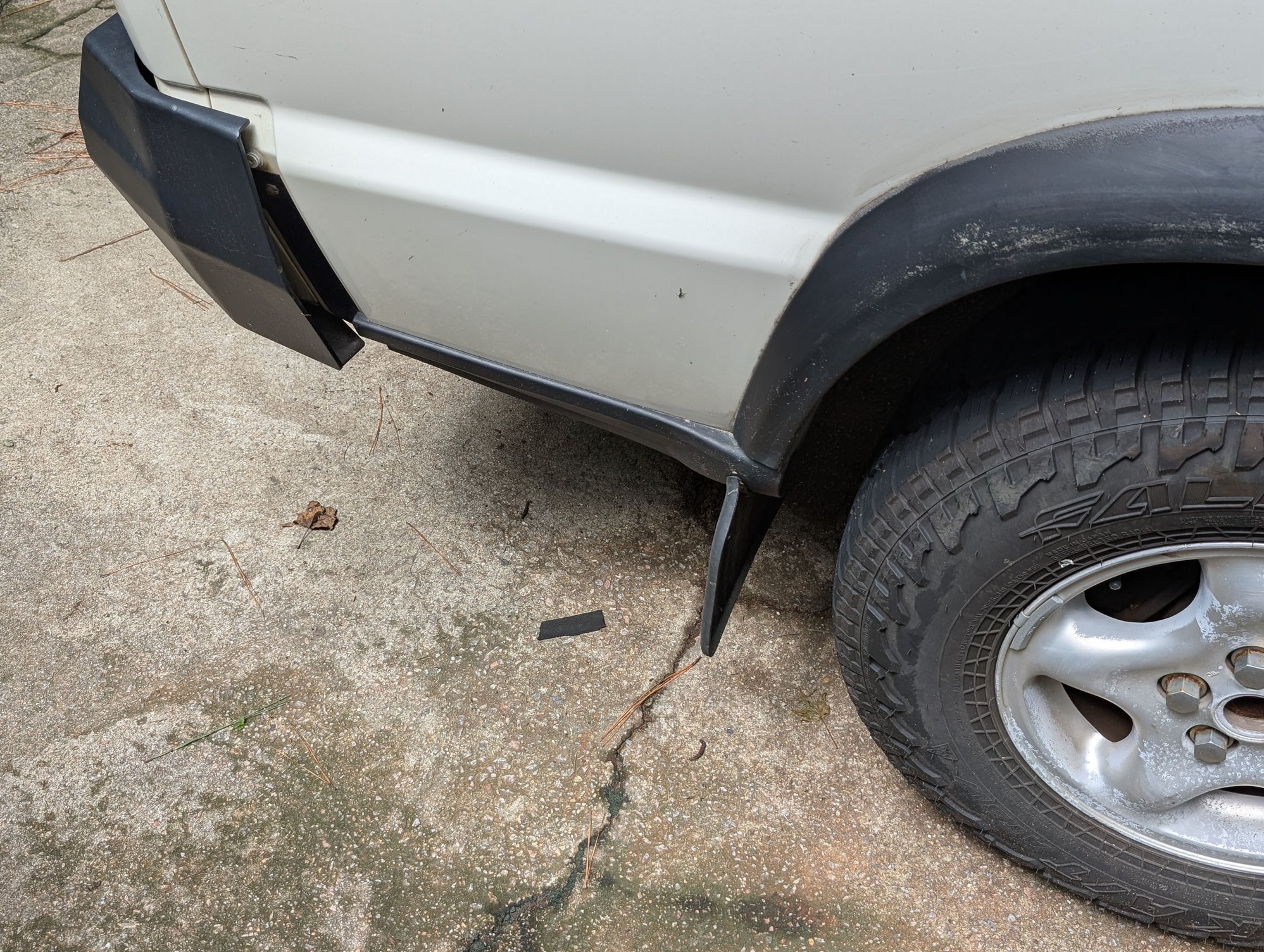

Does anyone know what this rubber strip is from? It's soft and kind of gummy/tar like, pulls apart easily. I've found a couple pieces of this laying on the ground behind the back tire of my disco and can't figure out what the squirrels are tearing up..

I’m thinking sound deadening as it looks an awful lot like what came off my E30 BMWs when I did clutches in them.

It's a flap from this part, when you close a door it expels air but doesn't allow air back in. They deteriorate after a while. I ended up grabbing a bunch of them just strolling through the BMW section of the junkyard a couple months ago. They came on like every BMW model for most of the 90s-2010s. BMW part number is 64-22-8-377-280.
Awesome, I'll see if I can see it from the bottom. I don't intend on tearing out the interior for a while.
