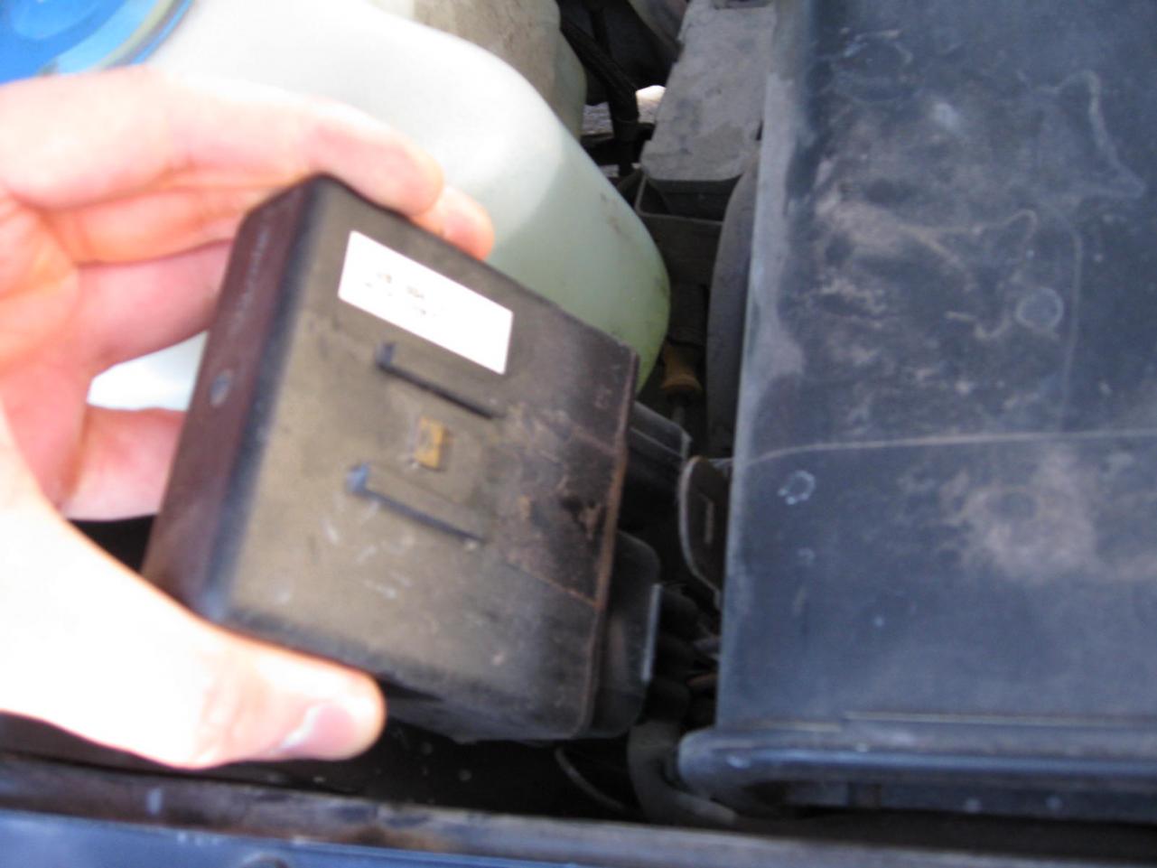

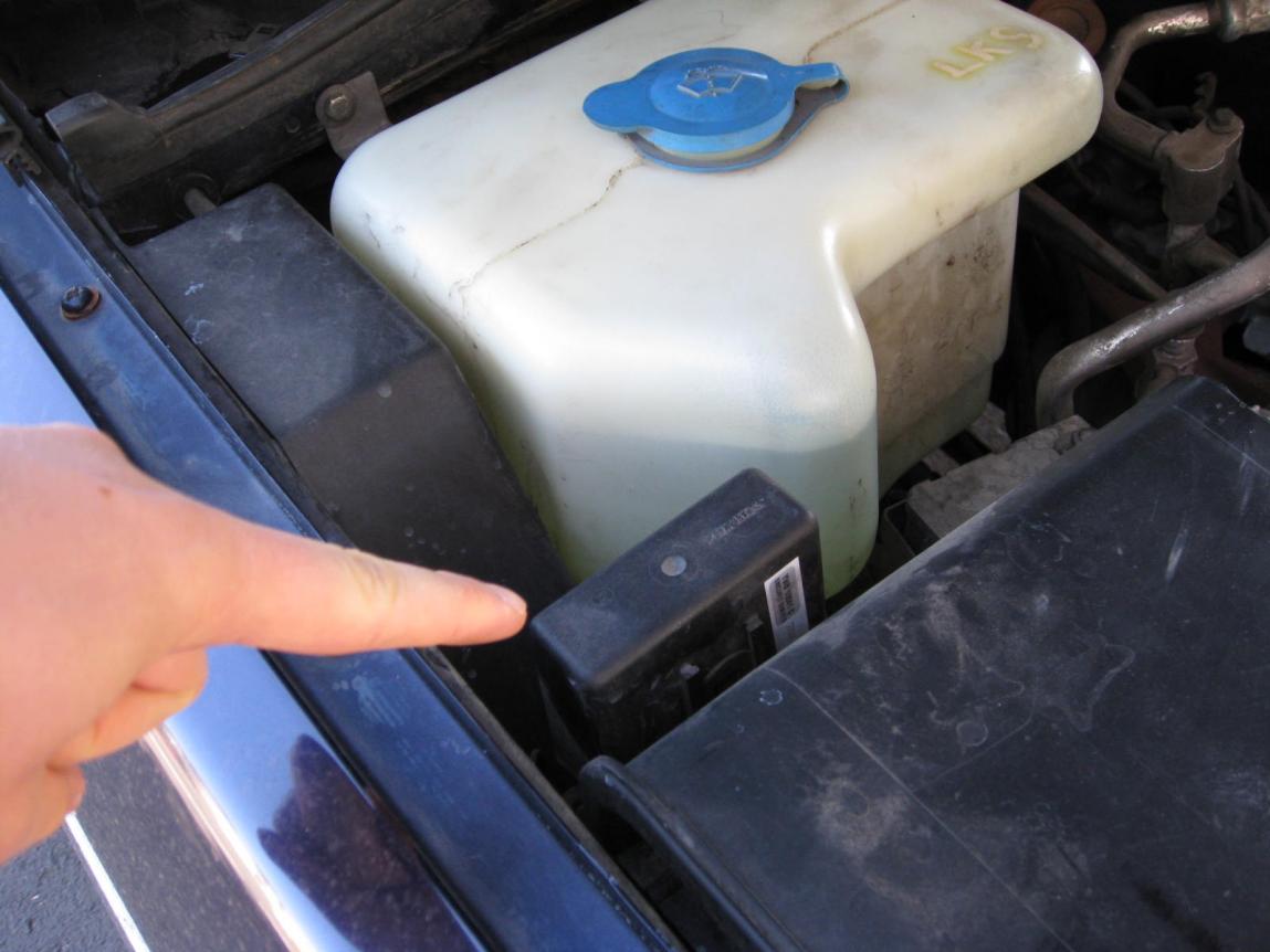

Old Oct 6, 2009 | 03:15 PM
98roverguy's Avatar
Joined: Aug 2006
Posts: 1,002
From: Colorado Springs, CO
This is the part. http://www.roverparts.com/Parts/YWB100820LG.cfm
Here's where it's located. Pull it up, disconnect the two connectors. Reconnect to the new relay and slide back in place. You just saved yourself a ton of change.

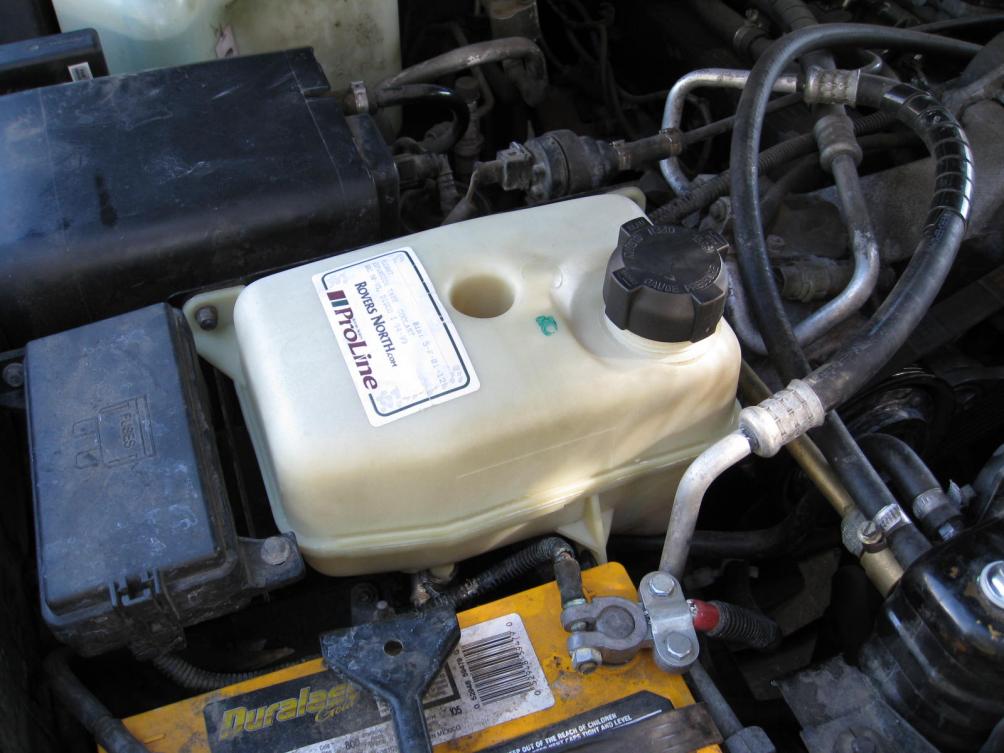

Bonus pic: My new expansion tank from RoversNorth!!
