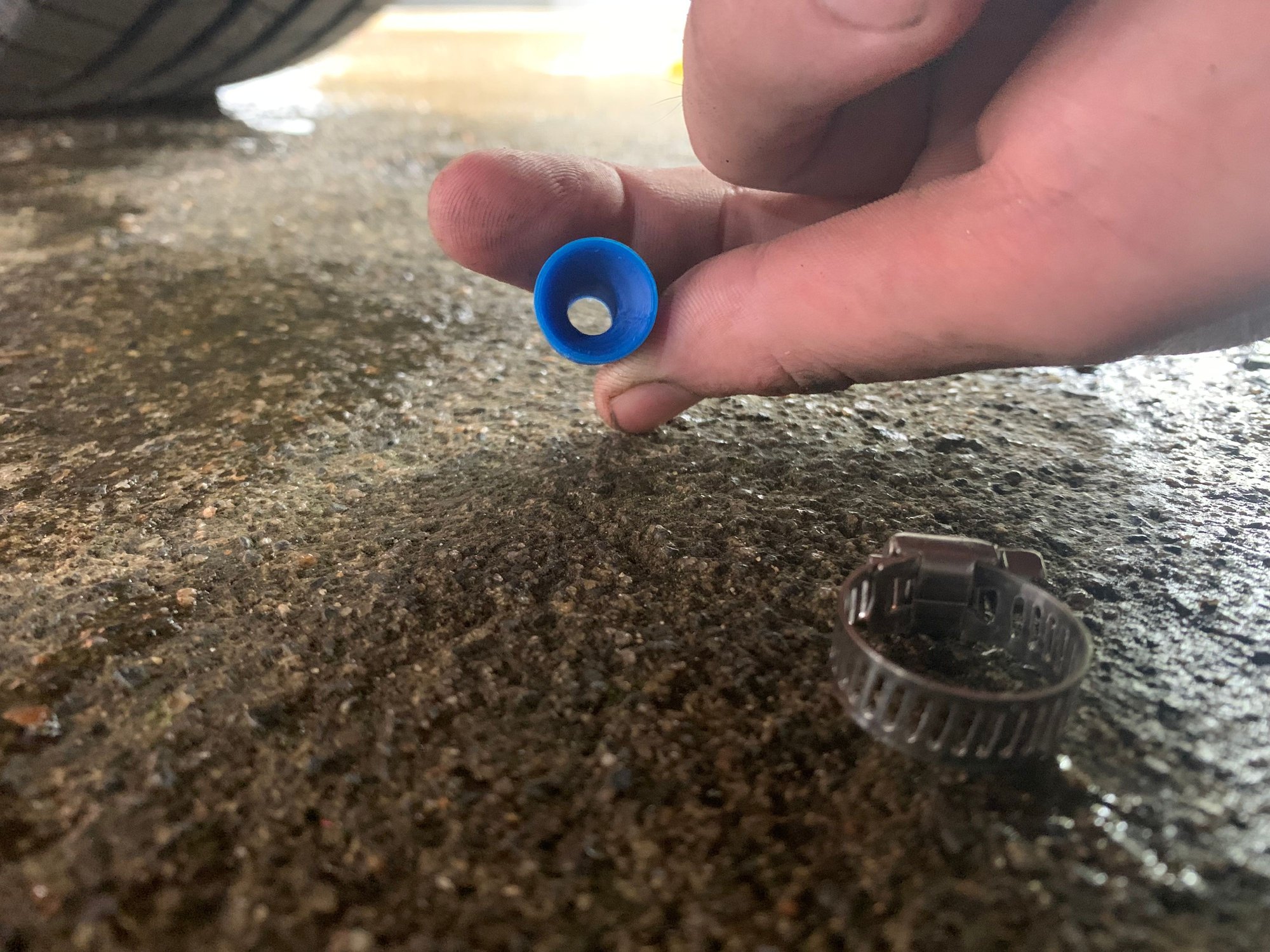

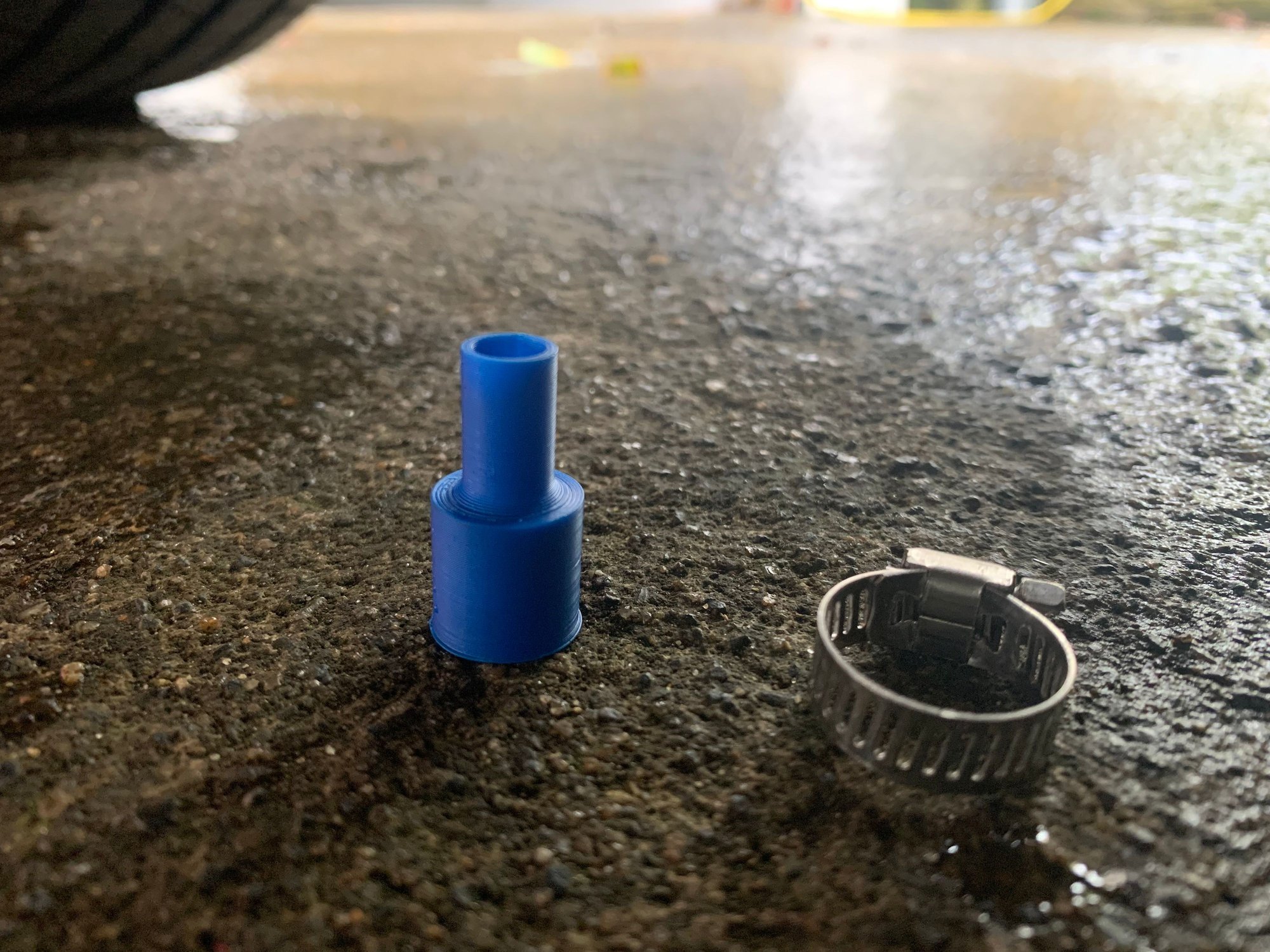

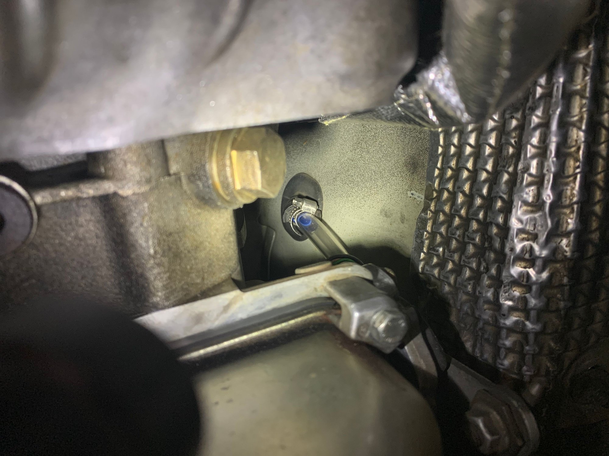

Hey everyone, I've been a long time reader, not posting though. I read about some problems with the AC drain plugs dripping right onto the driveshaft on one side and the electrical connectors for the trans on the other side. I figured I would attempt to alleviate this problem by relocating them. I never had the drain 'nipple' in mine, just rubber tube going into the car. I 3D printed some little adapters that just slide in the rubber piece that's already there and used some random hose I had to redirect the water somewhere else. I haven't used them the car on or been out on the road, but it seems promising. Lemme know what you guys think!
passenger side
driver side. I zip tied the hose to some linkage on the transfer case making sure there was always a downwards slope.
