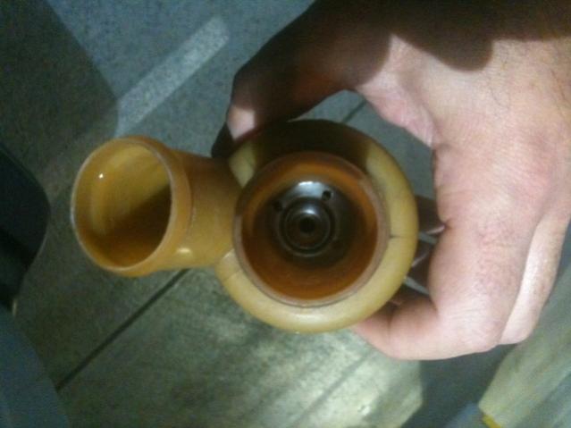

X2 with above. The thermostat is a "bypass design" that allows flow to heater core at low RPM, but at high speed the opening of the main stat forces the bypass disc closed. If during the work the sludge in cooling system was allowed to dry out, you could have blockage in both heater and radiator.
You can reverse flush the heater core with a garden hose. See https://landroverforums.com/forum/at...025_105723-pdf
Can also have crud from inside the system blocking the holes in the bypass disc.
