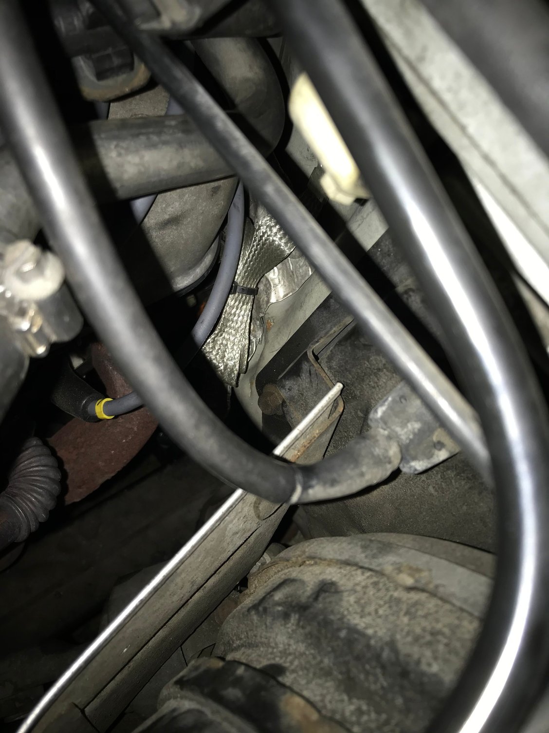

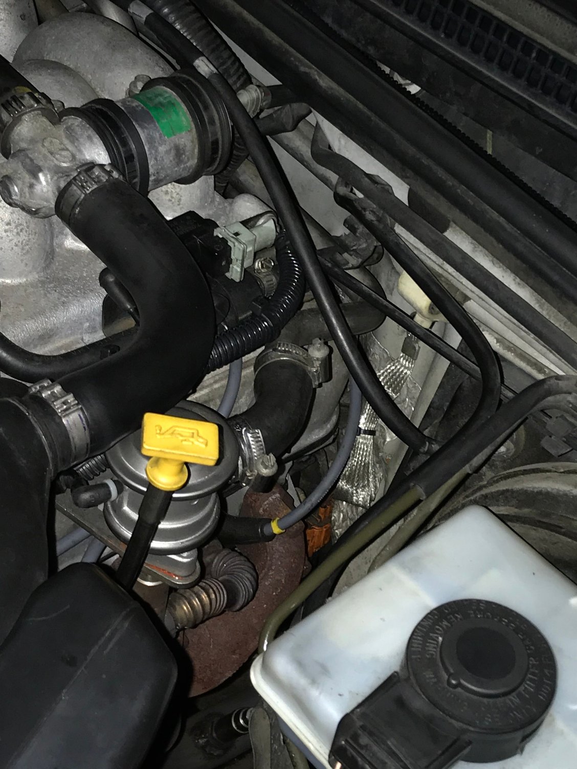

If anyone else sees this who has an ‘04. Can they please check their drivers side valve cover and let me know if it has a ground wire. Thank you
I have an '04. This is the only ground I seen at first look, which looks like its behind the valve cover on the driver side firewall. Is this what your looking for? PM me if you want more pics.

Thanks very much. I think all of my grounds are intact then. I was just reading another post that spoke of a valve cover ground but perhaps that only exists in certain markets.

Interesting. I have an 02' and I don't have that ground anywhere on my engine. Don't have the one from the valve cover as well. The only ground I can find is the one from the negative battery terminal. Does anybody NOT have a ground wire like me? Wonder if I add a ground if it will fix my gremlins.

My '99 had a single wire on the passenger side from the back corner of the block to the firewall. Hard to find unless you know it's there or you're doing the head gaskets. I remember in the Atlantic British video they said that some trucks have one on both sides, some have one side, and some have none -- without any apparent reason for the difference.
I don't think there are any that go from the actual valve covers. That wouldn't make much sense as they are insulated by the rubber gaskets and there are no ignition components grounded to the outsides of the covers.

that's strange. i just went out and looked at my '01 and it has the ground strap on the driver's side going from the block to the fire wall. both my '04's have it as well.
