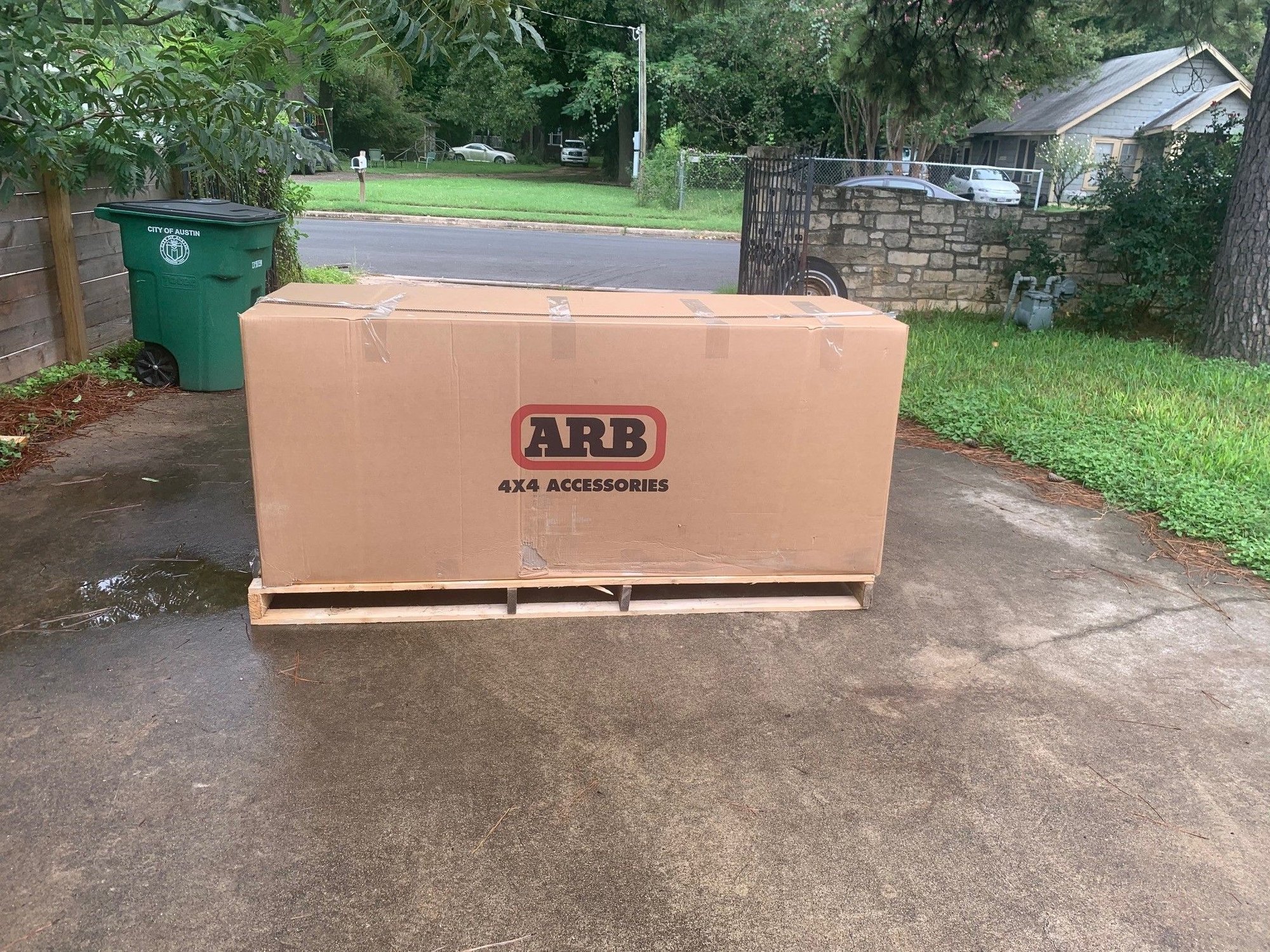

ARB takes their packaging very seriously!!! I should have an update soon.
