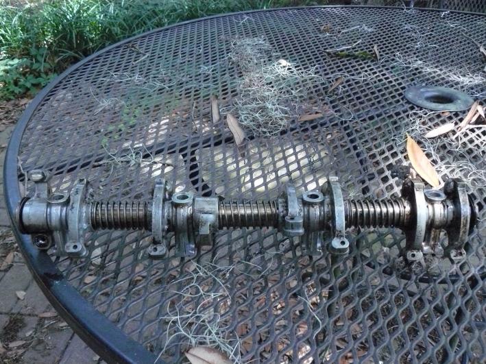

If you can pull them up (later in life they get mushroomed and can only leave by removing the cam). If you were to keep up with which lifter and pushrod went in which space, I would think you could soak the lifters in a strong cleaner, like Berryman's parts cleaner, which is under $20 for a gallon can with a plastic dip tray. By keeping the same lifters, in same position, you could avoid problems. And you haven't dismantled them. New lifters are crowned and wear down to match new cam. I would suppose that either cam or lifter being new could make the other old one wear in an odd pattern.
So we assume you took one apart that is not in your truck?
If truck is still all together, you could listen to valve covers with a yard stick to isolate noise, then with valve cover off and at idle, press on rocker arms to see if noise changes. The idea being you locate the approximate area of the problem.

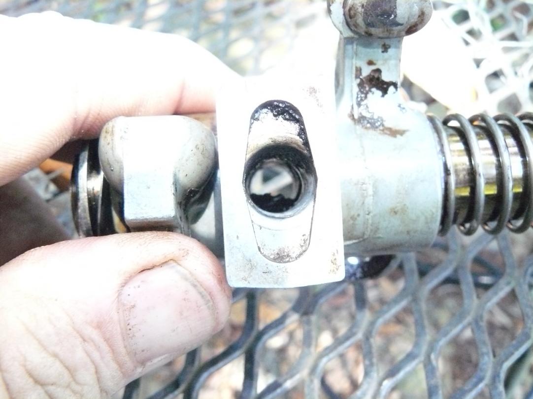

Valve train can have all sorts of gunk problems. You can also look those over first, just by removal of valve covers (intake usually has to come off as well). The rocker arms squirt some oil out of the ends and it lubes the push rod, drips along it, and lubes the top of the lifter. Of course lifters have their own oil port in their body. Three of mine had gunk blocking some of that little hole in the rocker arms.
