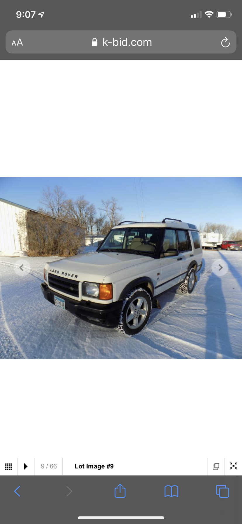

Hello,
I purchased a 2002 Land Rover Discovery 2 this morning, from an online auction. The vehicle is “cosmetically” in excellent shape, and has 136,000 miles.
There was little information available on maintenance history, the listing offered several observations of “It Runs & Drives” “The breaks are a little soft” and “appears to be an exhaust leak”.
I expected to inherit some gremlins. My expectations came true.
The most concerning issue so far is that the vehicle will not accelerate hard. Putting the pedal to the floor, will stall out rpm’s and the motor will dog. Applying a slightly less than aggressive acceleration, the vehicle will slowly but relatively smoothly accelerate until Approx 50mph where it then begins to sputter and miss.
Applying a very slow rise in acceleration, there does not appear to be any major concerns and the vehicle will run out to 65-70MPH without much hesitation.
The check engine light, brake light & fluid level light are all currently lit up on the dash. At one point on the maiden drive, I thought I smelled antifreeze & maybe had some white smoke. Perhaps I’m paranoid, it is also below zero here today in central Minnesota. I don’t have to rely on this vehicle for day to day transportation, so would rather fix the issues and not create more damage, if possible.
More often than not, I rely on my Dad who has been a lifelong auto-diesel mechanic to diagnose problems, he then tells me what to do, and I do the work. I do have him for back up, but this time, on this vehicle, I’d like to see if you all would mind sharing some insights?
Thanks,
WheresMarv

Nice looking Disco. You’ll get lots of good help here. There are way more experienced LR people here than me, but I’d start by hooking up an OBD2 reader and see what fault codes you have.

congrats on buying that Disco -nice looking truck a few things should be looked at before using it much:
