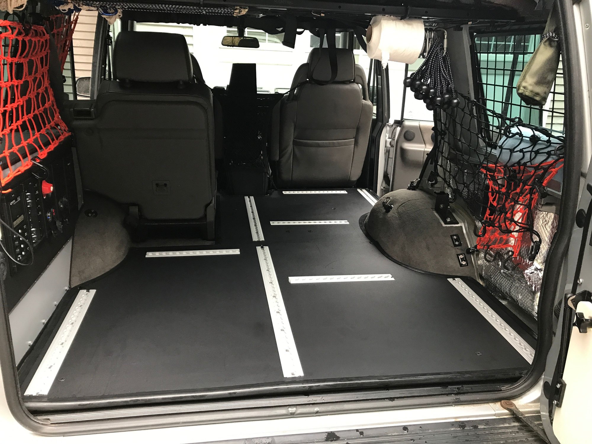

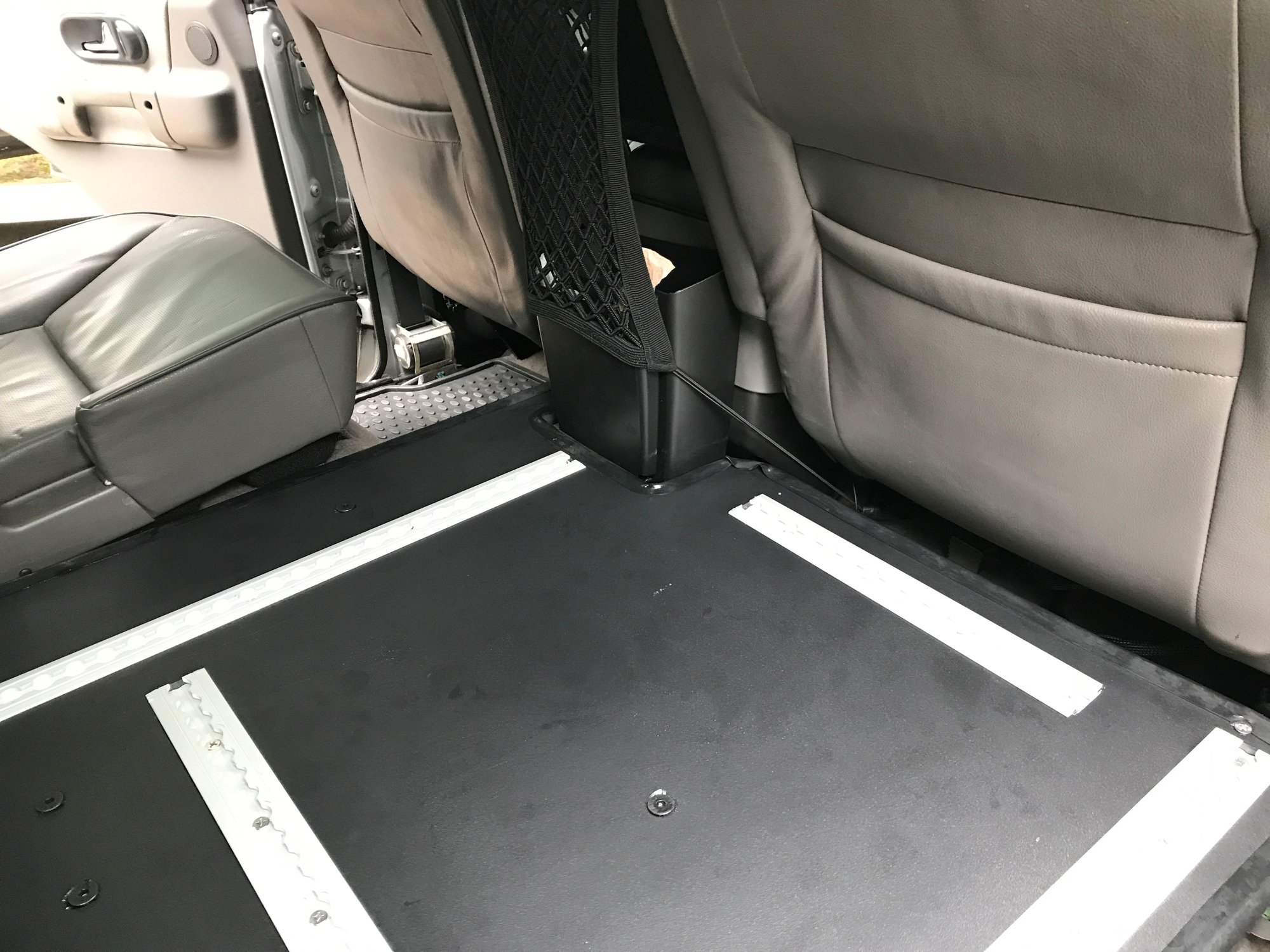

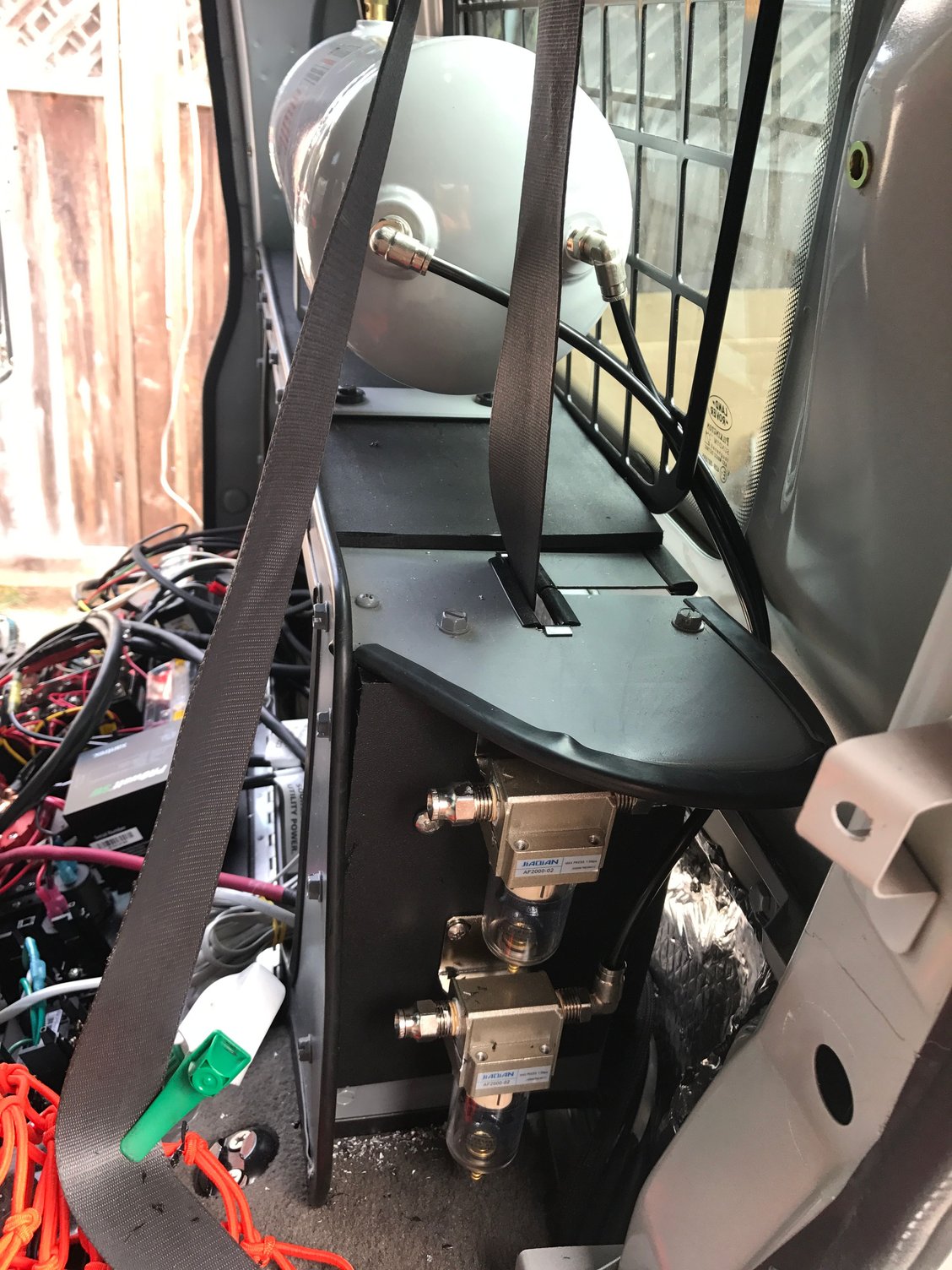

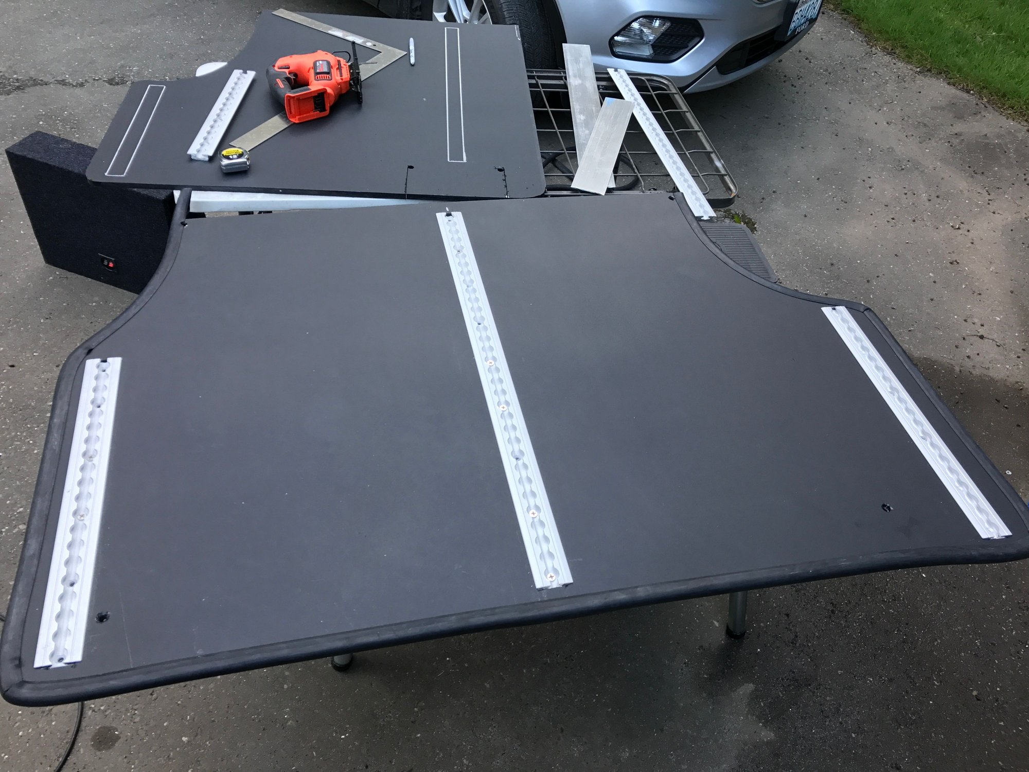

I've done a fair bit. Gutted everything more or less, and did this:

Awesome. That is why I asked the question about load space mods. I am a backpacker but I am doing a lot more Rover camping now. You are awesome Jeff Blake. I am around a lot of RV campers. I am a Fed Park Ranger for the Corps of Engineers. We see a lot of the big rig campers, but I have not seen a true SUV off road rig. Only nice rig I have seen at my project, A couple from New Zealand had shipped their Modified Defender 110 over to the states and were driving it to South America. It was truly a beautiful site. The 110 had a roof rack with pop up tent.
