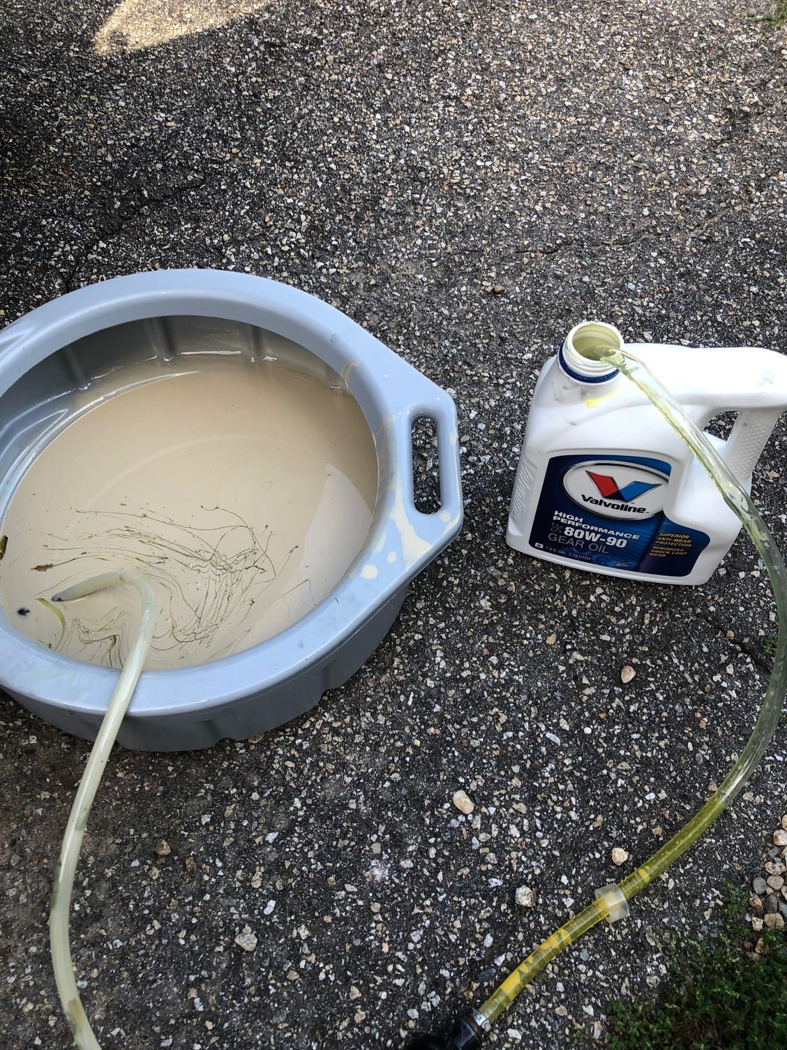

3. I recently changed the rear differential fluid and unfortunately it came out looking like this:
Obviously this is an indicator of water in the diff. I didn't really have the time to figure out how I was supposed to properly flush this, so I drained it as much as I could, flushed it a little bit with new oil (leaving the drain plug open), and then refilled with new fluid. Presumably it's not yet in good shape, and there is still a milky color in there. What's the best way to deal with this - continue to flush with new gear oil until it starts coming out? I'd prefer not to open up the diff unless absolutely necessary since the gasket seems to be working at the moment.
Jack up one wheel at a time, fluid will run to the center. You should be good after that. Looks like someone submerged the axle, there should have been a vent tube on the axle to prevent that, you might want to check for that.

3. Flushed and working fine now.
