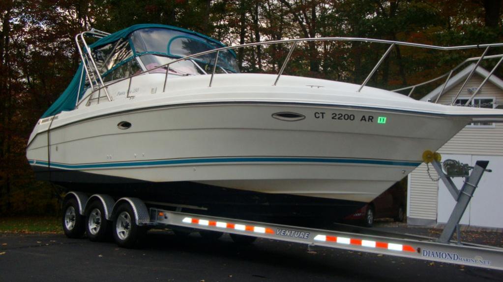

Incidentally, whilst driving to work today, I saw a Jeep Cherokee Laredo 4.7L (looked like a 2003 model) pulling a twin axle trailer with a 28ft motor boat. I followed it for a good 3 miles and it didn't seem to have any issues pulling, braking and going over the 'up ramp-flat-down ramp' type speed bumps. This guy was going 60kph without any trailer swaying which really makes me think my D2 can do the job.
Now, I have no experience in towing but know basic physics about inertia and momentum and I believe (granted with no expert knowledge) that, driven sensibly with caution, the D2 will do the job for short runs upto 20-30kms, driving no more the 40kph.
I also think my D2 will need some upgrades if the engine and drive train is going to last.
With regard to cooling, I agree with Spike, with my location, there will be some cooling issues. I was thinking of replacing the radiator with a specially made deeper core one which should improve cooling and and using a couple of bottles of water wetter to bring down the temp.
I asked the previous owner about towing the boat with my D2, as he has experience and this is what he said :
'Engine power isn't the issue. Stopping is more critical. As long as no big hills or long distances you should be fine The trailer has surge brakes and with the long wheelbase is pulls very nicely. You'll see in the picture that I have the trailer adjusted back to balance the tongue weight. It's happier behind a pickup in Connecticut as we have lots of hills'
I've attached some pics which should give an idea of the trailer tongue ( I could not attached them previously for some weird reason)
Mike - I'm not set up for Skype but i'd appreciate it if you could send me your number and I can call you. If I do the mods/upgrades on the D2, I have a Landy garage here in Dubai with boys from the UK that are half knowledable with the RR/Defender/Disco .
