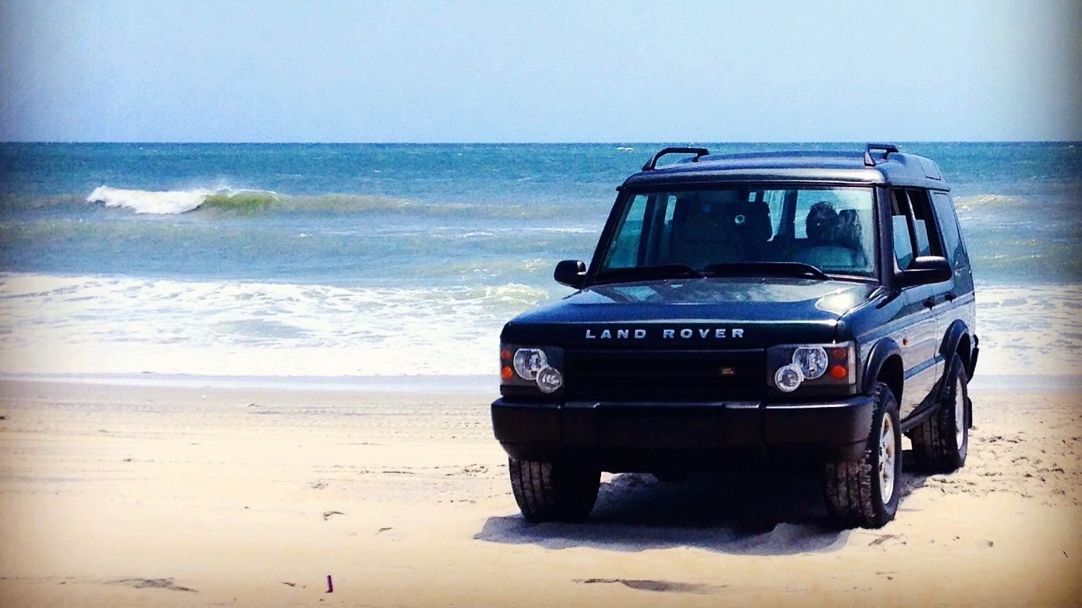

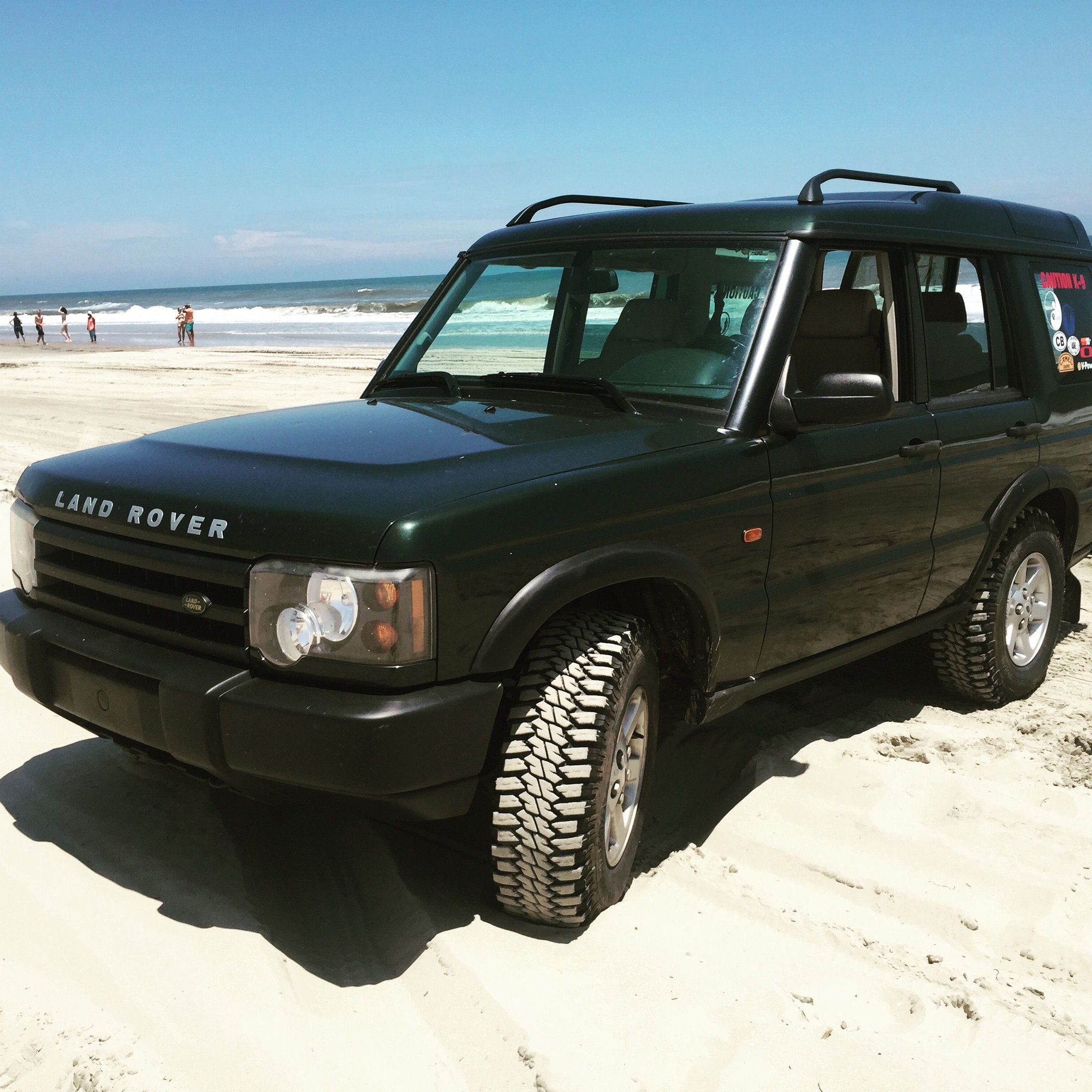

Never had any issues with the traction control and sand, that is the majority of the off roading I do. Hell I took mine on almost bald tires on the beach and all I had to do was air down. I would suggest airing down the tires if needed or even getting a more aggressive tire before you try messing with the traction control and completely messing up the braking system of your truck. Anyways here are some pictures of mine on the sand, first pic was with the bald tires.
