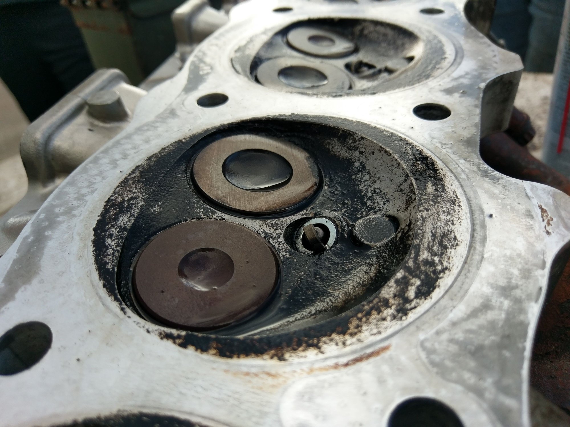

Hi everyone thanks for looking and thanks for the help in advanced. I was taking the heads off of my D2 after I took them off I noticed one valve on each head was noticeable off sticking lower than the rest by about a 1/4 and saw where it was slapping the piston, not sure what to do to fix this any help would be appreciated. It's a 2000 Disco with a 4.0 and 82xxx miles. Here are some pictures of it. You can see its noticably raised.(passenger side head)

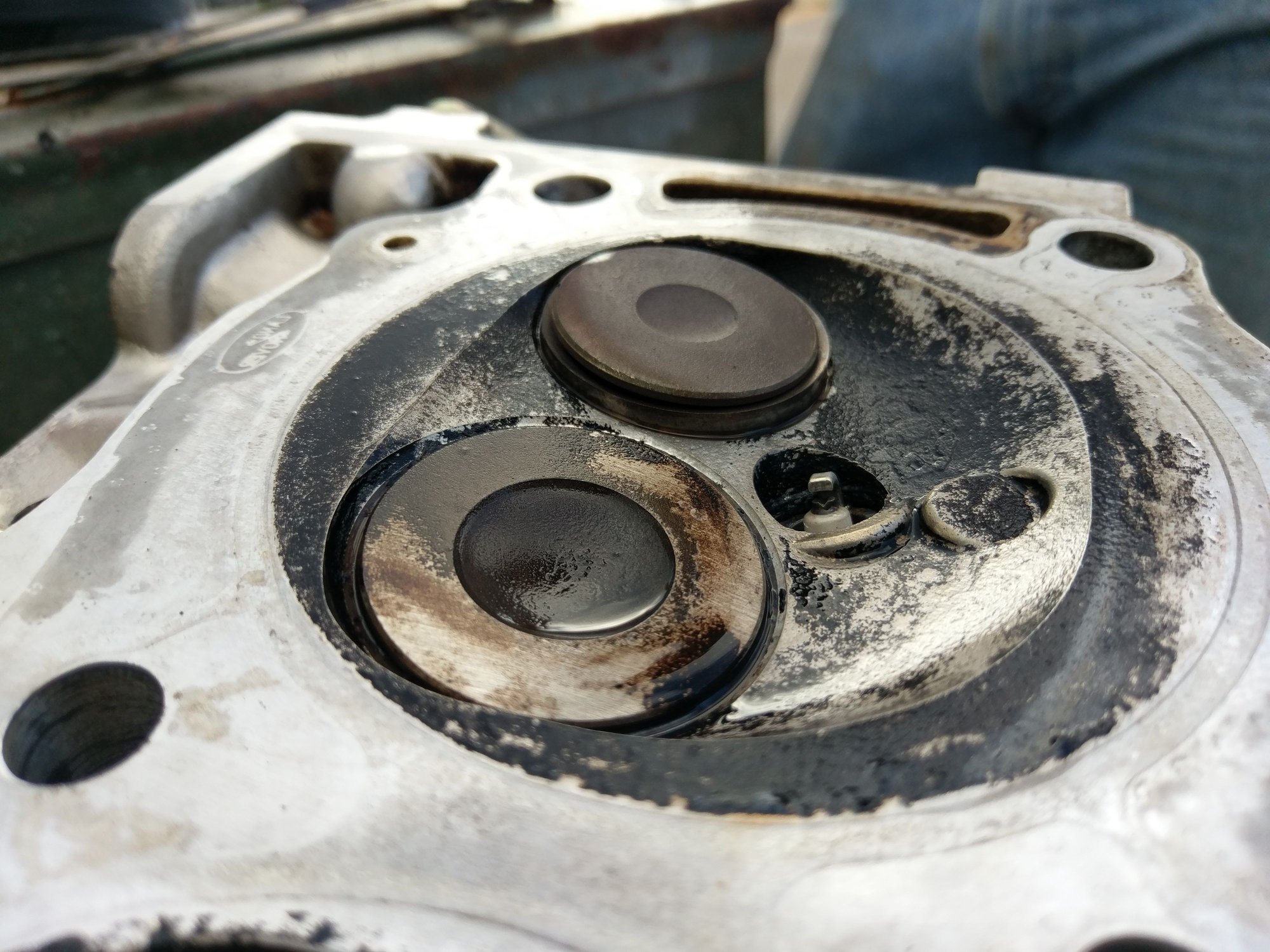

Here how i belive it should be.

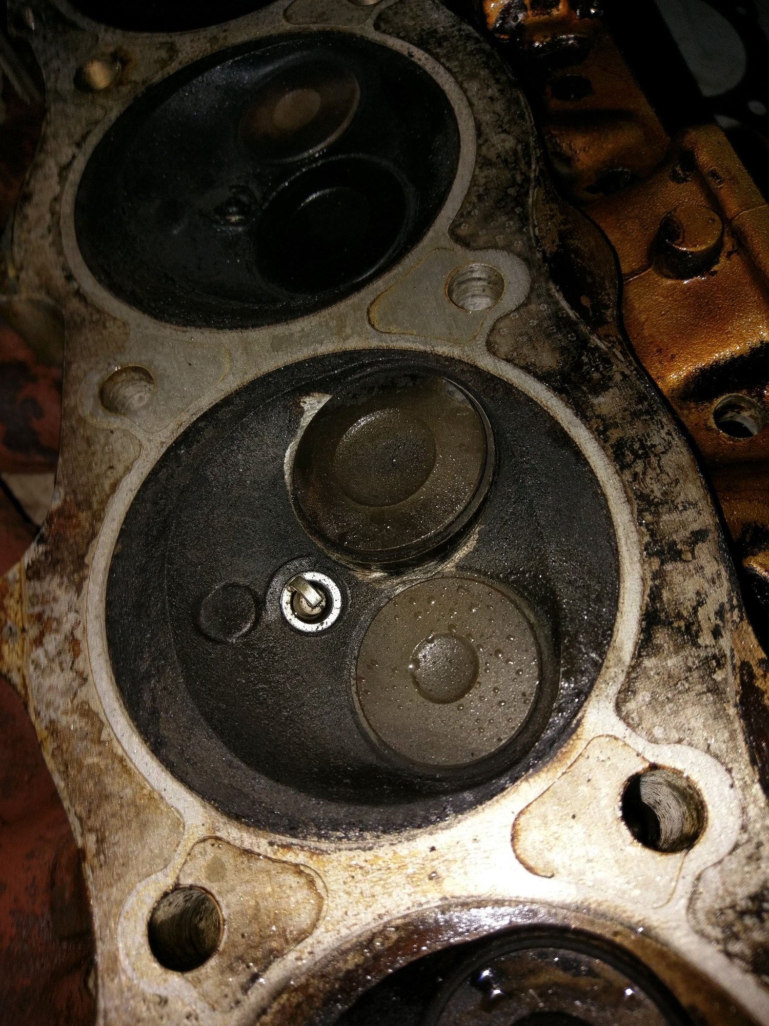

This one is raised as well and seems to have fourmed a burr, i do wish to fix this before putting the heads back on(driver side head).

The valve seats have become loose. I'd take them to a machanic shop and see what they think. The heads may be junk, if they do not hold a seat anylonger. Weird, that they would come loose...has the engine ever been overheated?

Just looked at the pictures better, enlarged, and those heads are most likely junk/scrap. Didn't see the marks in the last photo originally, or oblonged seat in second. There is no way I'd put those heads back on a vehicle, even if they were re-done. If they didn't hold the seats after 82K...they sure as heck would be suspect to doing it again...even if they staked the seats afterwards.

Truth be told...in my 40 some years as being a mechanic...I've never seen such a thing. Usless the engine was heavily overheated or something. But, for you to say it never was (overheated), I'd have to assume there is a defect in the head itself...and me...I'd have a hard time investing any faith in those heads. Especially, if any of those seating areas in the head are oblong or heavily distorted. To much work, only to have to do it over again later.
Now, with that being said...a second opinion never hurts...especially one that can actually feel/touch/measure such issues.
Me, I'd be on the phone setting up delivery of a remanufactured set of heads. You're in the Navy...they must need anchors around there somewhere (old heads).
