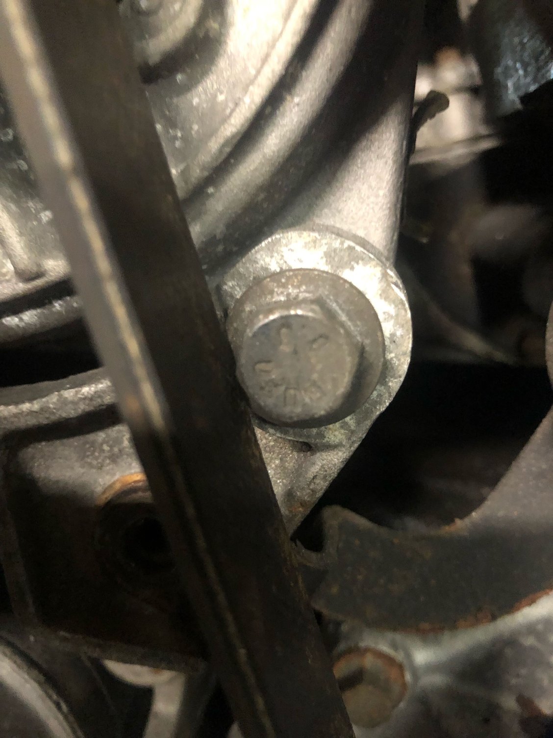

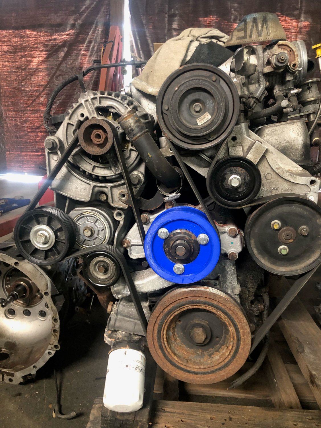

Here are some pics of the overdrive water pump pulley on an engine. It looks good - the belt is lined up and tight. The tensioner seems to have taken up all the slack. The only issue is the alternator bracket bolt which is touching the belt at one point. This bolt will need to be either cut / ground down a little bit to give the belt clearance or just replaced with a different bolt.
I have another pulley coming that will be made from Nylon. It should be able to survive the engine heat and mechanical pressures, so it should be a good candidate for a test run.

Could that empty hole in the alternator bracket work to install a smaller pulley to move it away from that bolt? Not sure if that hole is threaded or used off the top of my head, but maybe something to consider. Maybe a 30-50mm pulley could work out right there

My current plan is to replace that current alternator bolt with a low profile allen/hex bolt. If that doesn't work then a little pulley would be a good solution either on that bolt or the alternator bolt.

New pulley made out of nylon. Very clean print. Looking forward to seeing how it does.

Glad to see progress being made. Can't wait to see some test results. Have you found a low profile/button head bolt that'll provide clearance for the belt yet?
