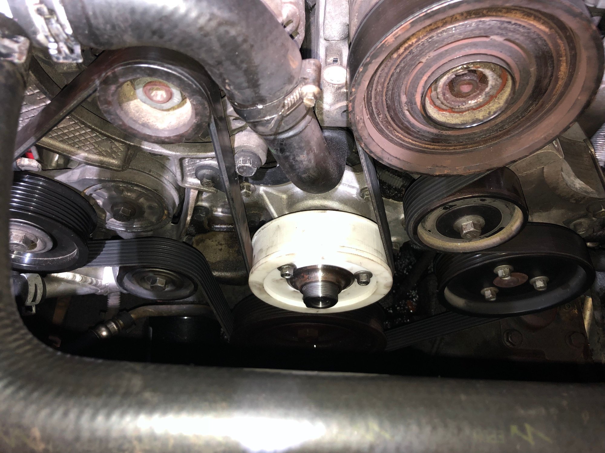

New pulley made out of nylon. Very clean print. Looking forward to seeing how it does.

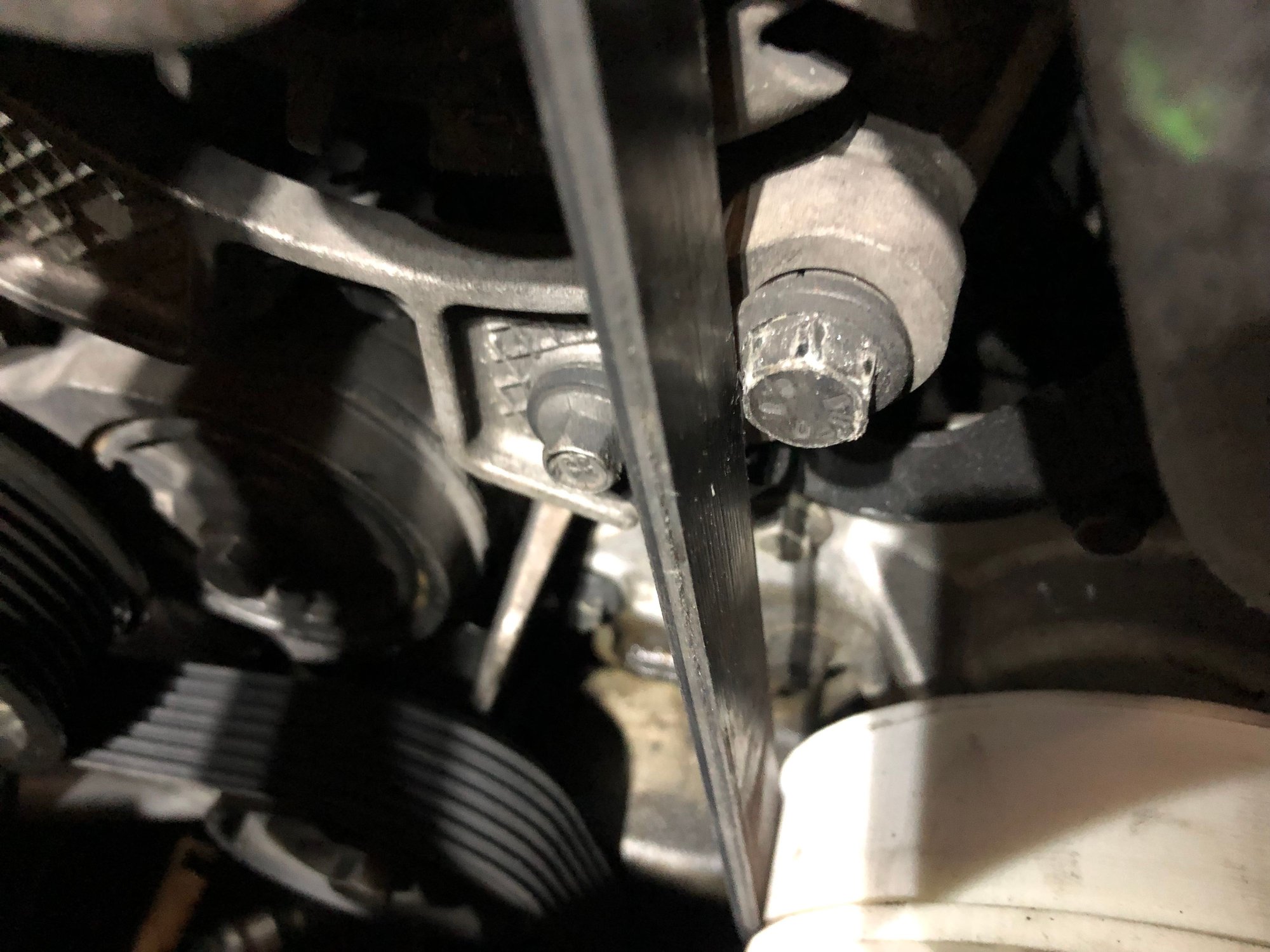

New pulley fits good. No cleaning up the print was necessary this time. It actually does not hit that alternator bolt anymore. I might just start looking for the same bolt with a smaller head. Next up will be some testing. The nylon should be good enough to run with for a little while.

Wonder if this style might work. This is on the Summit Racing site. https://www.summitracing.com/parts/b...hoCLOsQAvD_BwE
Ooops! Just noticed it's for body panels so probably not stout enough. Maybe a hex head cap screw with washer.

So, a follow-up. It's been a while, but I finally got to test this today. Belt fit and pulley fit was good. The tensioner took up the extra slack as expected. It was cooler out in VA today, but I could still tell the water pump was moving more water. It took a little longer to warm up. The temps settled around 188-190 with a LR low-temp thermostat. I put a few minutes of run time on it. Problem was that after a few minutes, the nylon heated up and bent back a little, which allowed the belt to slip backwards and start squealing. The alternator bolt was a small problem, however I was able to turn it a little and the belt stayed away before it jumped. Overall, I am happy with the performance of this prototype.
I am sort of between two options - option 1 is to recreate a stronger, thicker pulley out of nylon. I was impressed with the strength of the 3D printed nylon pulley. I am sure the nylon would not bend significantly if it was thicker. That option is about $70 for a one-off, but I still wonder about longevity. Option 2 is to CNC the same pulley out of 6061 aluminum, which definitely won't bend. Downside is that it's about $270 for a one-off. On the plus side though, if others wanted them, I could get them produced in bulk for a lot cheaper.
