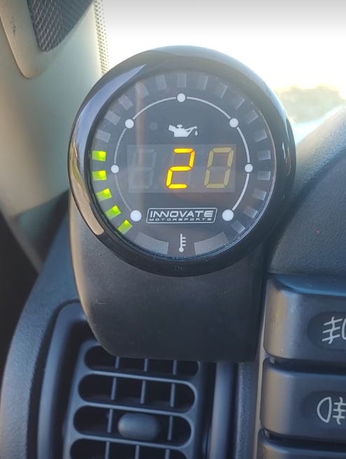

Tee fitting will work, I have done it. I have used the innovate motorsports MTX-D oil temperature and pressure gauge quite a lot as it has programmable alarm (flashing oil pressure numbers or flashing led's for temperature. I use the oil temperature sensor for coolant temperature, works fine. https://www.innovatemotorsports.com/...mperature.html If you have an 03-04 you can use the unused oil cooler port (LS engine oil pressure adapter works), on a 99-02 you can also use the plug higher up. Fits nicely in our new gauge pod.
https://extinctmotorsports.com/adjus...gle-gauge-pod/
