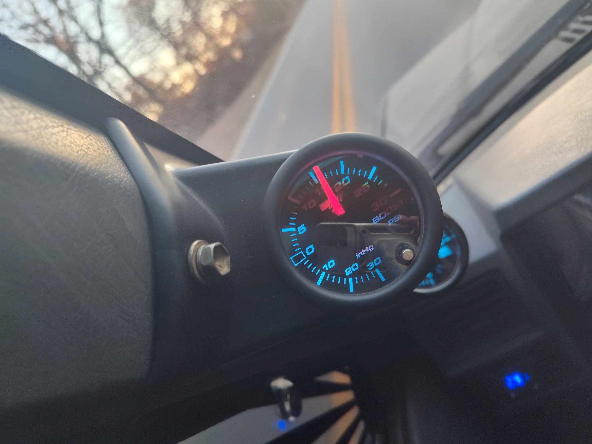

I've not had any luck with cheap sub 50 dollar boost gauges with electric sensors in the daily driver. Been through two of them in 2 years time. The electric sensor 52mm oil gauge has, knock on wood, been great. I now run a glow shift boost gauge.
Yeah I run the same cheap Chinese boost gauge in my boat for the past 5 years without an issue.
So far the Disco has only gotten glowshift gauges however in the past I've always had good luck with auto meter.

Forgive me as I forgot it's in proper to post a picture of a boost gauge without a reading at least 10-15 lb
