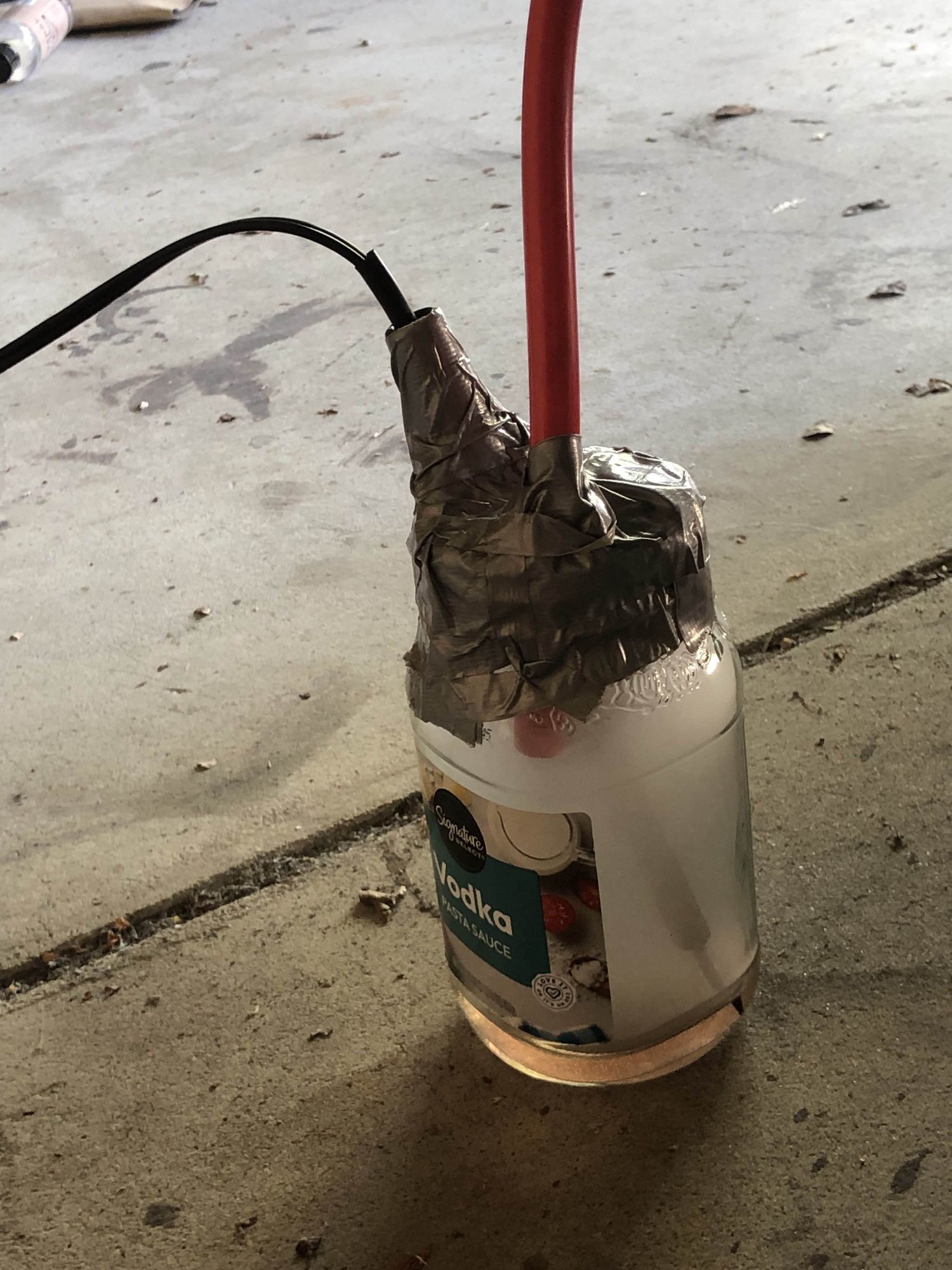

Building the smoke machine
1. Pour enough mineral oil so that it is about half an inch deep in the jar.
2. Put the (cold) soldering iron in diagonally so that the tip is in the fluid and touching the bottom of the jar.
3. Tape the hose from the transfer pump to the side of the jar a couple inches deep. Make sure it doesn't touch the soldering iron or is in the fluid.
4. Using tape, try to make an airtight seal by taping over the top and around the soldering iron and hose. It doesn't need to be 100% airtight as you need air to get into it somehow, but taping it as well as I could still had enough of a leak to let air in.

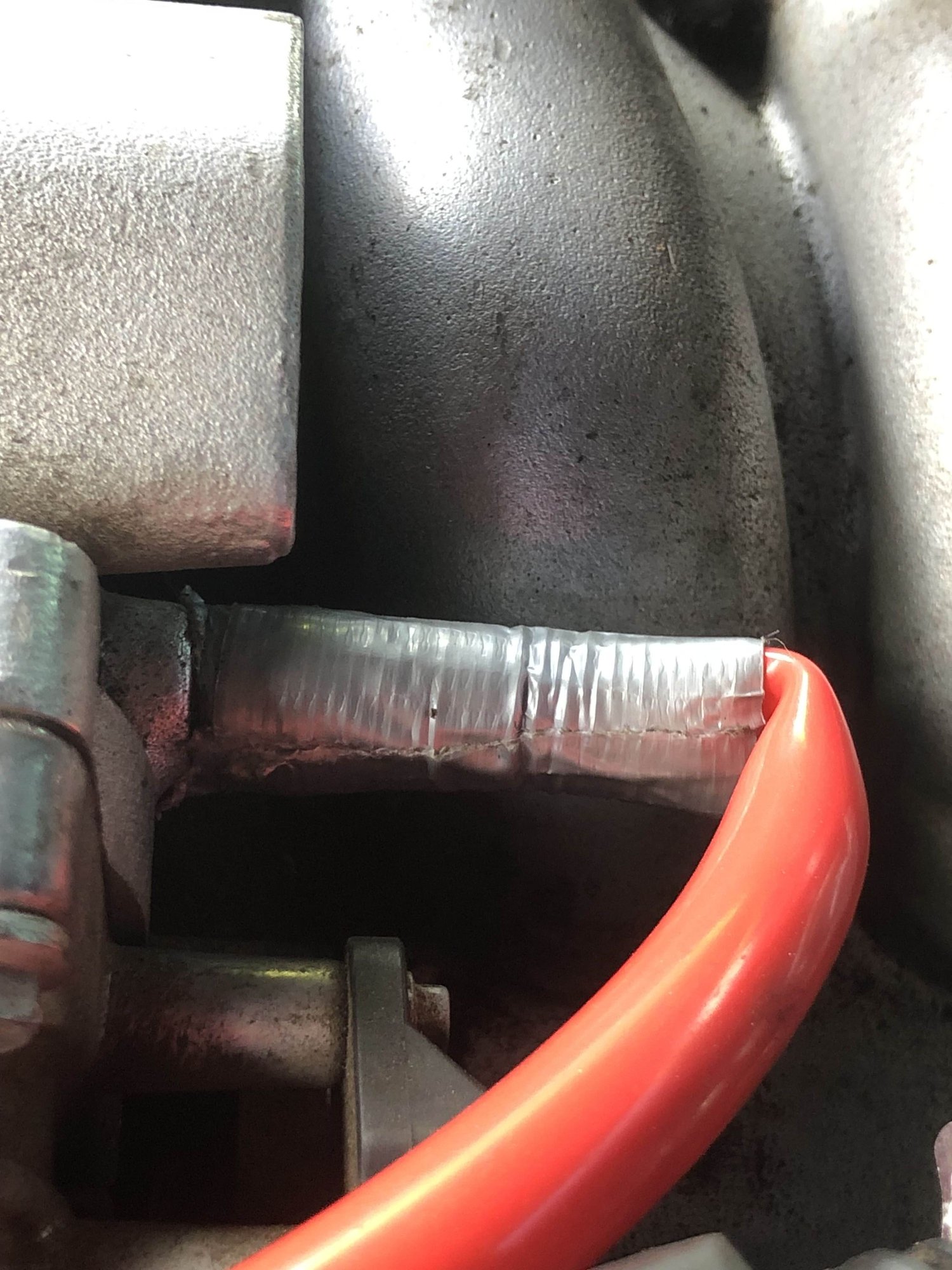

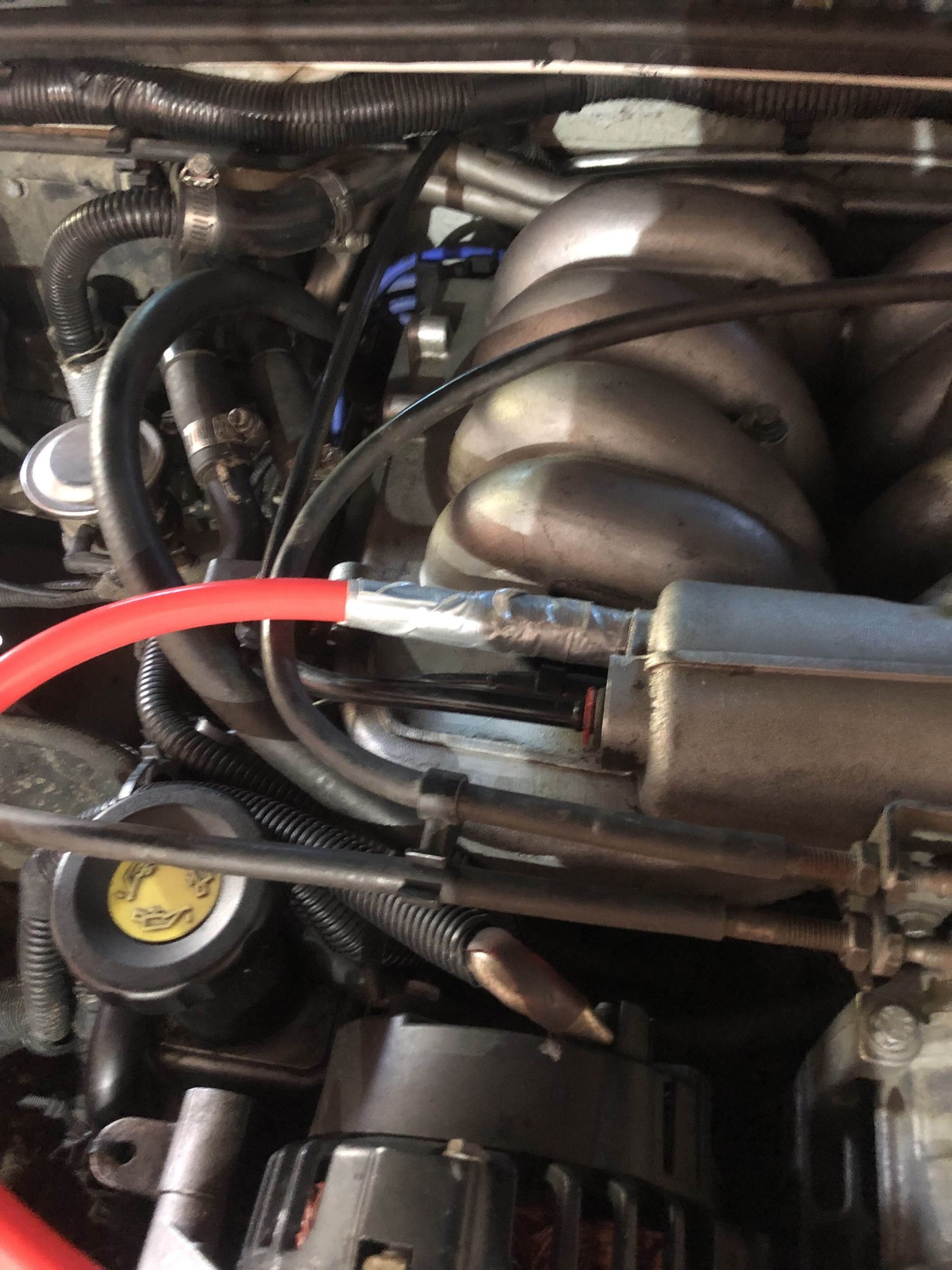

Plug in the soldering iron and the pump on the other end of the hose, and voila, you've got yourself a smoke machine. Make sure you connect the jar hose to the "suction" end of the pump. When connecting to the car, there are two ways that I have tried. Taping it onto the pcv nipple, or where the evap line connects to the intake. If you squeeze the hose onto the evap line nipple on the intake over that little ridge, it should create a good seal.
note the tape here is just because I couldn't get it off, and is not needed to connect to this evap fitting.

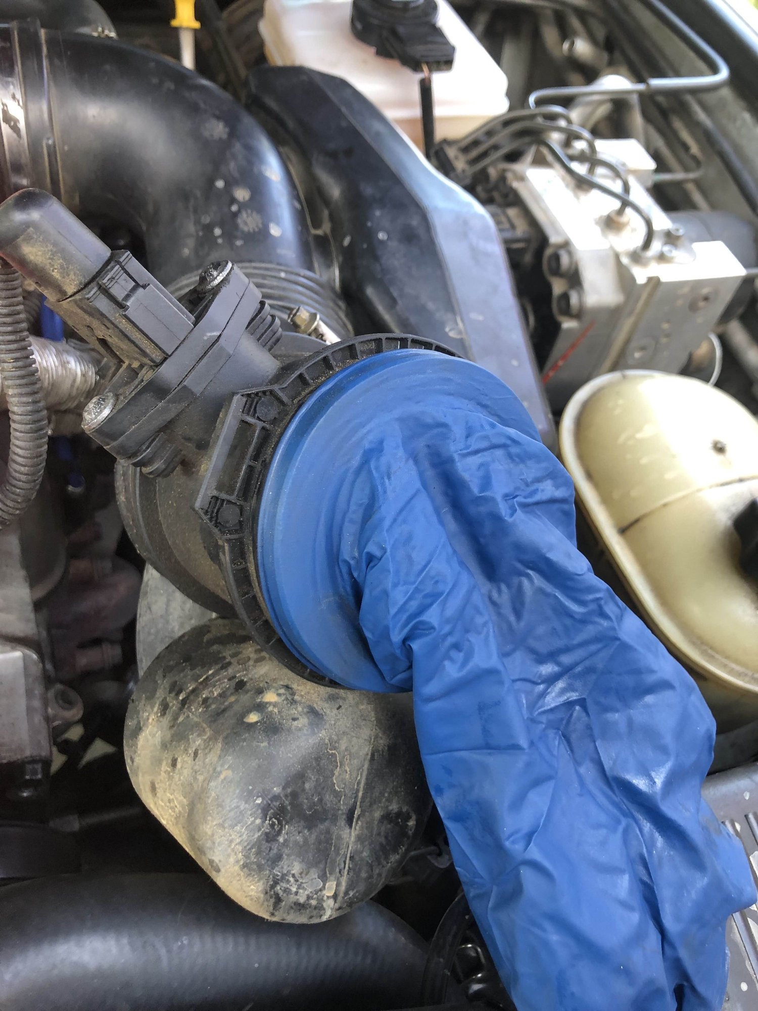

Disconnect the intake tube from the air box, and put a glove on it like so.

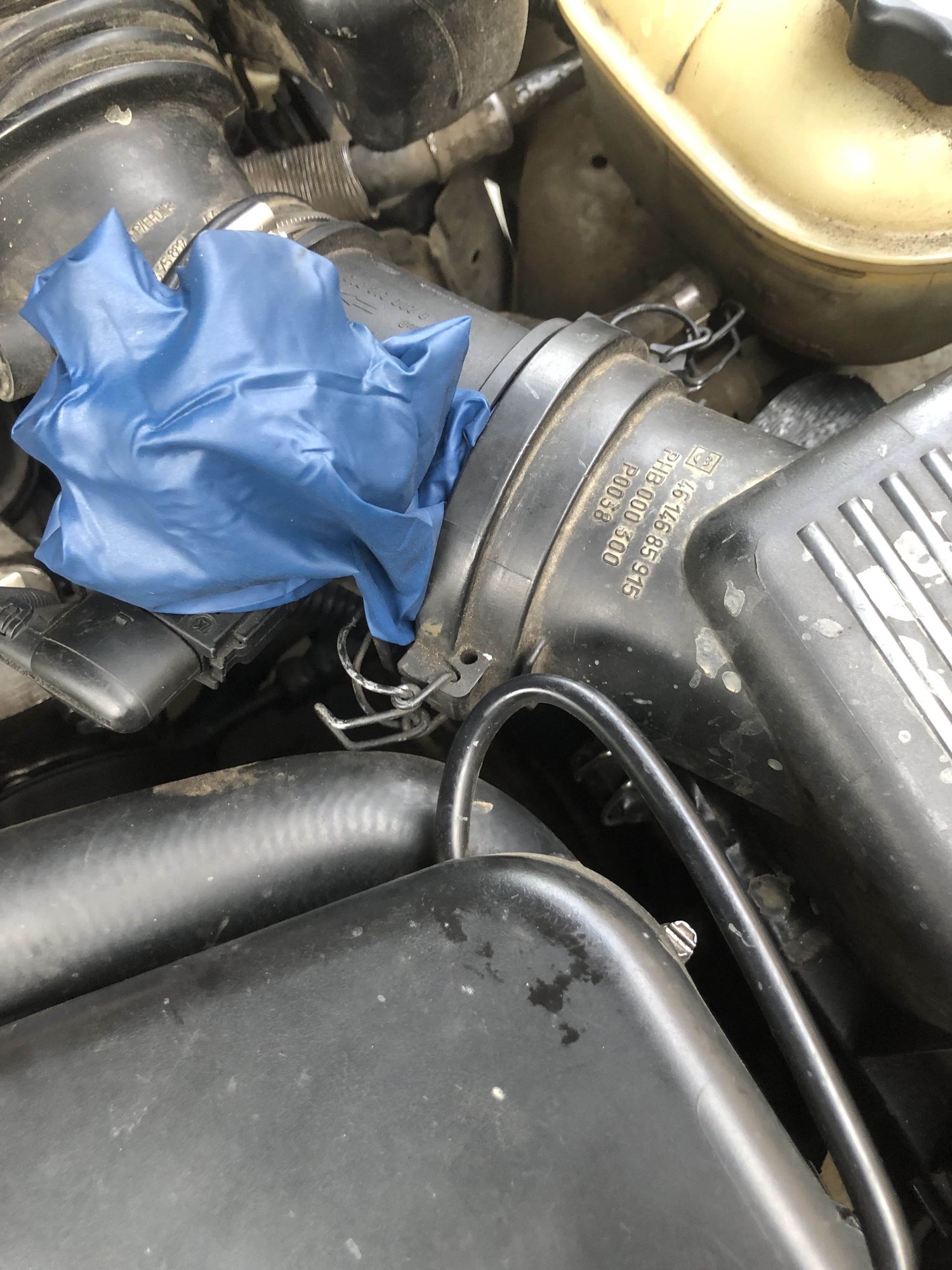

The glove should fill up as you use the pump, and maybe slowly deflate. If it doesn't blow up at all, then you likely have a very large leak somewhere. If the Glove keeps popping off, you can reconnect the intake hose to the air box with the glove still on like so:
