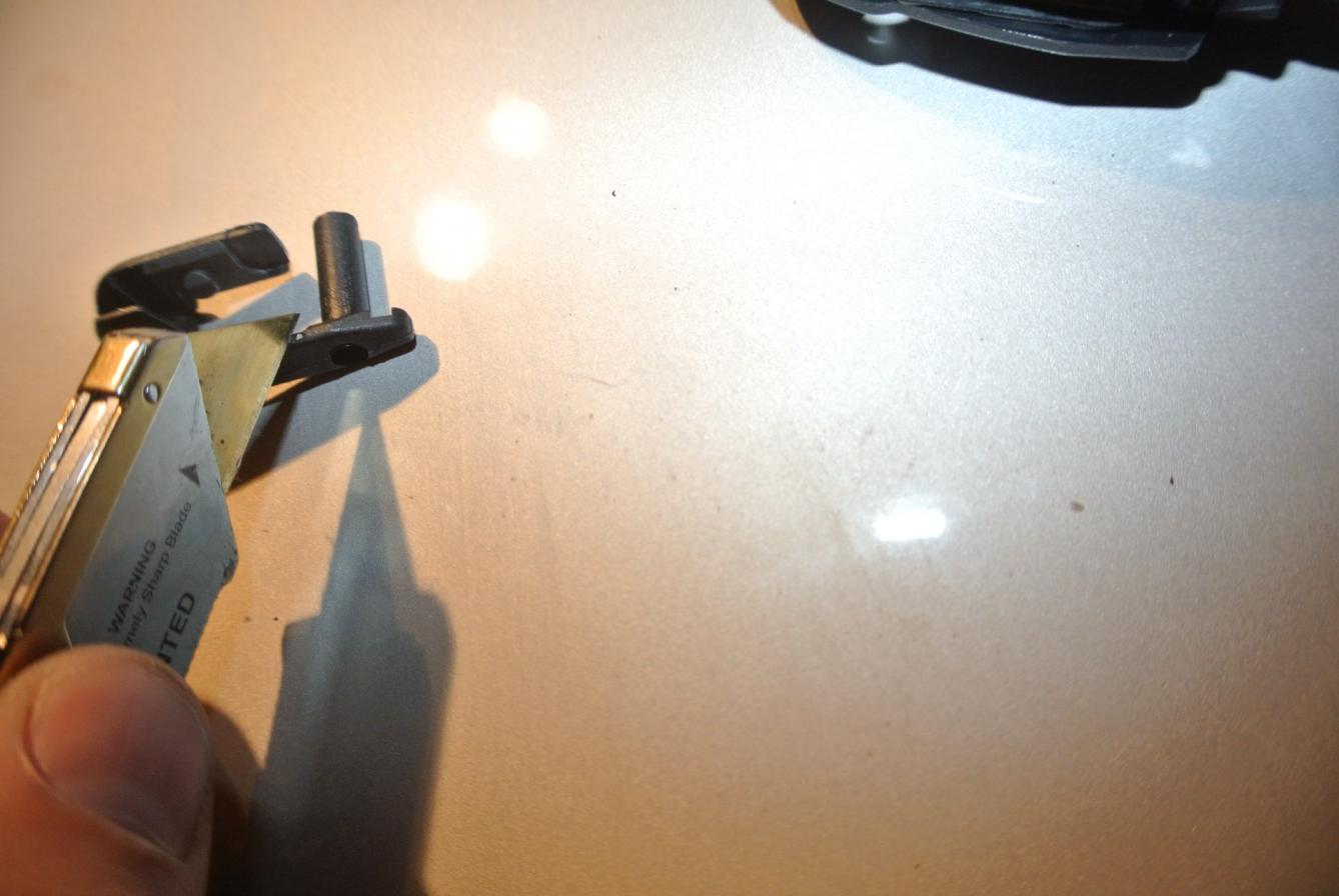

I just made a quick mod with a razor knife to the provided hardware.

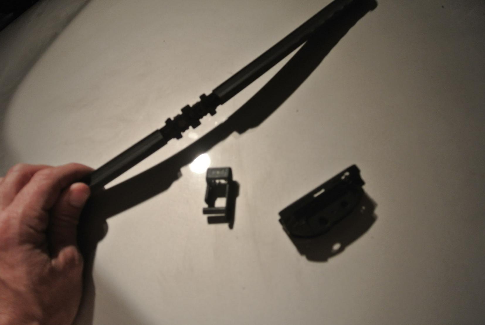

ok, I just looked in the spares box and I have my old rain x wipers so I can show a little on my technique. it may not be the same set up as op, but it was quick and simple.
the parts I actually used= 1st pic (there is some other application parts that are not needed)
the part I modified= 2nd pic/3rd pic

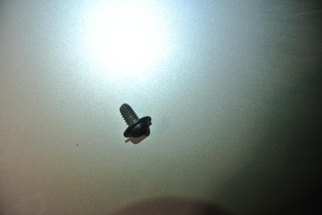

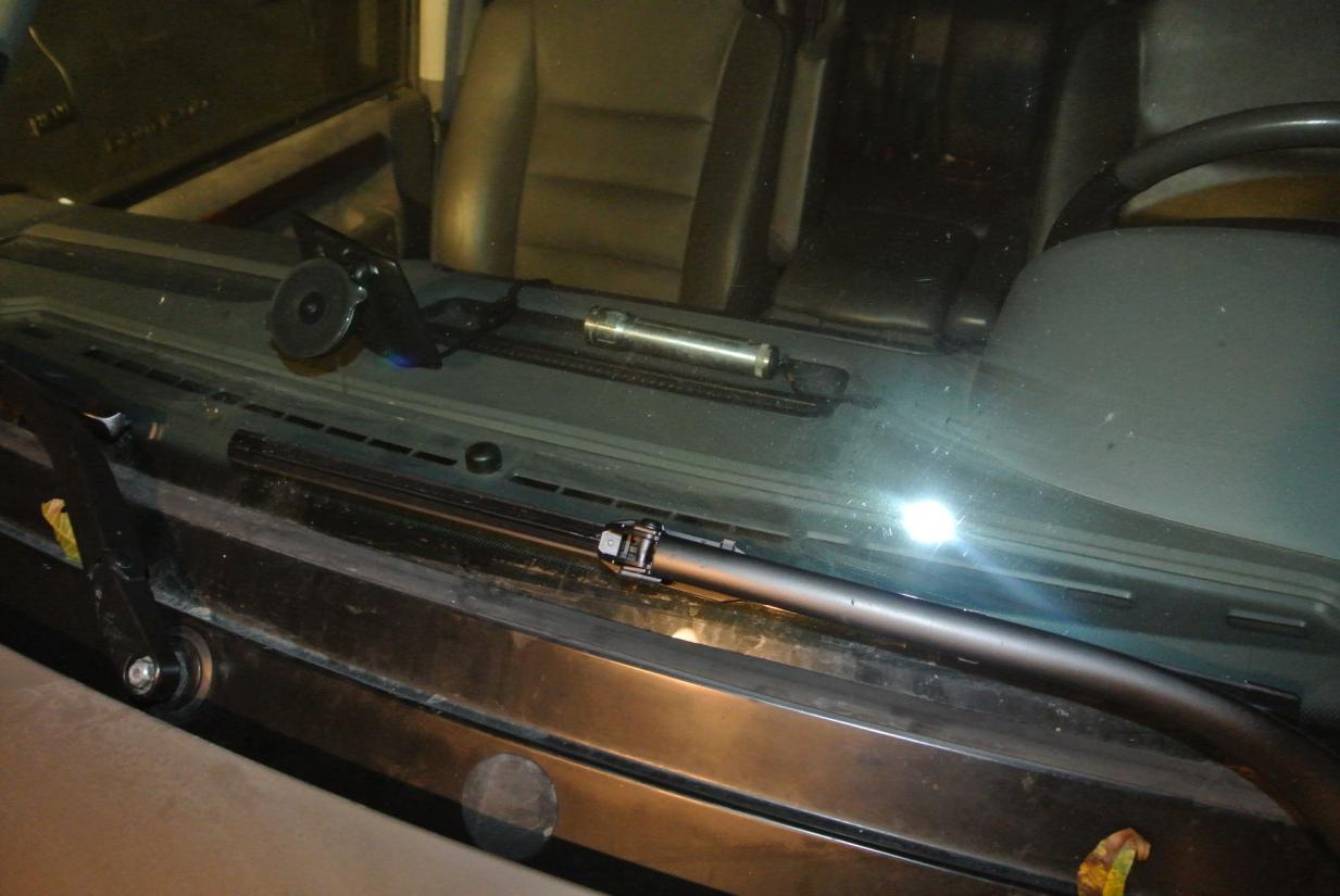

the screw I had was a 1/4" trim screw about 5/8" long(it came from somewhere on the disco, or I would not have had it in the box...original job was done in A.Z. parking lot in the rain ) =4th pic
the modified part inserted from the bottom=5th pic (could probably snap it in from the top and be done, but I used the handy screw for security)
Attached Thumbnails DIY tips for Rain X Latitude blades w/ DII arms.-dsc_0971.jpg   DIY tips for Rain X Latitude blades w/ DII arms.-dsc_0983.jpg   DIY tips for Rain X Latitude blades w/ DII arms.-dsc_0984.jpg   DIY tips for Rain X Latitude blades w/ DII arms.-dsc_0975.jpg   DIY tips for Rain X Latitude blades w/ DII arms.-dsc_0982.jpg

and finally I thread screw in and done
Attached Thumbnails DIY tips for Rain X Latitude blades w/ DII arms.-dsc_0967.jpg   DIY tips for Rain X Latitude blades w/ DII arms.-dsc_0973.jpg

Thanks. I got the Icons today. Where is the part in your second picture?

iirc, it comes connected in the slide frame thingy.

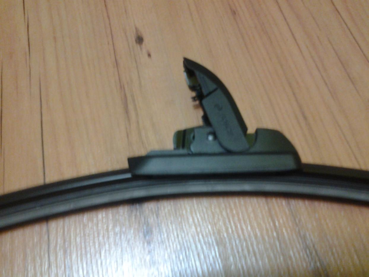

This is what I have.
Attached Thumbnails DIY tips for Rain X Latitude blades w/ DII arms.-20131023_171558.jpg   DIY tips for Rain X Latitude blades w/ DII arms.-20131023_171610.jpg

not sure....does that little flip up part, not have a pin through it? does the whole cam thingy atop the blade slide off, with a push of a button and slide forward? i remember it having little extra universal type parts, like the rainx, and sliding the blade from it's holder/cam thingy. hope I didn't steer you wrong

When you flip it up it has the piece for a j-hook to slide in.
