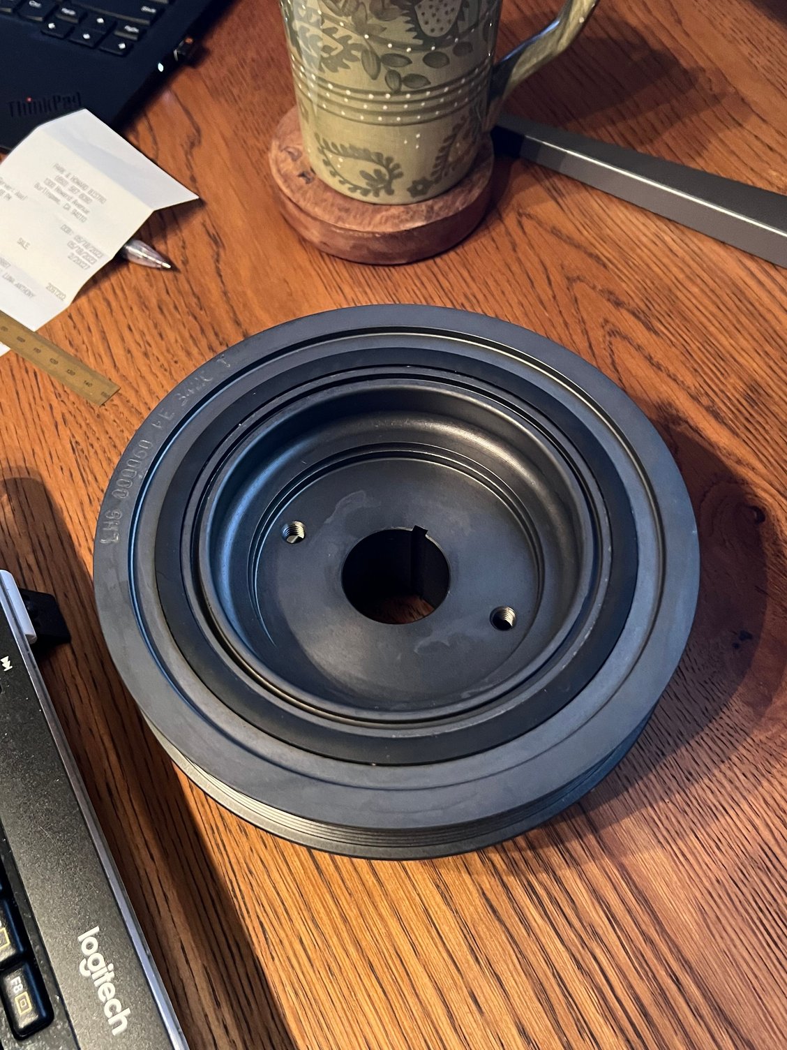

Ordered last week from Rimmer Bros - BUCK$!!!
She goes in with a new seal tomorrow.
Started the engine for a moment without the wobbly balancer to look at the crank - rock steady!
