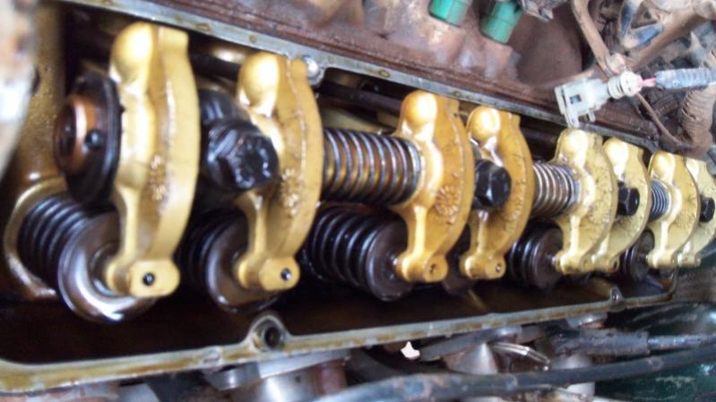

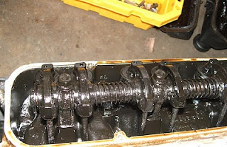

I have friends who own a salvage yard, and they will tell you the best way to kill a sludged up engine is to do a engine flush with a strong solvent.
Once you break all of that sludge loose it will clog everything, the engine will be starved of oil and it will seize.
This was a problem with some Toyota engines, they sludged up from improper oil changes and cheap oil being used.
Then someone else bought it, did a engine flush or took it to a shop for one, and it died shortly after.
They say the best thing to do for a sludged up engine that still runs well is to leave well enough alone.

Here's some pix - first one is a clean Disco with 180K from Street Wolf, a steady diet of Rotella and in the past Castrol, 3000 mile drain interval. The others, not even close. A couple of pix of ultra sludge in various other models. The one pix you can see the pickup screen being blocked by the gunk. Moral - use good oil frequently and let it do the cleaning job. Or tear it down to clean it, and you'll find lots of other bearing surfaces are compromised. Try to clean it all in 30 minutes, and you just might have more problems than you want. It would be really difficult to "catch up" neglected routine service with just a bottle of super solvent.
