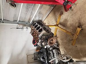

Oh, gotcha, and I don't disagree.
I was really leaning towards a bad liner(s), but after pulling the heads, I see no signs of it.
I still haven't had time to take the short block apart, but I'm now thinking it must be a bearing, or maybe, maybe even a piston skirt(s).
The tapping is nothing like a typical bearing knock, or maybe it's just how the sound resonates through the aluminum.
In a way I'm glad I have this problem, as I really want to know the cause. Hopefully I'll find some definate proof by the weekend.
I'll post what I find, with pics.
In the meantime, the engine is on the stand waiting.

Perhaps you can rotate the crank with an airgun and see if theres any messy sounds.

That would be/is a good idea, but the engine was quiet until it warmed up.

I'd doubt it would be piston skirt slap, since it does it more after it gets warm. Usually, you get piston slap on start up, and as the piston grow (expends from heat) it quiets down. But, you have the engine out...so you will be able to verify any of this by measuring bore and checking condition of pistons.
You'll know a lot more once you get that front cover off, too.
Hopefully, you find the smoking gun.
Brian.

I agree on the pistons.
I would also think they would make more noise cold than hot. The tap doesn't sound like pistons either.
It was in the article linked in this thread, so I thought it needs to be confirmed. I was going to measure them anyway.
I already replaced a cracked oil pump, and the sound remained, replaced the timing chain too, and gears looked new, so no mystery under the cover.
Flex plate looks new as well, and was extremely tight, so no noise there.
Hopefully today or tomorrow I'll have time to finish taking it apart. I need to go borrow some steel numbered punches from my Dad, so I can number the connecting rods before I remove them.
