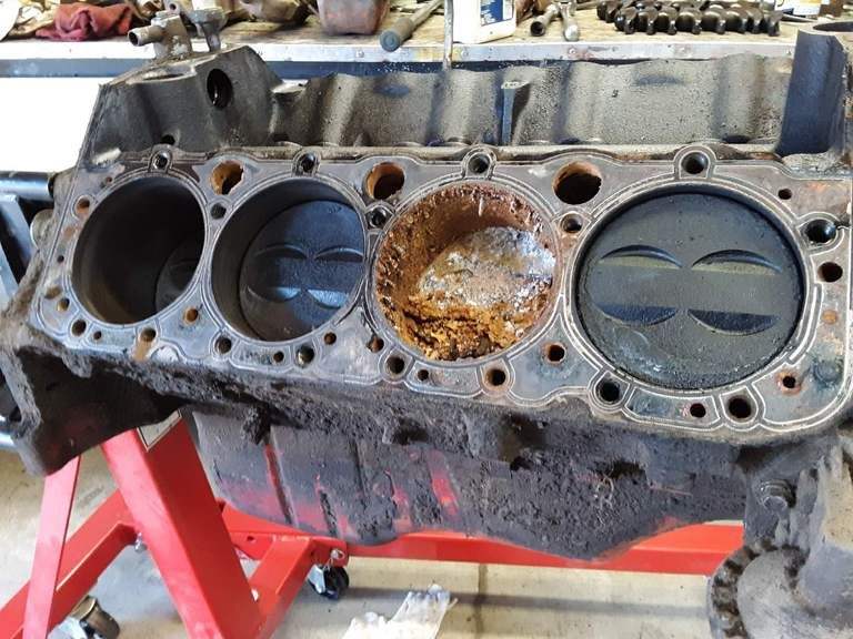

So for you guys who like to plan ahead and get a backup motor for your toy, I got one piece of advice. Don't store it in a building with a pinhole leak in the roof. Or at least plug your intake. This is a 327 I put aside 30 years ago

That should buff right out.

Actually the other side kinda did with a lot of honing. I had to sawzall the rods to pound those pistons out. So it's gonna be
.30 over, new rods, new pistons, rings, blah blah
