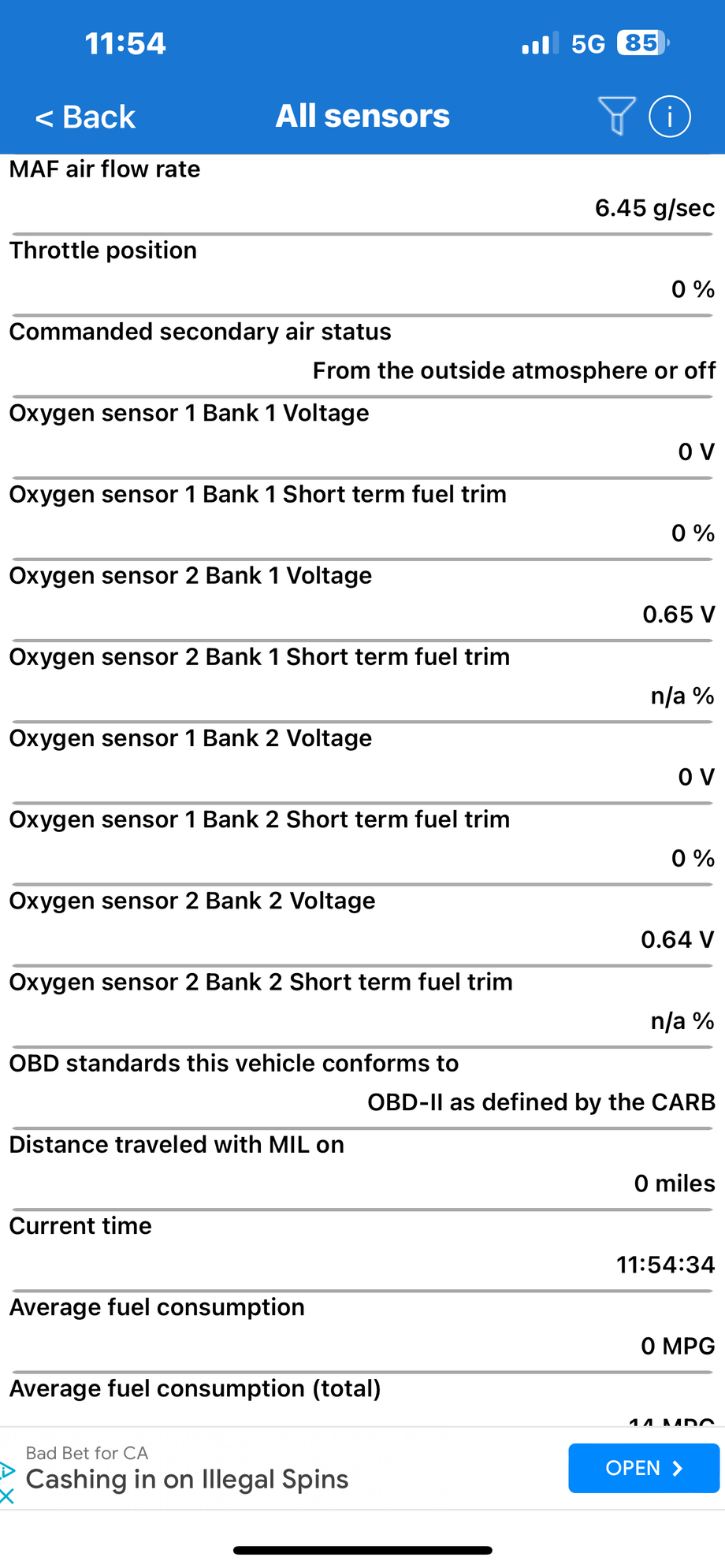

Hello everyone. I have been trying to tackle p0130 and pO150. I recently replaced all 4 sensors and my bank 2 side are both goo and operating fine. My oxygen sensor bank 1 upstream and downstream show zero volts. I first started by clean all the bank 1 connectors with electronic cleaner (since I did seen some oil in the connector prior to installing the new o2 sensors) the weird thing is when I disconnect the upstream o2 bank 1 sensor the downstream bank 1 sensor shows voltage?? But when I connect the upstream sensor back in the voltage drops to zero for both downstream and upstream bank 1 sensors. My next step was going to swap the upstream side to side and see if anything changes if that doesn’t work then maybe buy all 4 Bosch. Why do you guys think the voltage drops when I unplug the upstream sensor?

I swapped left from right and rulled out the o2 sensor works. When I swapped the passenger side to driver side the sensor was showing working. On the sensor 2 bank 1 and 2 were working. But the ones that worked for sensor 2 did not work on sensor 1 side (bank 1 and bank 2). I know if I unplug sensor 1 bank 1 then sensor 1 bank2 has voltage and shows working. I do not understand why sensor 1 bank 1 affects bank 2 when I have it plugged in it drops bank 2 voltage to zero. So right now even swapping side to side my sensor 1 bank 1 and 2 are both showing zero volts

You have a lean condition on that side, unplugging the front sensor sends it in to a mode where it uses rpm and MAF reading to fuel, not sensor input. Any other work done recently? Typically one bank only lean condition is leaking intake tract, usually loose intake manifold bolts or perhaps injector o-rings. Both are typically an idle only condition i.e. at highway speeds the sensor comes back on because enough air and fuel is being used that the leak is inconsequential. Also possible it is a partially plugged injector which can be tested by swapping all injectors left and right.
